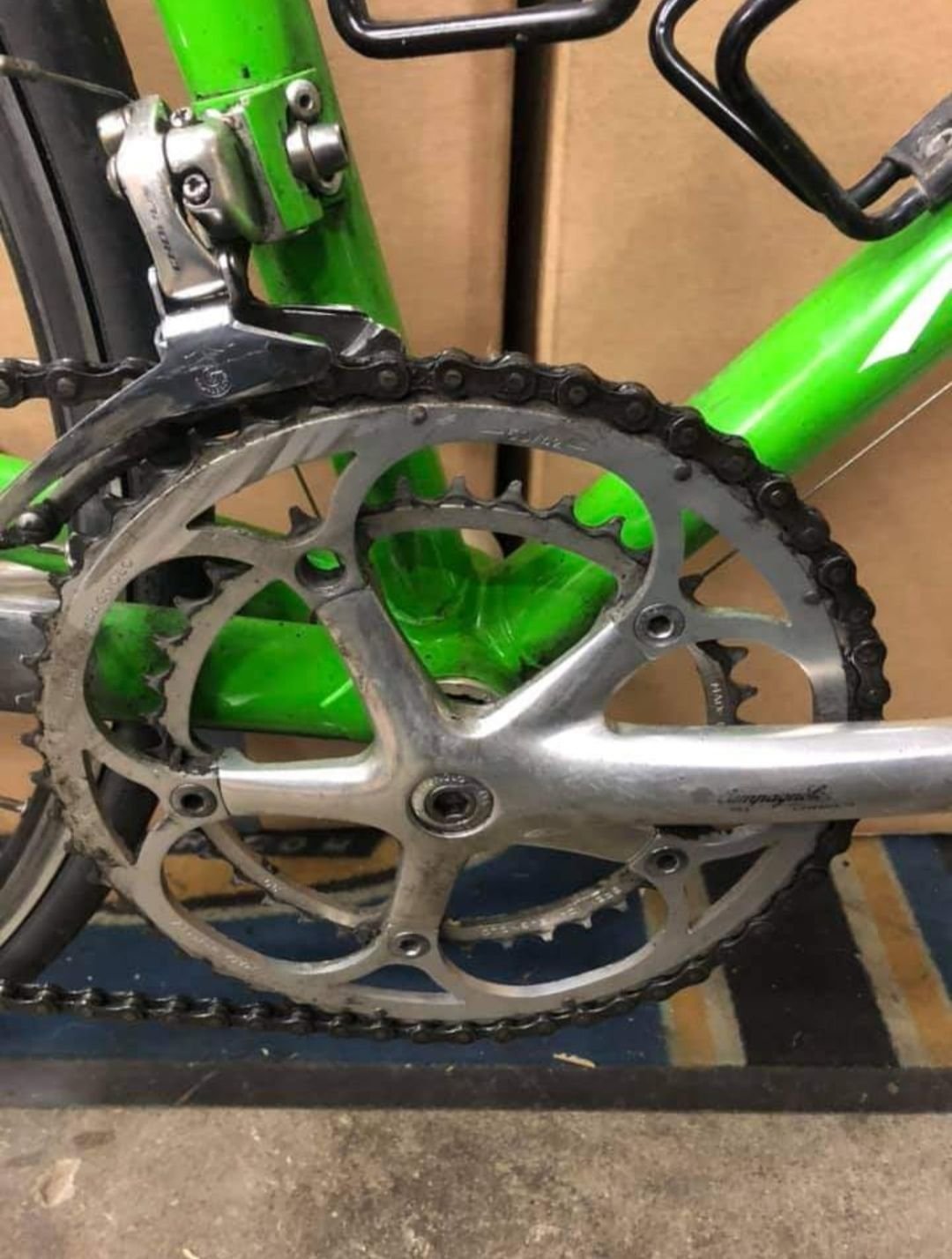

Thanks Jacek! I didn't even can read the F letter, thought its an L.
anyway, I found the front derailleur hanger a bit odd, i guess its repaired previously? If its repaired, would it be easy to braze the original fd hanger? Is it hard to find the hanger?

FD mounting is not factory EMC mount - similar solutions were used on alu frames.
If I had to find original FD mounting I would look for "wrecked" frame at scrap price - if shipping cost would not be high (by the way you could recover other parts and sell them - that would reduce costs).
I have never looked for original EMC frame parts
May I put forward an alternative theory? Given this frame has a number hanger, is it possible this was built with no braze on derailleur hanger? I know that at times certain team frames (TM) in this era ran a clamp on front derailleur. My theory is that the front derailleur mount was added later when it got it's green colours. Are there any markings on the opposite side of the bottom bracket shell, size, letter H maybe?
Seanaus is offline

FD with clamp was used - as it seems to me - only with ST 28,6 (SLX,TSX,753).
So far I have seen oversize tubes (and Mxl is besides ovalised) only with FD mounting - but your theory is possible (although not confirmable), just that a customer at EMC requested a frame without FD mounting and that's what he got
CyclesMakaron is offline
Yet again, fact wins over theory It did give me a good reason to find my MXL frameset and have a detailed look in that area. Even at that height above the bottom bracket it's still quite oval. As always, continuing thanks for your excellent work .
Thanks for your input. May I ask what team ran a clamp on FD with a green MXL?
I asked for another photo of the BB, though my eye can't see any letter on the left side. Probably you guys have better eye than me 😂
And this is the fd hanger. Looks fine though, the seller also informs it works perfectly. Might be an issue for purist, but I'll take this frame for the function and performance.
Anyway anyone here know if this green is a repaint? Found some similar paintjob with red and blue color, but never find this paintjob with green color
