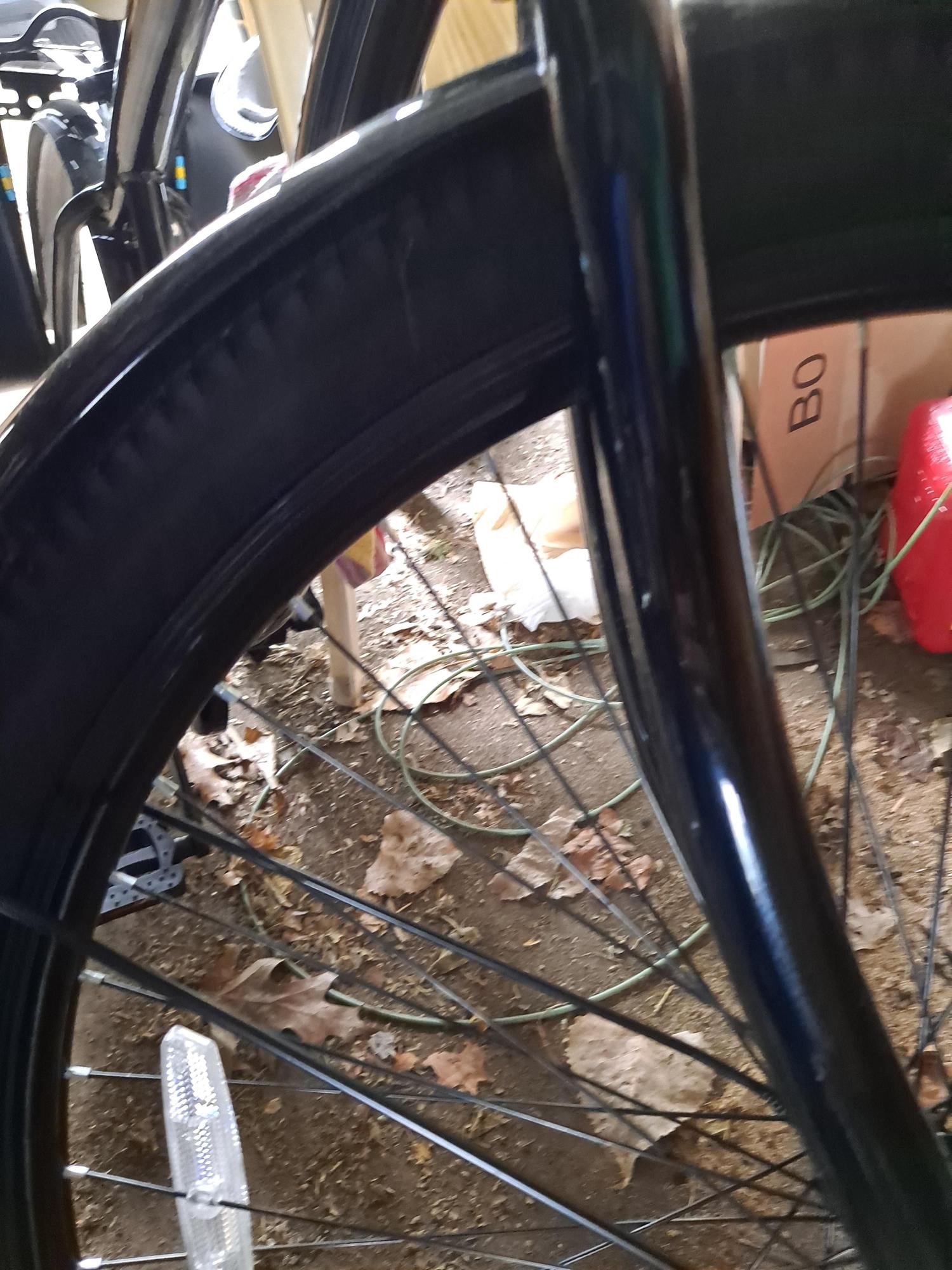

I have a 29 inch beach cruiser that only has coaster brakes. I have seen other people install a rim brake on the front wheel. I have no mechanical aptitude at all but I have a friend good at that kind of stuff so I am going to buy a kit and have him install it.
but.... I have no clue what to order. can anyone point me to a good quality kit on amazon or anywhere really that will fit my bike?
Here is the front fork
back

You first need to measure the vertical distance from the fork's bolt hole to the rim. That's called the "brake reach".
Then go search for a caliper brake that accommodates that amount of brake reach. Try searching "front brake for cruiser".

Will a brake bolt fit that hole, or it only for fenders?

Remove the fender and make a measurement with the wheel back in place. From the center of the fork crown mounting hole to the center of the rim braking surface. Try to make a vertical measurement to determine the distance as closely to the nearest millimeter as possible. That will become the brake "reach" with which you'll specify the dual pivot caliper size.
Tektro makes both and internally nutted calipers. This has to do with the length of the central fixing bolt, and whether or not the threaded nut extends within the rear-most hole in the fork with just a flange or shoulder remaining on the outside, or whether the nut is entirely on the outside. Once you make the measurement, then we can talk about the two types and which you'll be able to use.
If you have your friend bring his drill bit set, then he can tell you the nearest size bit that fits within the fork crown hole. We'll need to know that, too. PG
EDIT: Vertical refers to the plane on which the front face of the fork crown lies. This may be slanted forward along with the line of the fork, or it may be in line with the head tube. Align your measure to the head tube, and you'll be accurate enough.
This...and is it a strong enough mounting for brakes?

ok, it looks like it needs a 90mm reach. the bolt holding the fender is 10mm, and the tire is 54mm wide.
If anyone has a good quality kit to recommend i would appreciate it. I do not want to put cheap gear on it but I also do not want to spend more on the brakes than I paid for the bike!

This brake caliper, with a reach of 85-108mm, will most likely fit:
1080 extra long reach BMX cruiser bicycle brake caliper - BLACK

It's a unicrown fork on a cheap cruiser. I'd be VERY surprised if the metal in that area was insubstantial for any reason.

Where do you think a side pull bolts at? Yes that's the hole for the caliper, fender, and reflector. Outside of track bikes; it's probably the most standard of bike "standards" you can find on any bike in the last 40 years.

Originally Posted by Jax Rhapsody View Post
That brake is garbage and the distance between his wheel and fork crown will be no different than the distance of a 20" or 26" wheel, with the proper fork. The wheel size is different but the gap will be the same regardless.
OP don't get that ****** caliper, get a side pull for a BMX bike. It'll fit. Bikes that use, or are side pull capable typically use the same size caliper. The only exclusions to this are road bikes that use a smaller one for the narrower wheel and smaller gap between the wheel and fork crown. Go get a BMX side pull, it fits those, it fits my laJolla, it'll fit your Onyx, it'll fit one of those 30" Schwinn cruisers from the mid-00s.
Why is that brake caliper garbage? It looks like every other BMX side pull caliper, but with a longer reach.
Did you miss the part in this thread in which the OP measured the distance from their fork crown to braking surface?
No it doesn't, it looks like a brake you'd find on a roadster, like my old 60s Sears&Roebuck, or any other 27" or old schwinn style 26". Yes and the measurement doesn't matter. That's the tire and wheel an Onyx comes with. If he measured the distance on practically any non roadbike fork, they would be the same, or very close. Any side pull that'll fit a bmx fork will fit a cranbrook, or an Onyx, the wheelsize doesn't matter, they are all pretty much the same distance. The rim is a generic rim, the height of the section is typical box rim, the tires sidewall height is typical for the tire it is. Excluding the diameter of both; you're going to see the tire is no taller then the generic white wall or whatever tire you find on 26" and 20" walmart bikes, same for the wheel. Dealing with these generic bikes ain't rocket science
This is a bmx caliper, this is what I have on the front of my LaJolla, and any other rigid fork bike that didn't have cantis or vbrakes I've built. "Long reach" is usually a misnomer, those chintzy calipers and these are most likely the same size. These are going to be a stronger brake.
