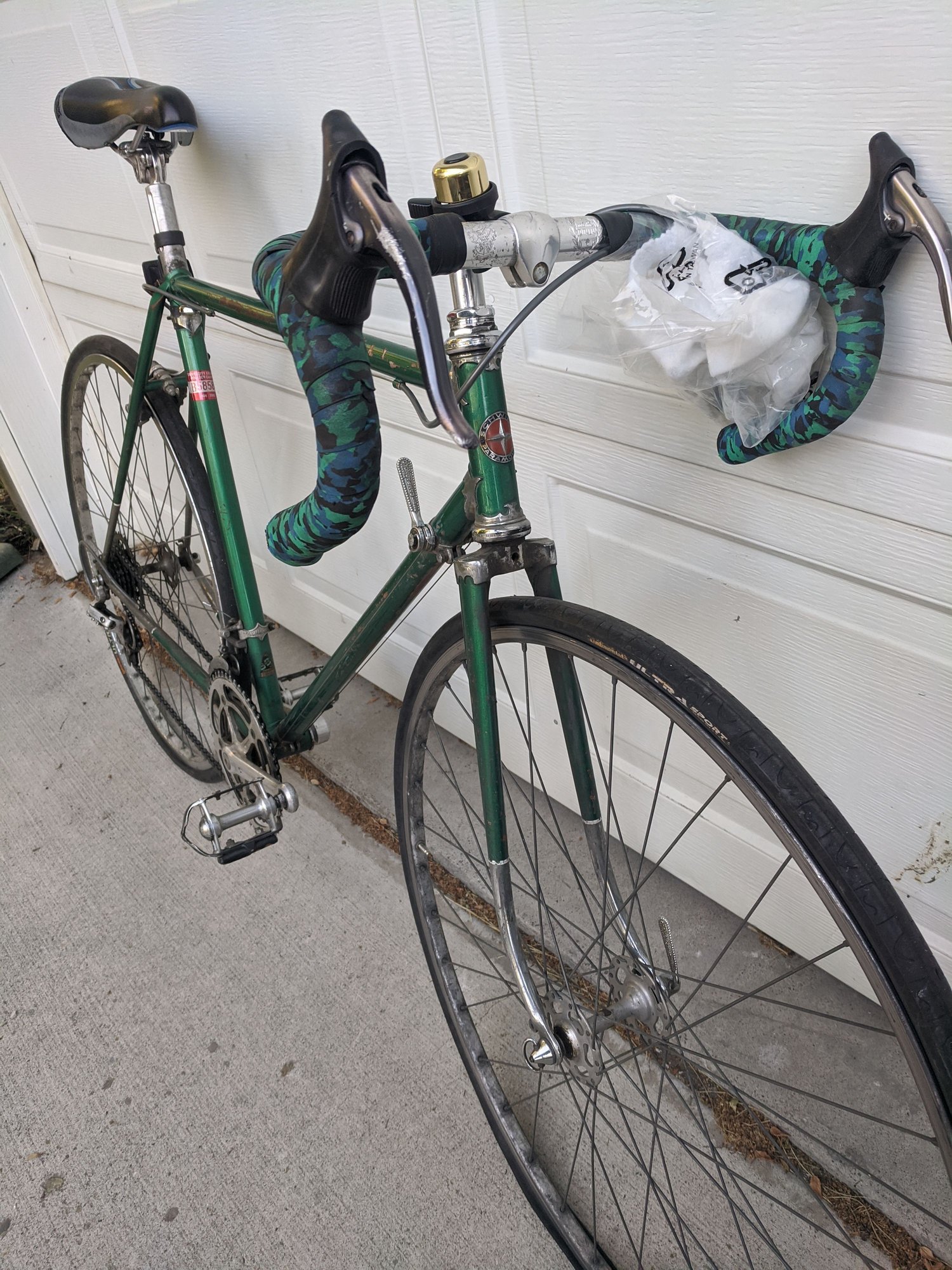

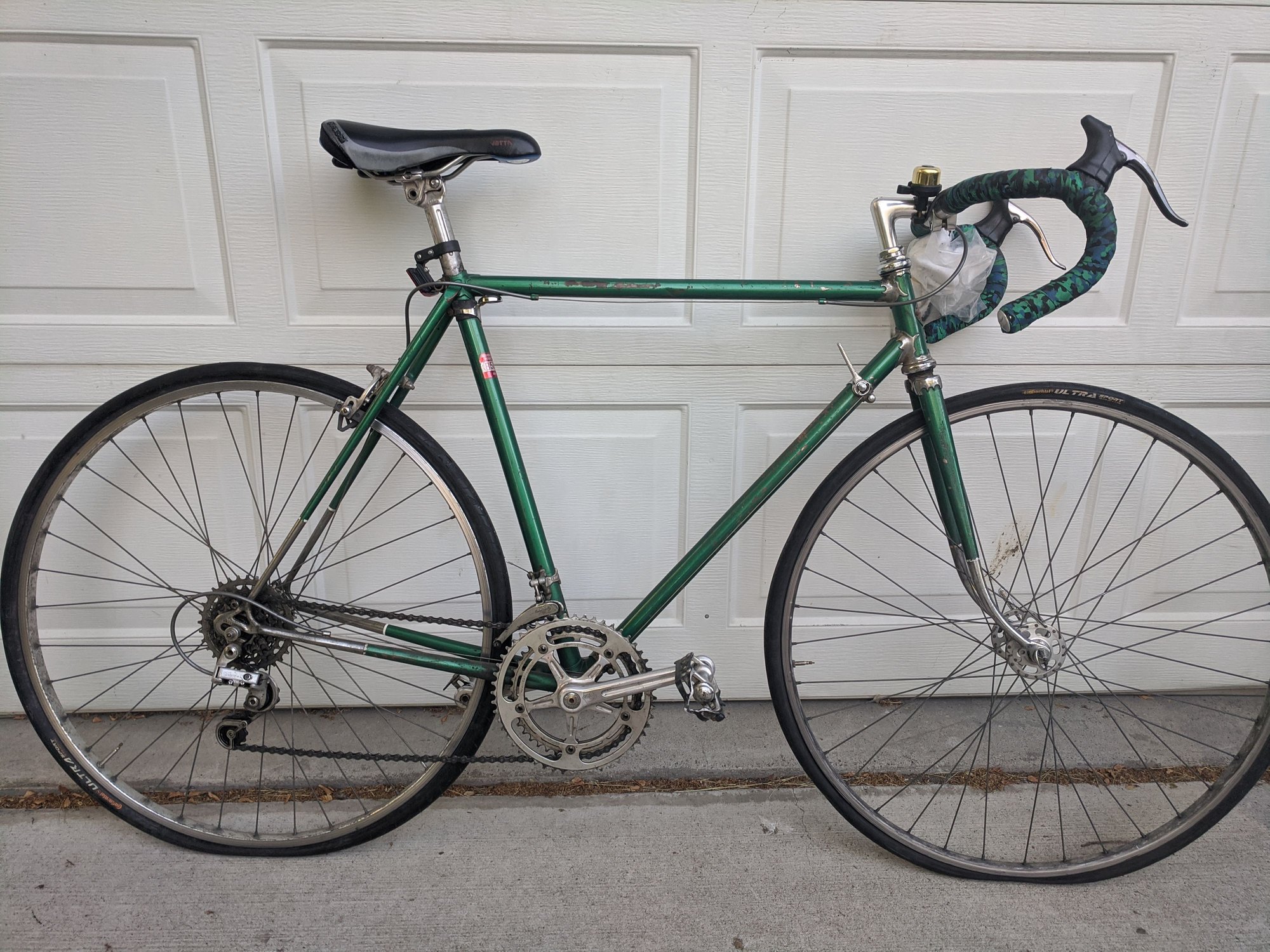

Hi, all. We see some crazy things come through our local bike collective, including this 1974 Schwinn Paramount. The shop manager identified the year via the serial number, which admittedly I could not find to provide at the time these photos were taken; I can add it as soon as possible. It appears to have most of the original parts, but the brake levers, brakes, and rear derailleur are non-original. To really make it gleam, the frame would likely need a repaint or powder coat and new decals. None of the rust appears too deep, and I'm hoping the chrome can clean up nicely. (Tips, anyone?)
I don't know much about the 1974 Paramounts. I'm not looking to flip the bike; I simply appreciate having beautiful and quality vintage bikes in the corral. It could simply end up as beautiful wall art. But just in case: yes, it is my size. For those of you more familiar with Paramounts, would you say that the cost of a repaint and tracking down the missing original parts be worth it for this particular year? I realize the subjectivity of this question, so before the snarky comments fly I'm just asking what you might do if this bike fell into your hands (for free, as it did me). Any additional information about the history of the build and specific parts spec would be appreciated as well. If I'm going all out on a restore, I want to be sure I'm tracking down exactly what I need. Thanks as always.

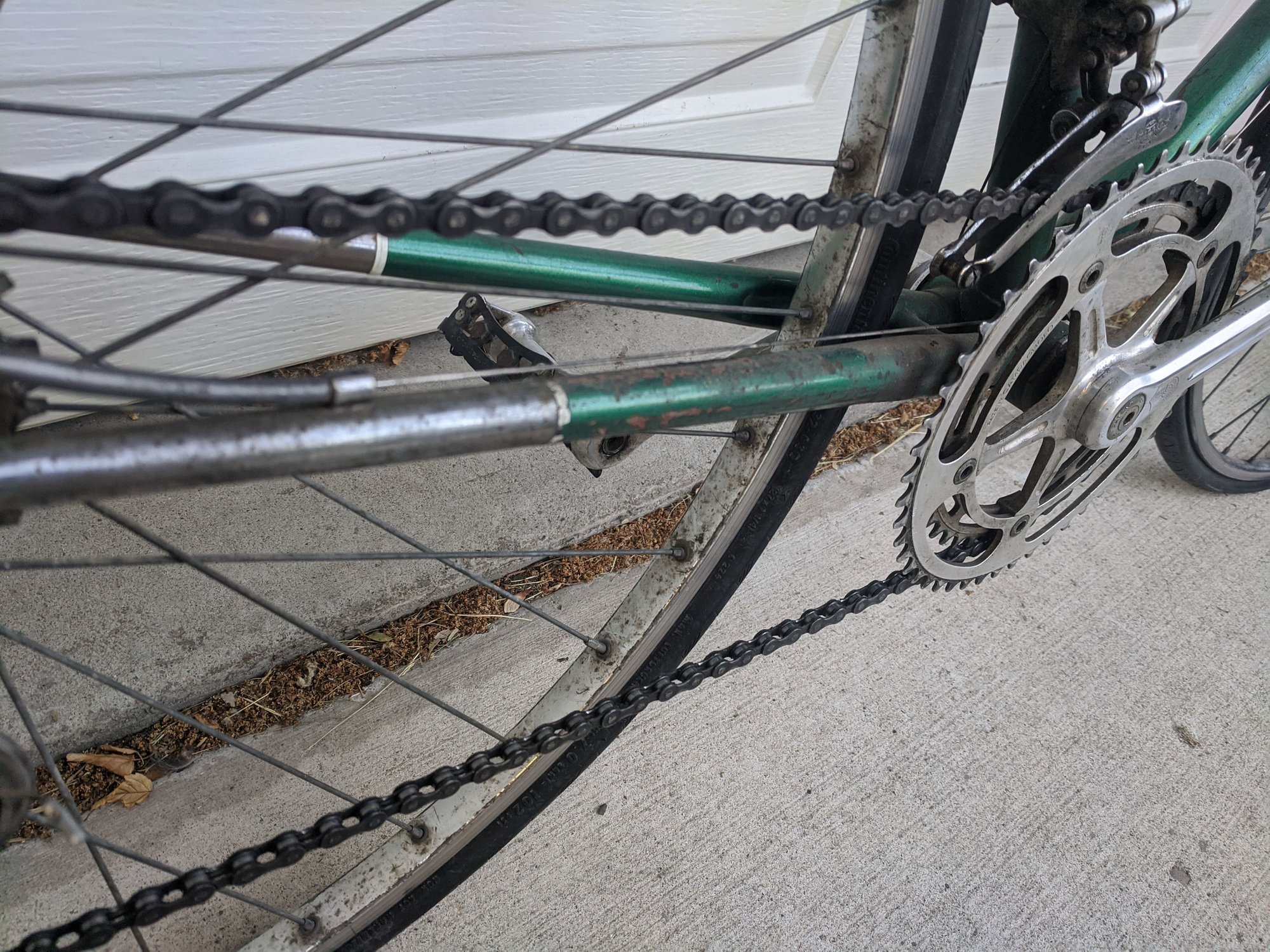

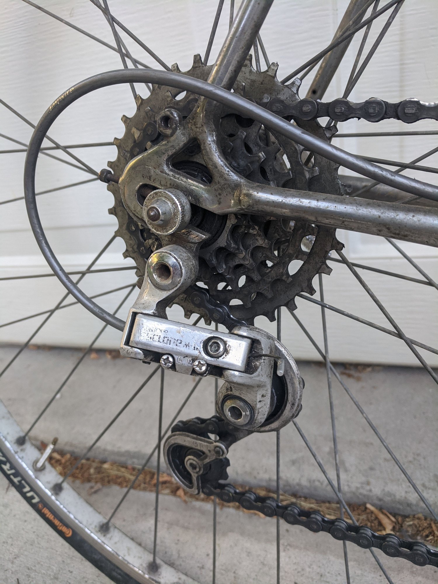

The largest rear sprocket is surprisingly large. I hope it shifts well. If it doesn't, I'd look for a different rear derailleur (if at all hilly) or a more corncobby freewheel (if not).
Maintenance as needed. I'd change the bar tape, but each to their taste. Congratulations on the bike; enjoy it!
(PS I'm not criticizing the RD. I have its brother on a Miyata, and I'm happy with it.)

"Worth it" is a very subjective measure. It was one of the outstanding bikes of the era, I'd be happy to have it and lavish attention on it.

Worth restoring? Sure.

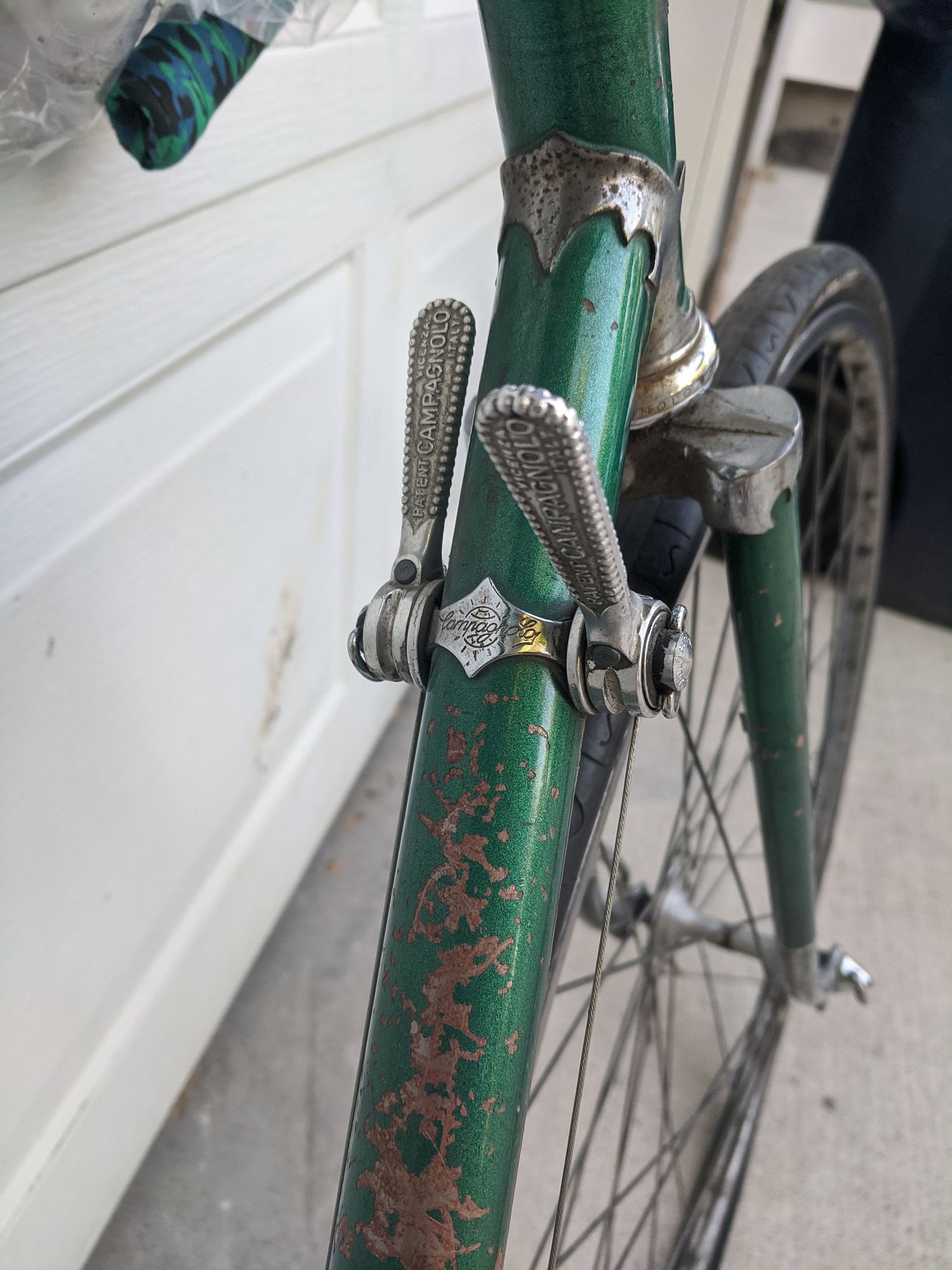

This bike doesn't need a repaint and a repaint in any case will likely hurt the value. The paint is largely in remarkably good shape.
You can deal with the light rust and just use clear nail polish to protect the frame. The rust on the chrome will be easy to deal with.
You don't need to buy expensive parts to finish the bike up. Weinmann center pulls would look right on that bike; you just need to measure the reach. Your co-op likely has those brakes lying around. Hoods can be found for old brake levers. The cyclone RD shifts better than a campy so leave it. A used leather saddle will be easy to source and look light years better than the ugly plastic saddle on the bike. Cloth tape is easy to find.
The bike needs to be overhauled and the consumables replaced. Evaporust is your friend for dealing with the rust. It comes in a liquid or a gel. I put the liquid in a bucket with a lid and use it for small parts. The gel is great for the frame or for parts that won't fit into the bucket.

That said, my only concern would be the downtube scratches, especially if you're in a humid environment. Clear nail polish might seal it up, if you don't go for a full repaint.
My vote: Weinmann Vainqueur 999 centerpulls front and rear, with reproduction hoods and modern cable housings, not to mention KoolStop pads.

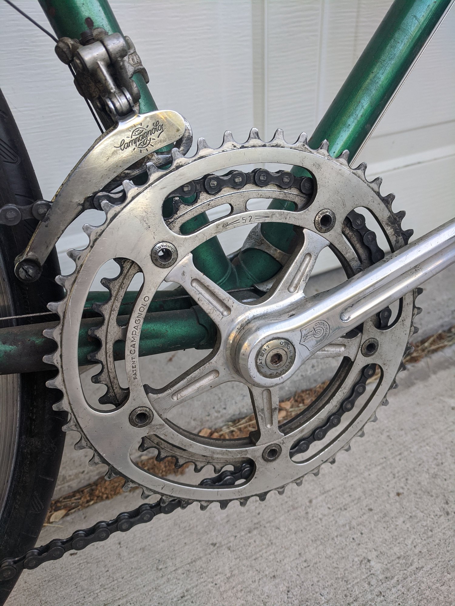

Keep the driveline as-is, or change sprocket and/or chainring sizes to taste.
If you are a toeclip-and-strap person, as I am, keep the pedals.
Touch up the paint.
Read the other responses -- lots of good advice in this thread.
Ride the hell out of it. That is a grail bike for many. (The longer I keep my mountain bike, the more I lust after a Paramount road bike.)
(Confession: I once passed up an opportunity to score an early 1970s 15-speed Paramount, same color, next smaller size. I help fix up donated bikes every year for a local charity to give to needy families, and someone donated said Paramount, which I dutifully greased, tuned, and otherwise prepped for some lucky recipient. I was sorely tempted to pull off the wheels and pop it into the trunk of my car in exchange for a cash donation to the cause.)

The RD you have is already better than the one it replaced and it's what's allowing that huge freewheel, which is a boon to anyone but a racer.

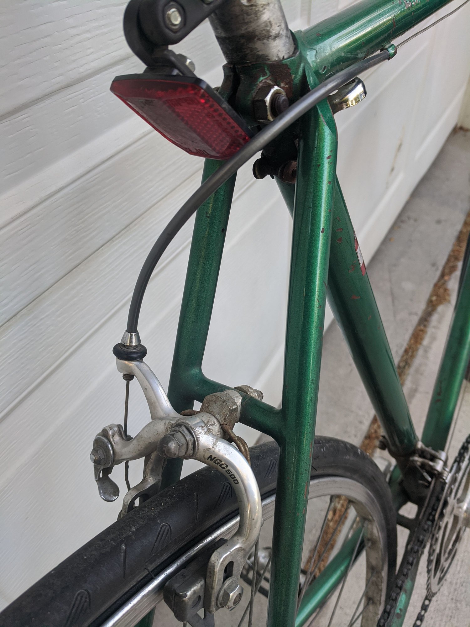

My 76 with Campy side pulls has almost no tire clearance at the brake bridge and this one has tons and a drop bracket, it must have been made for center pulls

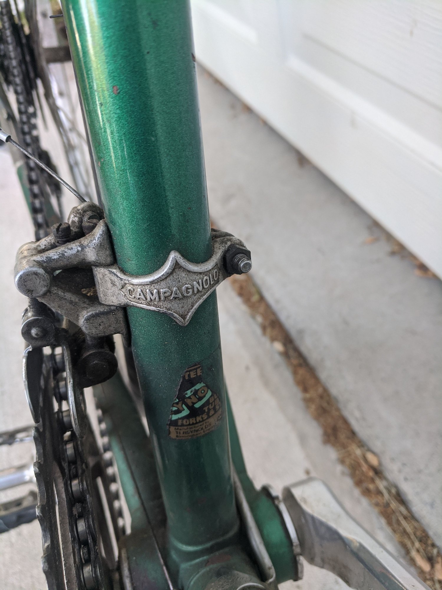

@ merziac,
Yes! The question is: What are you going to do with the $25 drop bolt for the rear brake? It would fit in with my collection of drop bolts! Smiles, MH
