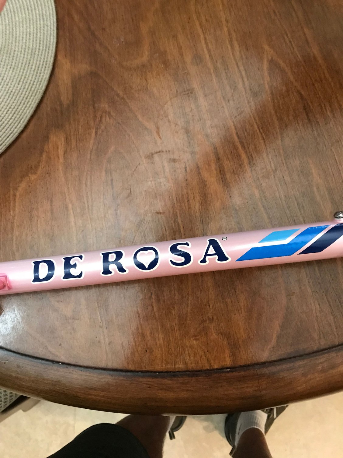

I love high end restomod bikes. If the frameset is cherry, a modern wheelset looks sexy.
frame is looking good, re chromed the fork and cleaned the frame. Only downside is that the pink paint is faded from years of travel and sitting on my balconies when I first came to the US. But the faded pink is actually pretty nice!

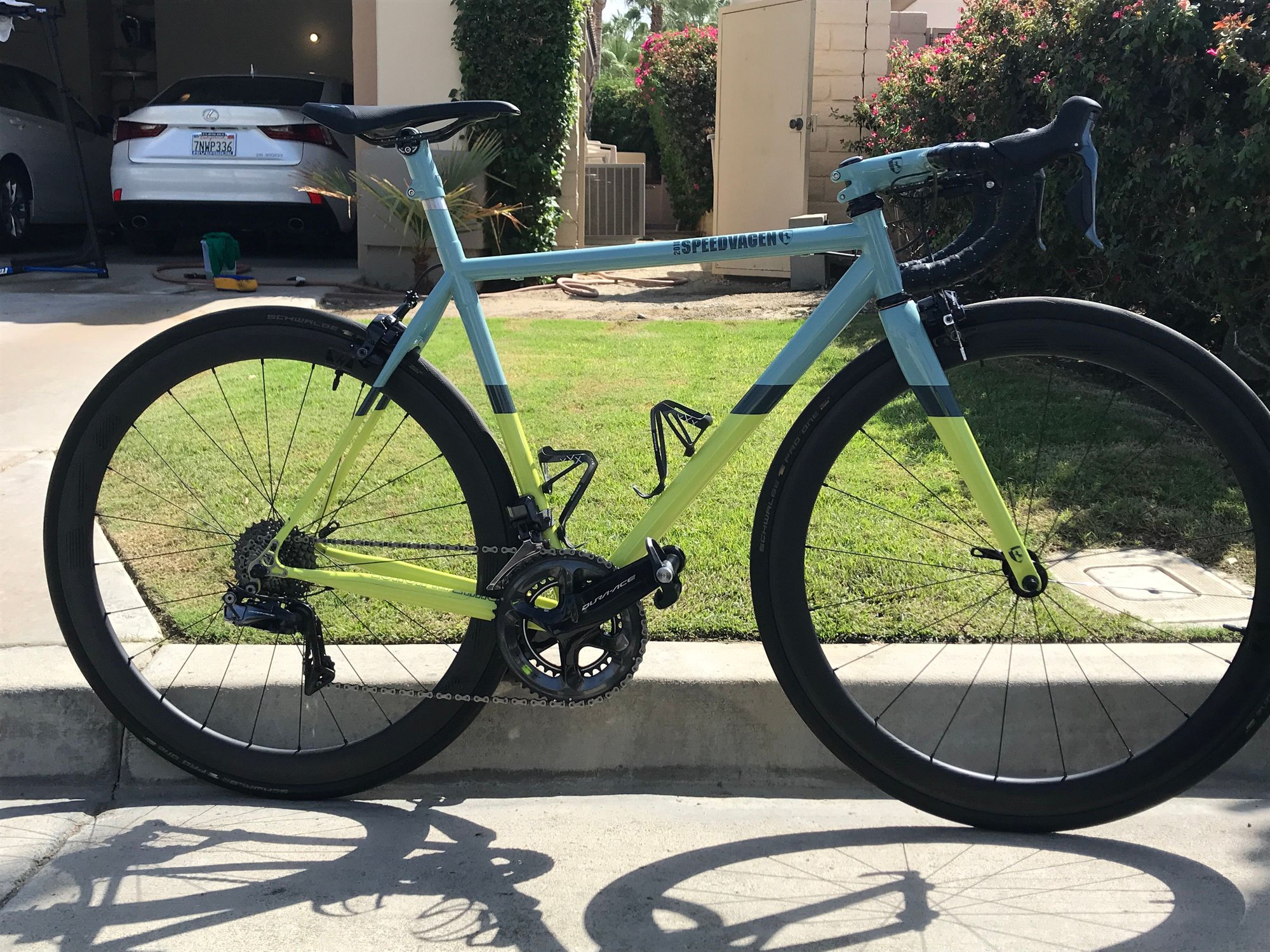

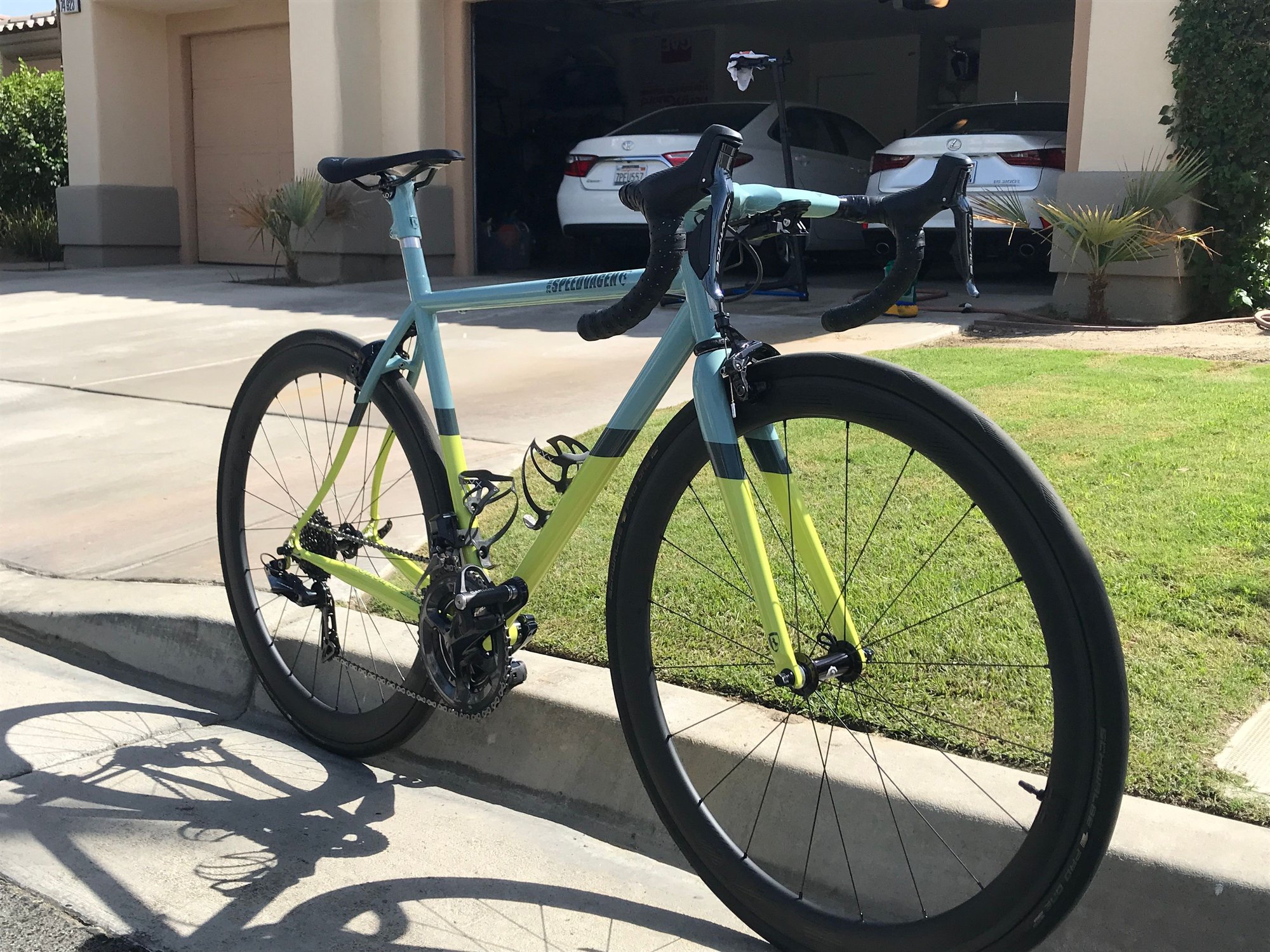

OP: You have a Speedvagen, and didn't post a photo in this thread? For shame!
it’s been posted in this forum quite a few times, I am quite proud of it and is my daily ride (and only ride other than when the deRosa is finished. Here you go!

Nice! I like that paint job.
thank you! Bike rides and handles incredibly well. I’ve had it for about 2.5yrs now, took a new riding friend on her first century a few weeks back, bike is as comfortable after 100 miles as it is on mile 10. I’d go so far as to say it’s as smooth as my previous Domane (although not quite lol)
