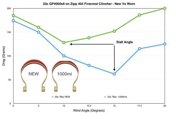

https://blog.silca.cc/part-5-tire-pr...d-aerodynamics
did you know that a worn tire can be a drag?

this site is also a fun read>

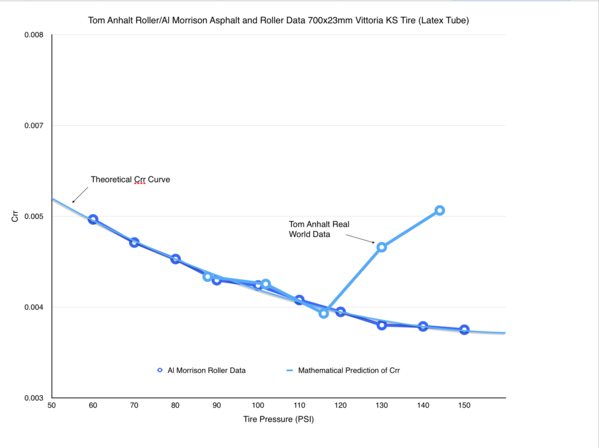

starting to understand how over inflation can actually slow you down,
as the tire becomes harder, your body starts to bounce around more, with rough pavement compounding the effect,
https://blog.silca.cc/part-4b-rollin...-and-impedance
"Impedance
Tom Anhalt was one of the first to take tires used in roller testing into the field to try and replicate data. What he found was quite a shock!
While the data matched at lower pressures, the real world data diverged somewhat dramatically from the roller data at higher pressures!
This divergence is the result of impedance losses overwhelming the system as the tire is over-inflated. Most interestingly, this initial test was done on 'good' asphalt, which really brings up questions about lower quality surfaces.
The new theory on Rolling Losses is that both Surface Impedance AND Casing Losses were adding together to create total rolling loss. "
"Impedance

no wonder they like the big tires and lower pressure at Paris Roubaix
"This theory predicts that below the Breakpoint pressure the system will be dominated by Casing Losses (though still affected by impedance) and at higher pressures the system will be dominated by Impedance Losses, though still affected by Casing Losses.'
