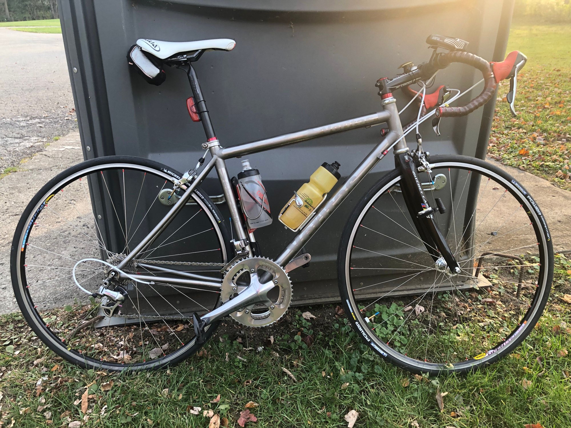

As promised, here is my Veritas titanium bike. I call it a “super compact” and I adapted this small bike for myself. I’m 5’11 and it is comfortable for me.

Very cool …… I have the same DA crank/rear DR on my Trek 2.3 as well as Michelins (power road and endurance) ….. I spent last night brushing Ti and am gonna work on my head set tool later today 😎

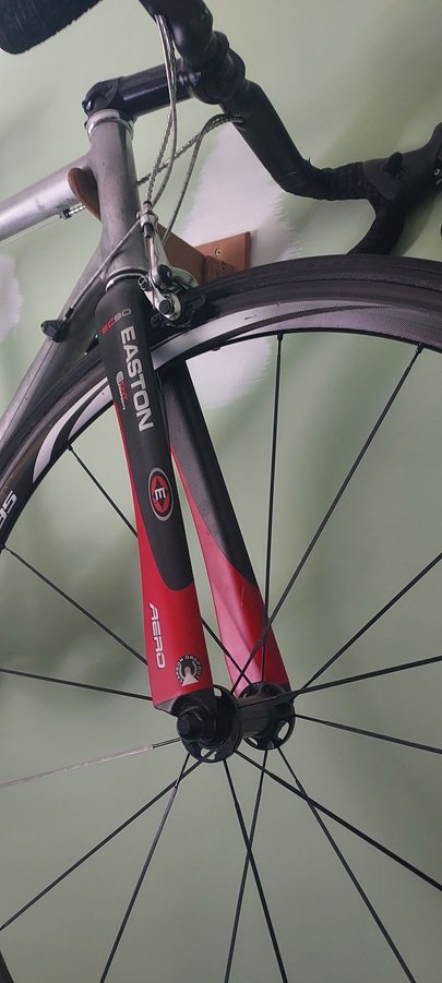

It's pretty thin on the ground for 1"... I paid au400 for that fork, used, close to ten years ago
