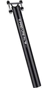

I think my Graftek may also benefit from a 25mm seatpost if I remember right.
A couple of thoughts.
You can purchase 25mm OD, 20mm ID tubes on E-Bay.
https://www.ebay.com/itm/142615908405
That gives you 2.5mm walls or so. If that isn't enough, get a 20mm OD, 16mm ID, and epoxy it inside the 25mm.
I'm not sure the minimum epoxy gap. You can sand the tubes down slightly if needed (a sanded surface would bond better anyway).
For your "mast", calculate the length of seat post above the seat tube. I'd cut the mast part as long as practical (even all the way down to sit on the seat tube clamp). If you epoxy the mast onto your post, that will maximize the contact area.
@Crankycrank found a couple of 25.4mm posts. You could also calculate the inner diameter of the post. Insert an internal strengthening sleeve. And, sand the post down to 25.0mm to fit your frame.
You mentioned a 30.25 mm ID "mast" as being too much of a gap to shim. You can purchase 30mm OD, 25mm ID tubes that could be used for a shim. Or, 30mm OD, 26mm ID.
https://www.ebay.com/itm/143536660123
Unfortunately I fear such a configuration would be a bit unwieldy.
Nothing is cheap, and I fear that ultimately you'll be spending as much on your hack as just purchasing the more expensive finished seatpost.
