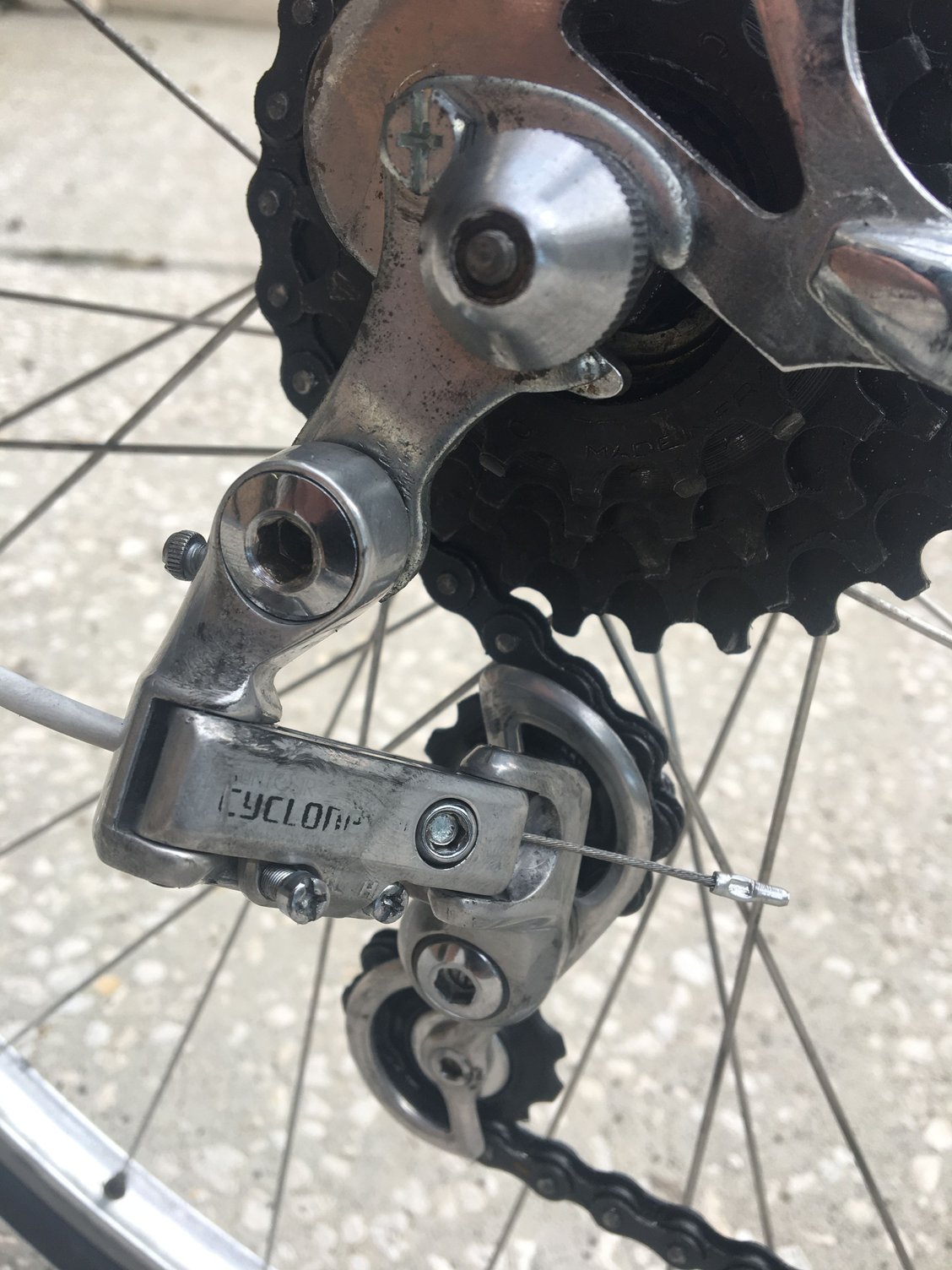

Your occasional auto-shifts may be due to the shifter. If it didn't get done during the service, you might try to tighten it up a bit with the plastic wingnut. Be carefull, though, because all that plastic Simplex stuff gets fragile with age. Also with those shifters, if you go to replace the cables, the lead head that fits into the shifter is smaller than on Shimanos -- maybe cables specified for Campagnolo shifters will be a better fit. I know that about 10 years when I was messing with those shifters on a Peugot there was a problem getting the lead into the shifter, but can't recall what I did about it.

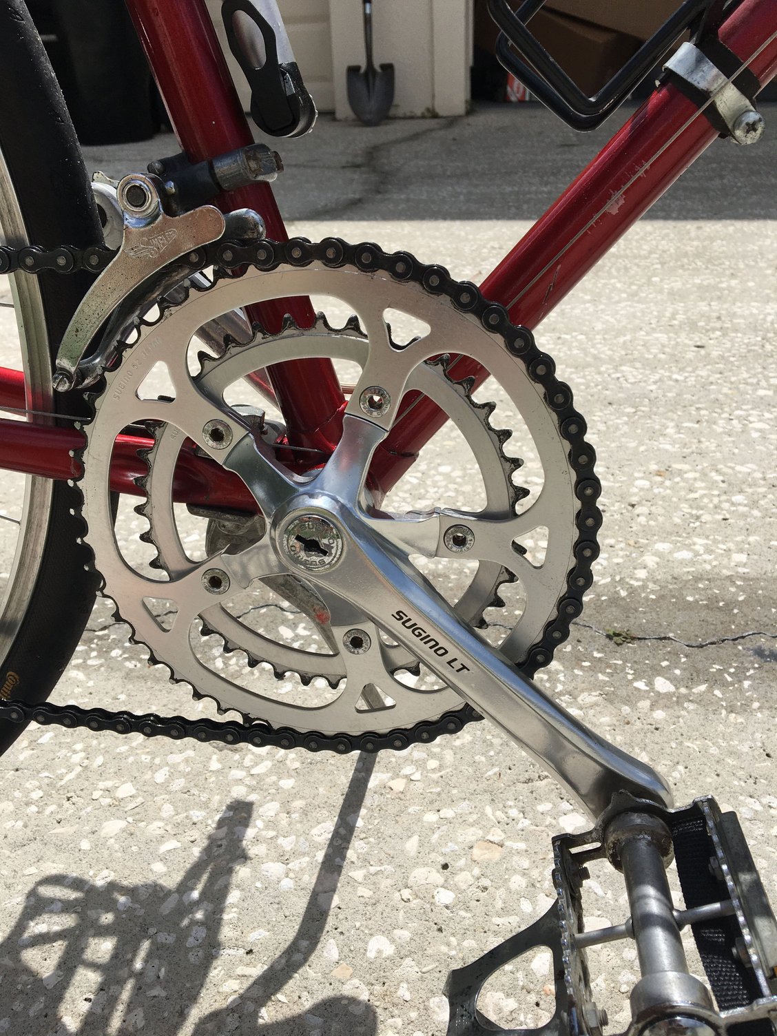

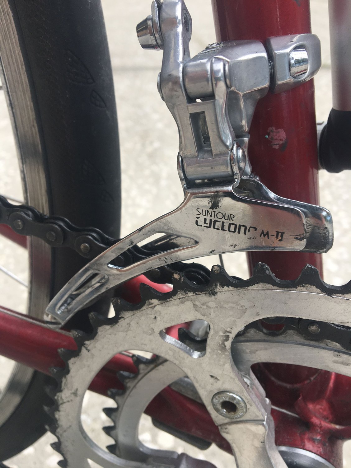

Well, I asked questions and got a lot of sage advice, which I listened to. I'm glad I did. I should mention that I think of my bike not as my vintage bike, but just as my bike. It's been my bike for 40 years. I only think of it as vintage when I come here. I did in fact replace the derailleurs with SunTour Cyclones, and I paired them with SunTour Power thumb shifters. It's like I have an all new bike, that's faster and shifts much better with no more skipped gears. It's like night and day!

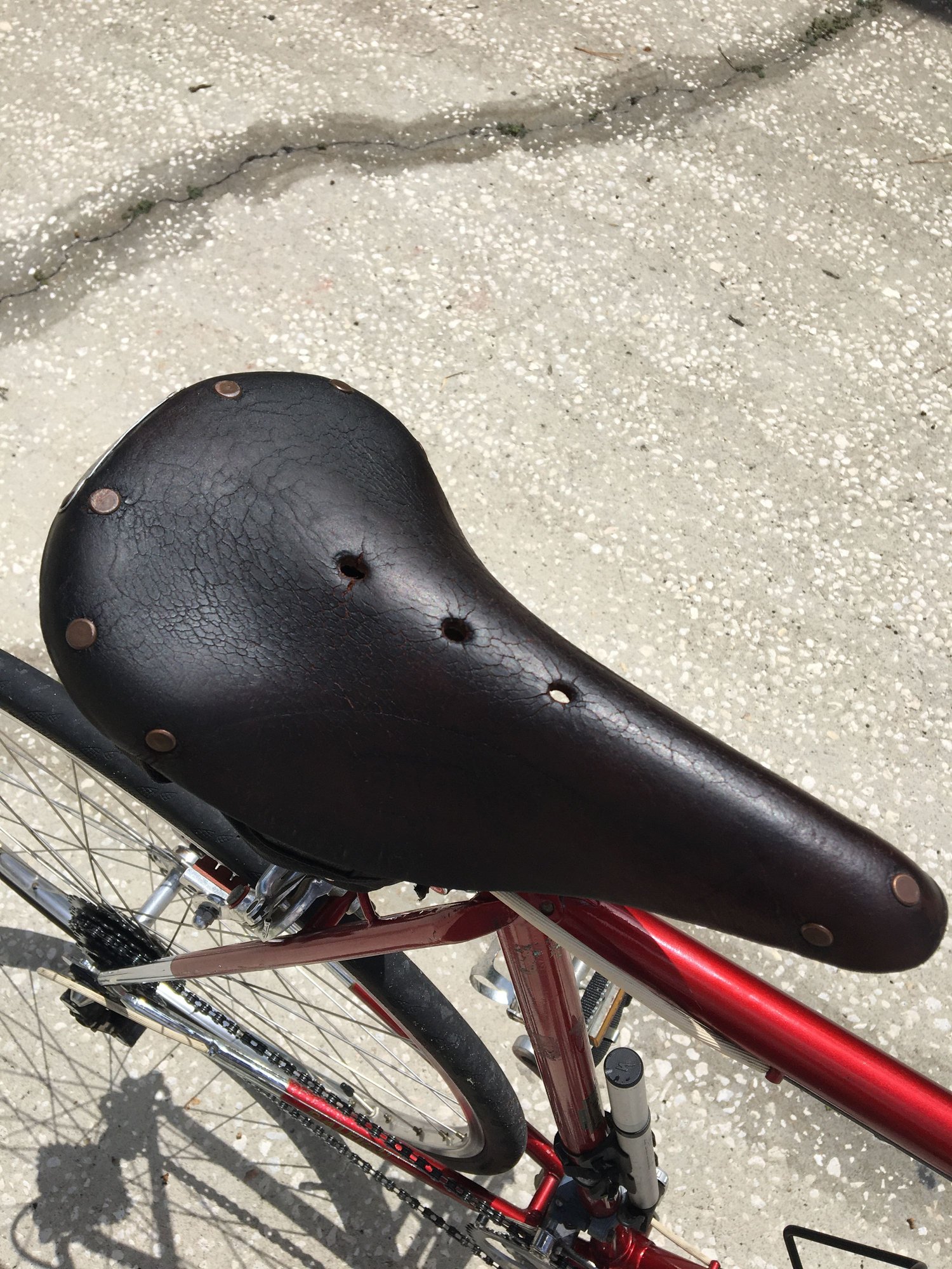

I don't know what kind of world we live in where you only get 40 years out of a saddle! When I find the receipt I'm asking Brooks LTD for a refund! Heh. I already ordered a new B17 and it's on it's way.

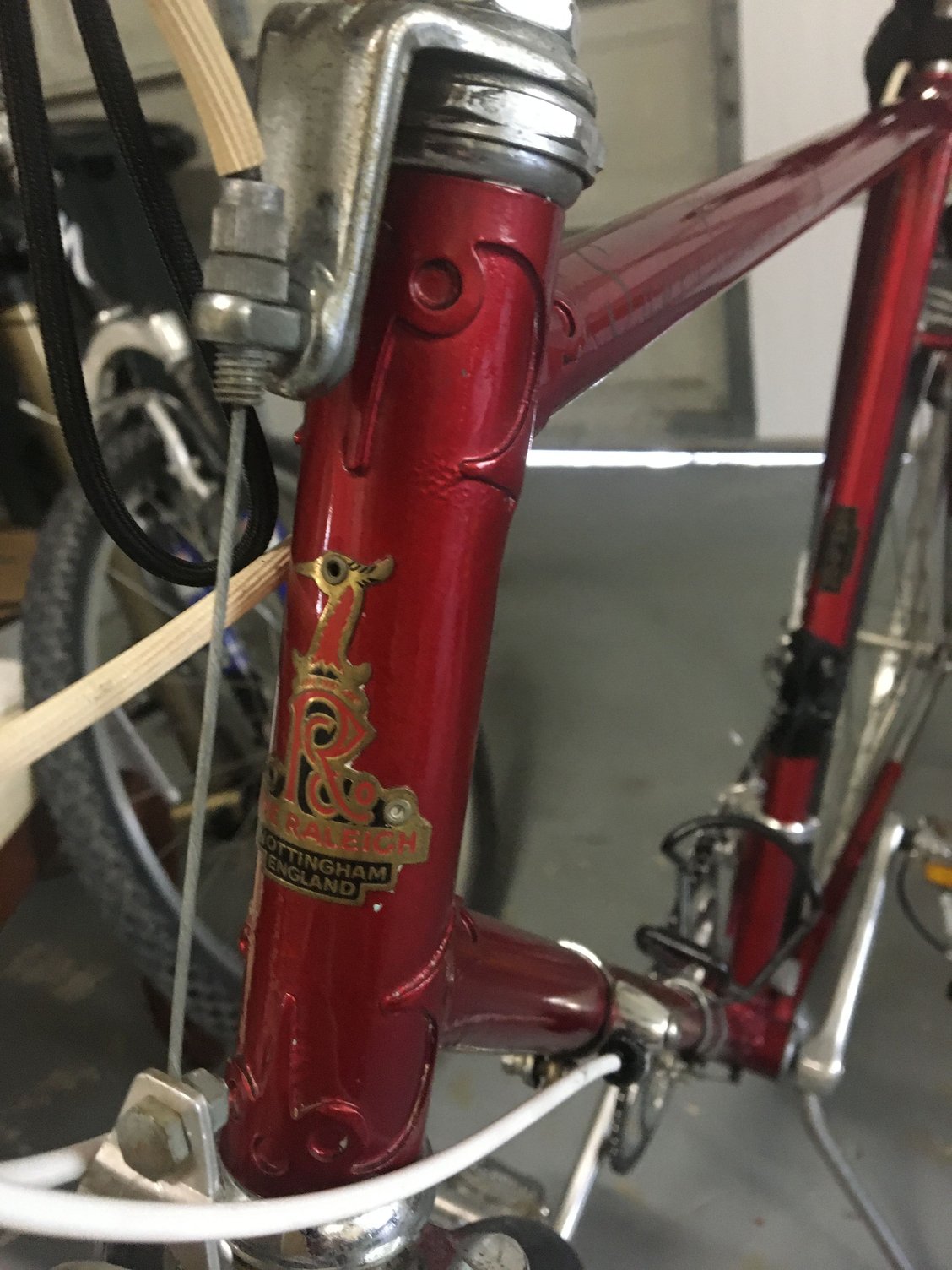

Yeah, the TT's are really rare. It's the original paint, which when I look up the color it says Brilliant Red, but when I got it in 1980 it came with some touch up paint called Royal Carmine. I got it new even though it was a 1973, but I figured the sew up tires scared a lot of people off. I switched the rims over after my first flat. You want a shot of the head tube from the front?

How did you deal with guiding the cable to the front derailleur? Your original Simplex has a stop for the housing, but the new cyclone does not.
