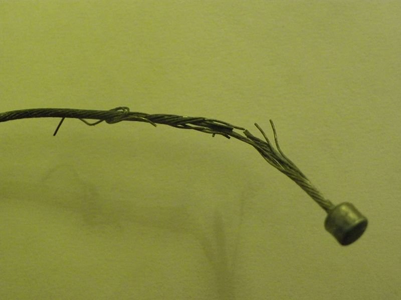

Just last week I had a cable fray inside my shifter. I noticed it shifting poorly on a short ride and checked it when I got home, so I caught it before it broke off in the shifter. It was down to four or five good strands. It's been most of a year since I looked at it, and it's been a busy year of cycling, lots of mountains and lots of shifting. I would have caught it earlier if I had checked it in the last month or two.
And that one was the one that convinced me to only buy stainless cables in the future. I did not like the looks of the corrosion on it.
