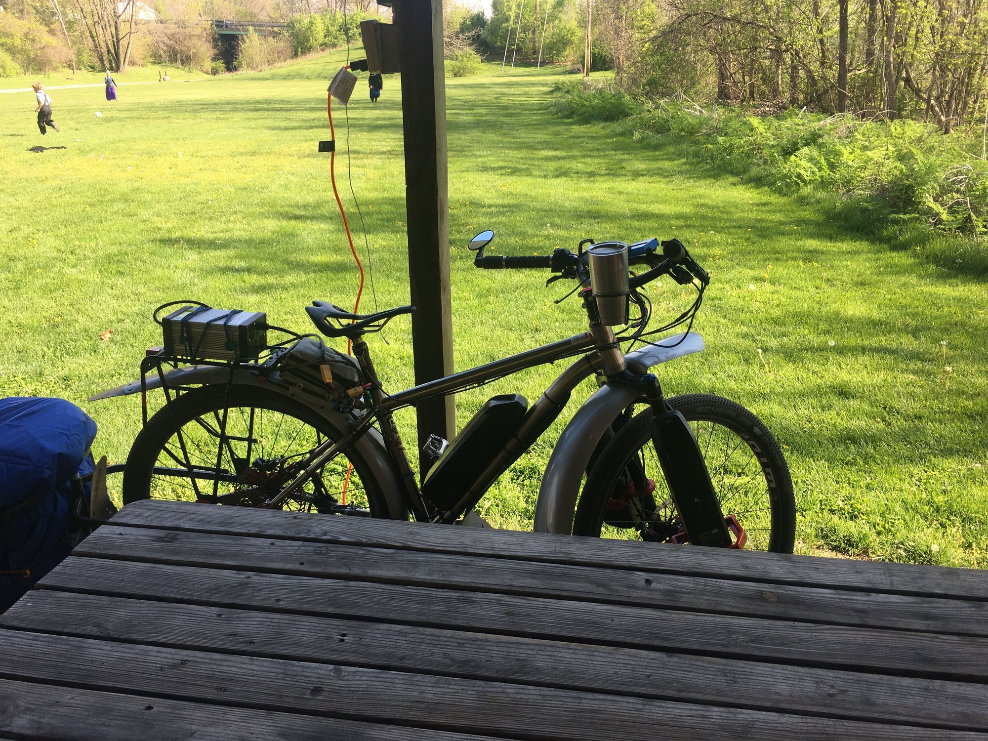

I currently run four batteries in parallel for long distance touring. I do not recommend doing this even though I do it.
I have done everything wrong and gotten away with it. I have since taken more measures to insure that I don't do stupid things accidently.
I have taken more measures to insure safety when charging. It would take too many words to describe everything you can do to increase safety. In the end though, the setup is not as safe as a single battery.
My total is 2,538 watt hours and I charge with a single 15 amp charger. Each battery is charged through it's own BMS
Why do I bother? Because I can and the range is greatly extended due to the lack of battery sag. I can in a pinch run decent power all the way down to the 20% remaining point with out having to seriously reduce power to get it. I have not needed to do that yet but I can. I can pull pretty significant power from the batteries when I am touring on dirt at 20 mph or so for long distances. My range is a good 10-15% higher than using the batteries separately.. The weight and bulk of the singe charger is better than the four chargers I would need to carry to duplicate the charge time.
Here I am charging all four batteries in a picnic pavilion while having lunch.

I'm curious.. what is the distance that you travel on your 4-battery e-bike regularly?
and how often do you repeat such ride distance? few times a week? few times a month?
I see a trailer getting pulled in the back, how much weight are you pulling with your 4-battery e-bike?
Terrain along your regular long distance ride, how much altitude change along the distance?

My fat e bike is set up for touring but I regularly ride it about 150-200 miles a week locally. 100 miles a day is fairly easy for me to ride and 150 is a stretch. To gawk, I normally shoot for 80 miles a day on touring.. With the four battery system I can travel at 18-22 mph. for 80-100 miles between charges. I have used as much as 4,000 watt hours in a single day with 2.5 hours of charging. on rough off road traveling at higher speeds.
In the photo above, I was the sag wagon, I had all of the camping gear, the food, the cooking stuff, the extra drinks and the cloths. The weight is 82 lbs for the bike, 200lb for me and the trailer is at 145lb. total is 425+lb
Vertical climbing can vary considerably from 500 to 10,000 feet per day. Grades regularly exceed 10% and rarely exceed 25%.
Deep snow and cold temps gives the lowest range. As low as 55 miles.
My change in attitude and what I will tackle has amazed me. The lack of range anxiety and rugged capability has made a huge difference in my fun factor

There is a commercial unit sold by Bolton e bikes that allows you to run 2 batteries at once. they can be different AH's but must both be the same voltage. Bolton claims the unit will increase overall range by taking power from each battery in small increments. The unit will not support the feature of direct drive motors that puts energy back to a battery when braking. Also it has XT 90 connectors so if your batteries use XT 60 like mine or Andersons you need adapters. I have purchased this unit and I'm waiting on Amazon to deliver the adapters from the XT 90 to the 60's. Once they arrive I will test it out and post up a report here if anyone is interested.

Dual Battery Parallel connector
DualBattery XT-90 to XT-60 Adapter Set
