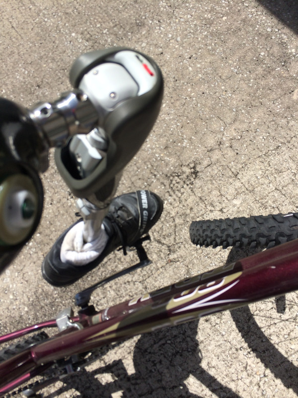

As an above knee amputee (left), I've been using a Power Grip band to keep my prosthetic on the pedal. Of course the one issue is that I cannot quickly remove my foot if I need to. Wondering if anyone has used them here and their experience with them. Thanks

I may try the mag lock pedals but it also requires two bolt cycling shoes which I will have to research and buy.
