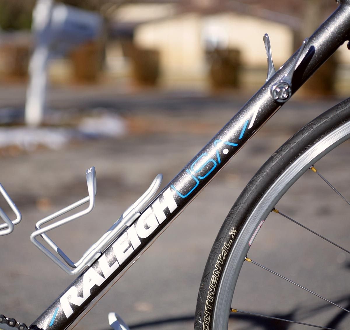

Took some decent snaps of the bike this morning. Haven't done anything major to it since picking it up other than cleaning and doing a light service. Yanked off a rear rack, swapped pedals, and put on bottle cages. Oh, and for now I threw on a Dura Ace/Mavic Open Pro wheelset I had around. Stock wheels seem fine but I want to open and service the hubs.
Bought it to be my annual contribution to a local bike coop but now thinking of keeping it and giving it parts worthy of the beautiful frame. Digging in the stash today I've got most of either a Suntour Superbe or Cyclone setup if I want to stick to DT parts. Or I've got a Shimano 105 7 speed setup, an Ultegra 10 speed or a Dura Ace 10 speed setup. I haven't measured the rear dropouts but I'm betting it's at least 128mm since the 130mm wheels pretty much just slid right in.
Rough setup with my usual fit.
The Exage parts mostly show very little wear
Some shoe rub on the crank is the most wear on the bike.
The worse comsmetic area of the bike is that "H" on the top tube.
The paint is really good for a bike around 30 years old.

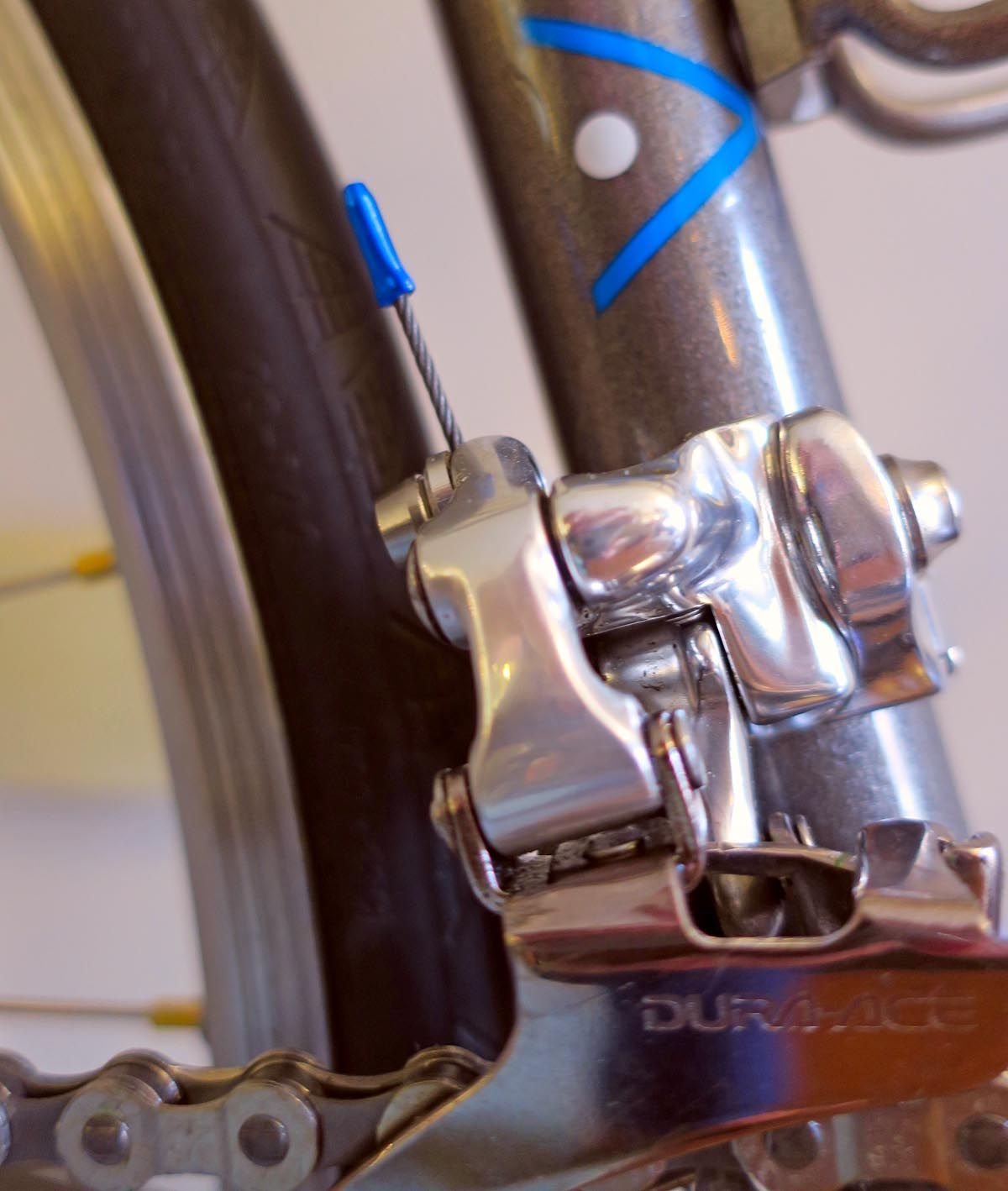

Friction and indexed shifting.
FD looks brand new too

Not happy with the operation of these calipers
Levers are pretty clean and the hoods are decent
The shape of these bars is better than other Sakae's I've had.
Pump peg, bonus!
Bonded aluminum/steel frame
Seat cluster
Rockin' the name!
Google says this shop is now closed.
Three main tubes are aluminum.
Steel is real...and comfy.

This frame is just gorgeous and certainly is calling for better parts in my opinion. I obviously don't see it like putting Dura Ace on a dime store Huffy. Although, that might be fun too, LOL!
Anyway, I did build it up yesterday using Ultegra STI shifters and 53/39 crank. The FR,RD, Brakes, and hubs are Dura Ace. The rims are Mavic Open Pros. I had to stick with the Sakae 25.8 seatpost for now and then wound up sticking with the Sakae 25.4 handlebars since the only silver stem I had in the right clamp size was a Sakae. The seatpost and stem are not light by any means. The 9 speed 12-26 cassette and chain are SRAM. The pedals are some used ISIS Keo style for now with an old Fizik Arione saddle on it. And then new gray Shimano housing and cables. It's weighing in right now at 20 lbs 12 ozs with the cables still needing a trim. Add in the additional weight of the bar tape still in it's box and this old beauty should build up to no more than 21 lbs even. So a 30 year old dang near mint frame that can be built up to that weight even with some fairly heavy parts seems more than deserving of the good parts.
Plus....in all honesty I very well may move this on to someone locally after enjoying it awhile. There's not many people wanting DT shifters these days other than us nuts, LOL!
Today I have to decide on the right saddle and then the bar tape color. Right now it's a blue saddle with a grey stripe. So do I try a grey bar tape or matching blue or white or black????
I also have a white Arione with a grey trim, a blue/black Arione, or a slew of other black saddles I could use including a super light CF Fizik Aliante saddle. I just don't think the clamp on the Seatpost will accomondate the oval rails on the Aliante.
plonz was the voice of reason on the full Dura Ace setup. Decided to keep that stashed with the NOS Ultegra Triple setup and NOS Ultegra 6800 groupset.
The smart choice on this may have been just using the rider quality 7 speed Shimano 105 setup I took off the KHS last winter.
Anyway.....here's how it's sitting right now this morning. I still need to tweak the FD a bit and then trim and finish off the cables. Then will come the deciding on which saddle and then what color bar tape. This morning I'm leaning towards the white/grey saddle and white bar tape.....

A few notes on this to to help others researching these. There is room in front for a nice fat 700 x 25 for sure and maybe even a 700 x 28. The back will take a 700 x 28 for sure.
The top tube pass through is one where it is not a solid tube running from front to back. The openings are pretty tight too. I left the old housing in and ran the new cable through. Then I pulled the old housing out and worked the new one through. Inside on the back opening it didnt' want to feed through ever with a clean cut. Then when I got to the front opening it probably took about 2-3 minutes of fiddling to get it to feed through that passage.
Then on this one I paid more attention as I took the 130mm rear wheel off and I really only spread the stays by maybe a mm or so, the wheel pretty much does just slip in. So I'm guessing these are set at 128mm although I did forget to get out the calipers to see.
I used a standard Hollowtech II BB and didn't have to fiddle around at all to get a decent chainline for this nine speed setup. I used the FD adaptor it came with since it seemed really light and polished up well. I got the FD adjusted with no real issues at all.
If I had a gripe it's being limited to the 25.8 seatpost. No real options for these now days other than a Kalloy it seems.
Oh, and when I had the fork off I didn't see any indication at all on it as to what tubing it might be. Nothing stamped in it at all that I could see.

Alright, I finally got this finished. To Bianchigirll , you were right about the blue bar tape. In my mind's eye I was seeing black with the blue black saddle. But with your comments and the overwhelming choice of blue on Steel is Real I went with it. Now if I pass this on it will probably go with the Blue/Grey Fizik but for me to ride it I prefer to try this saddle. Once it was all said and done the bike is still 20 lbs, 12 ozs. This is a lighter saddle and I still needed to trim cables and such when I last weighed it. So fully finished it's 4 lbs, 2 ozs lighter than it was when I bought it. That should make it feel better out on the road for sure. As usual, I wrapped the bars early in the morning while hopped up on several cups of coffee and rushed things a bit. I was also trying to beat another incoming storm so I could shoot so pictures of it finished up. Needless to say, shooting a grey bike against a snow background with temps in the 20s and snow/sleet falling means so not very good pictures. But they should give some idea about how nice this looks now.
Still need to decide if black, white, or grey Keo's look best.
I do like the blue and how the change rings match up decently to the frame
R3 saddle is light and comfy. Seatpost looks pretty good shined up. The cosmetic mess by the H is peeling decal. Not sure how to fix that since it's under clearcoat.
These bars seem shallower than other versions of these Sakae's that I've removed on other bikes
Tried to match the white and black with the finishing tape detail.
Pretty sharp looking ol' girl if I do say so.
Dura Ace smoothness
STI shifters are working well.
The cable housing reflections in the headtube give some idea as to how much this bike gleams. Hard to catch the shine in the pictures.
Plenty of room to run 700 x 28's on this.
Dura Ace smoothness

A few more:
9 Speed goodness
I like the decision to use grey housing.
And.....I forget to remove the tape I had on the non-drive chainstay. My reference point for saddle setback, LOL!
I think the bar tape matches the blue decals pretty well
Added a bit more blue detail
The view I'll get to enjoy out on the road.
I do like the chainrings on this one.
9 Speed goodness

Maybe....
