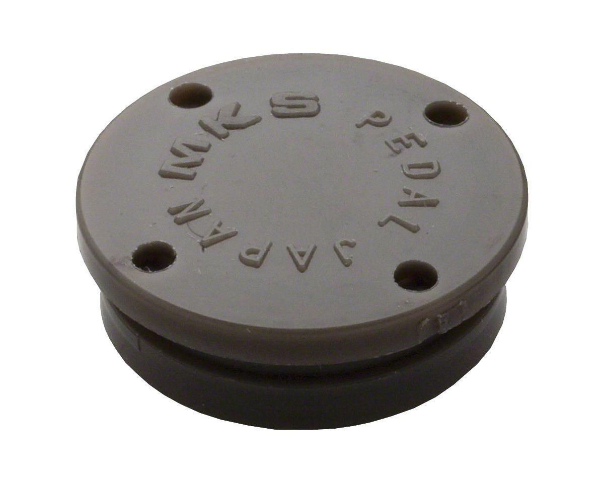

I find that pedals typically come from the factory skimpily lubed and too tightly adjusted; I always lube and adjust new pedals before putting them into service. I specifically only buy pedals which re easy to service; MKS are good in this repect, once you spring for the little dust cap tool.

Originally Posted by dsbrantjr View Post
MKS are good in this respect, once you spring for the little dust cap tool.
Just out of curiosity, is there a tool for removing the grey plastic dust caps on some MKS pedals, such as the AR2 EZY? I manage to get these off by prying, but it takes a toll on them eventually.
This dust cap *looks* like it ought to have a tool to remove it. Does such a tool exist?
