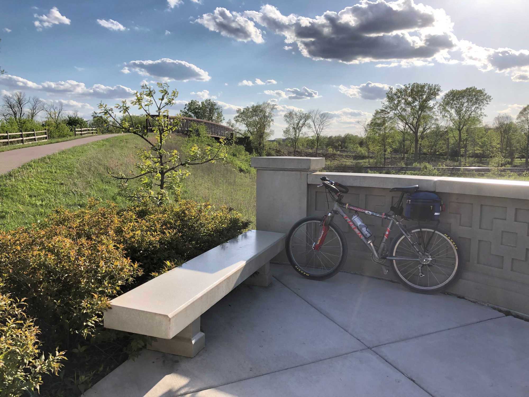

Here's my Trek 6000, bought in the year 2000, with many thousands of miles on it under a rider a bit over 200 pounds. Frame has held up well.
22-year-old Trek 6000
