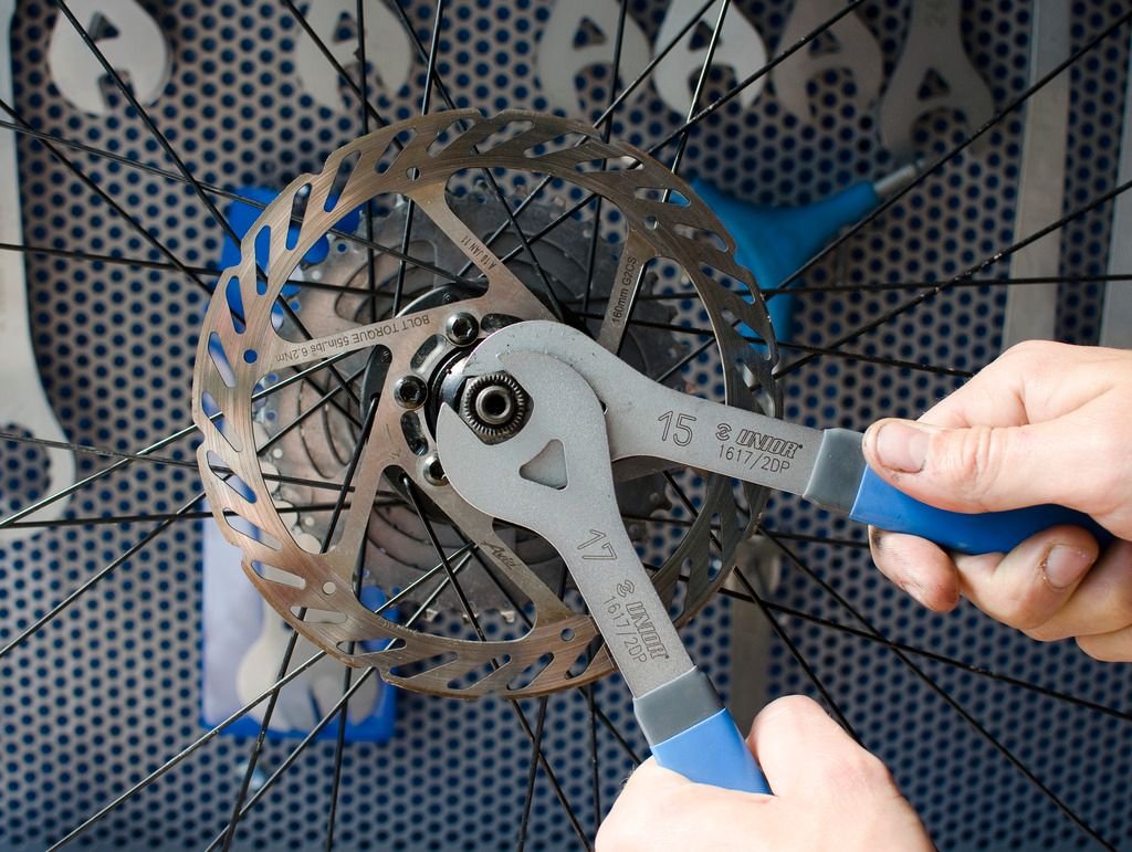

Here's a possible exception. Nexus hubs have a 17mm nut on the non-drive side, which is amenable to a normal ("thick") wrench especially with the wheel out of the frame. However, with a roller brake module in place, and the wheel in the frame, only a cone wrench will fit. The nut has to be tightened *after* the brake module's torque link is attached to the chainstay, which has to be done after the wheel is positioned for proper chain tension. I suppose the nut could be left a bit loose, as it's not actually locking the NDS cone, but I like it to be tight. A 17mm Park wrench is ideal for this.

look at my post #9. on my wheel you need a thin wrench to hold the bottom nut in place so you can loosen the top nut. It will spin freely other wise.
kind of like this
That's an example of what was mentioned earlier in the thread - while a cone wrench is needed for the cone, a box wrench, or even an adjustable wrench, would work fine for the lock nut.
kind of like this
Which would be MUCH better served with a standard 17mm box wrench.
Less likely to slip off.

No, I only know what you wrote. And in post #12, all you wrote about locknuts is that "most (it seems) lock nuts are 17mm. Since the lock nut is on the end, you don't need a thin wrench. (with the wheel removed)." The Campagnolo Record hubs I referenced above use a 14mm cone wrench for both the cone and the locknut. The flats on the locknut are too narrow to accept anything else. Other high-end hubs are similar.
