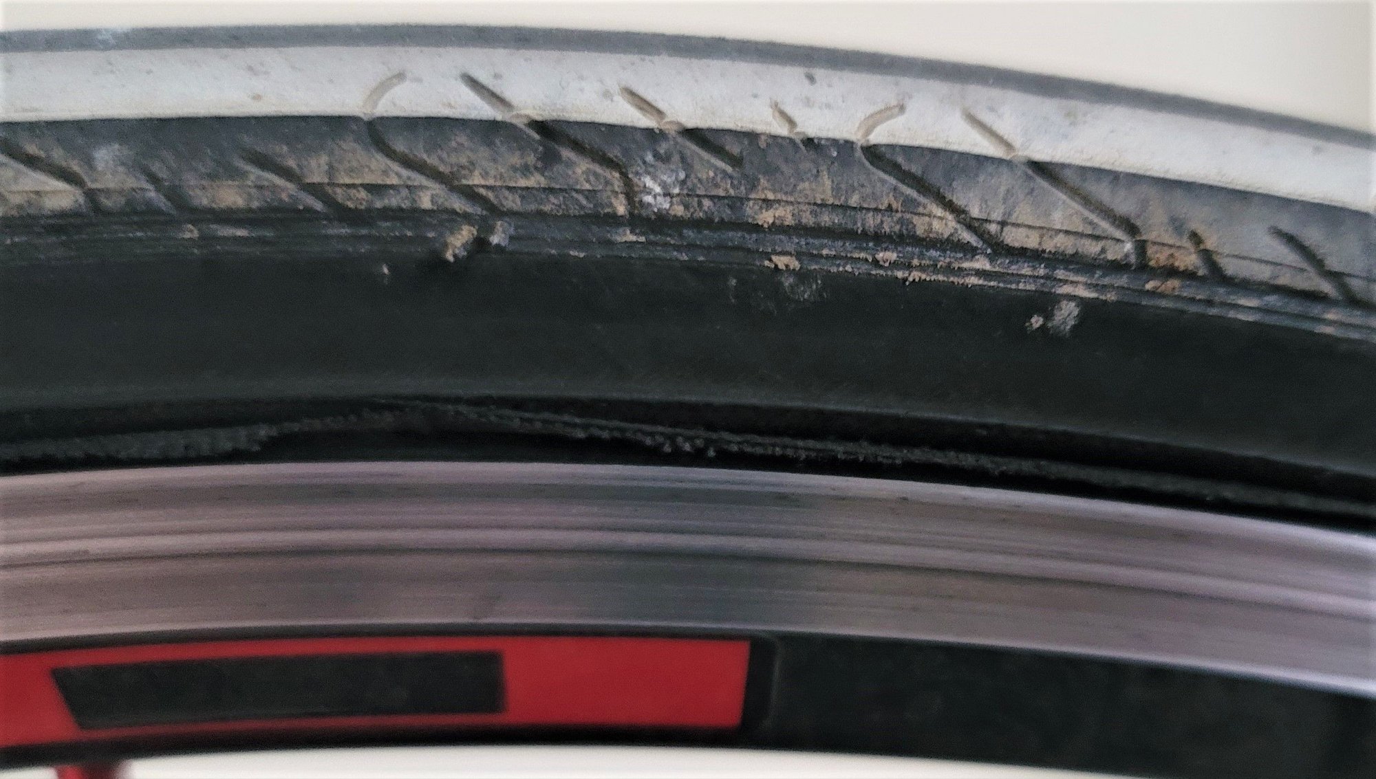

Just put Pirelli Velos on my bike 2 days ago. I’ve put 20 miles on them…and am really liking them so far
