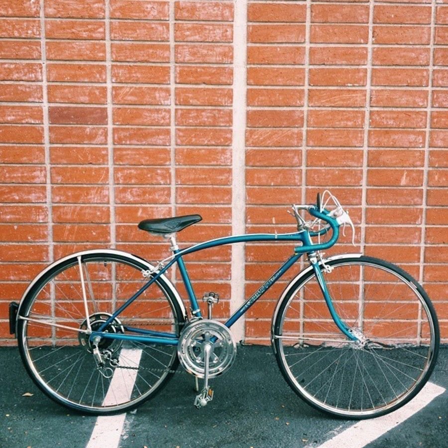

Seller Assures Me That This Raleigh Pro is NOT Bent...
The last time I commented on an Ebay seller, I got my butt kicked here. Cannot say that I enjoyed that much but I did learn a thing or two about myself. Sadly, perhaps not enough learning because I feel the need to comment on this situation.
The above Raleigh Professional is offered on Ebay. The frame looks to be bent, to me, and I sent a message, to the seller, asking if it was bent. The seller responded, promptly I might add, by writing...
"No the frame in the front is curved, that's how the bike was built".
The seller has zero feedback and I cannot help but think that he, or she, might not really believe that the frame is compromised. I am also wondering why he or she thinks the bike is a Professional.
What do you think? Is this a Raleigh Professional and were road bikes ever made this way? I am thinking nope to both questions.

It certainly looks bent to me, and no, it's not a "Professional" model.
Couldn't even be bothered to pump up the tires for the picture.

Very rare. Raleigh Capri with Stayer geometry.

The seller is incorrect.

I've ever seen a Raleigh Pro with stamped dropouts and safety tab holes on the fork, let alone steel rims, nutted axles, brake safety levers, stem mounted shift levers, etc. It looks like a mid-1980s, entry level Raleigh Sportif to me. Ans that frame is definitely bent in the top and down tubes, just behind the head tube. Whatcha trying to pull, Randy? It's not April 1.

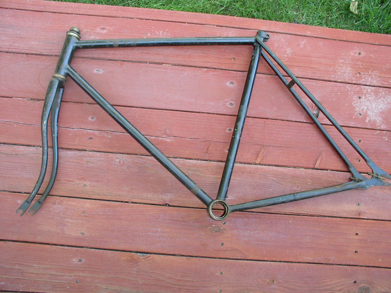

...this picture from another thread, but I had a kid come in with a fork bent just like this at the bike co-op when I was still working Saturdays. He had had it, and the frame he wanted to use it on, freshly powdercoated, and he wanted me to help him fit the fork to the frame (not the original fork), so he could make a fixie out of it. The fork needed the race milled, and to be rethreaded a few inches, then shortened. I tried to explain that it was so bent that I was not comfortable straightening it, and that I was sorry about the powdercoat expense, but he really needed to find another fork. Couldn't be done. He insisted it was a custom fork, he liked the curves, and everything was fine...I was mistaken.
IIRC, he finally badgered that day's manager into doing those operations for him. I had moved on by then.
About a month later he came back in to post an image of the finished fixie, which had been stolen from a bike rack out in front of one of the local brew pubs. He really wanted to get it back, with the custom fork and all, because he liked the way it rides. So there you go.

Frame is bent to be sure! It’s smashed pretty hard. The bike is a lower end model called “Sportif” and not a Professional. I’ve had a couple of Sportif bikes come through my hands and they are not built this way. I own two Professionals, an MKIV and an MKV, they’re not built this way either. The top tube even says “Sportif”. It’s also a Taiwan built Raleigh Raleigh USA model and not a made in Worksop England bike so it’s really not even from the same company.

Obviously not a Pro and obviously bent. Zero feedback?. Nothing to discuss.

Not a Professional. Not a 'bent. Obviously IS bent.
If someone buys it from him based on the listing and his response that it isn't bent, e-Bay (the company) will not be kind to him. If anyone is interested in a donor bike that's bound to eventually only cost you the hassle of getting your money refunded...

Let’s be charitable and assume the seller is referring to the fork rake. His response assumes you know less about bikes than he does. Asking if the frame is bent is different than asking if the top tube is bent. Asking about the top tube may yield a different response. Of course this assumes the seller knows what a top tube is.

Yeah, this belongs in the Wacky thread. There's text that says Sportif right on the top tube. A seller that's lying about the model is one that will respond to your concerns about frame damage saying it's built that way. At the end of the day, it's a very poor scam by a very dumb seller and it can only work if they find someone dumber to buy the thing no questions asked. It's best not to engage directly with these people because their answers will only make you angrier, and nobody really needs that.
