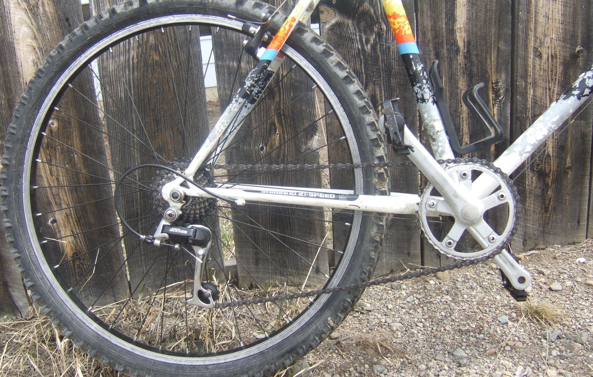

Today for right about budget 1987/88 Motive Stone Grinder MTB done to a state where I can make the 100 miles. 50$ for my start pile $40 for cheap used tires and pathed tubes a junk crank set with stuck pedals and $15 for a used Deore Thumb shifter for a total of $105 all salvage got for free out of my death pile bins and only 22 cents for a washer out of pocket cash spent for total of $105.22. So no more budget so just done to riding now got 30 miles in should be able to do another 70 easy with maybe a big ride push to the top of 13,000 trail road a couple of epic rides with andgreat pics is the only way this boring so-so pig will stand a chance of being well do good in this. For the record this bike has a serial number of D10804131 and is Branded Motive with 4130 chr-mo frame and High Ten fork.

Got the first real long ride in on my challenge bike the Stone Grinder road up to Alma on the bike trail and a bit did bit of riding around there about 20 miles total so I'm about 60 miles down so far. After a bit of the rough dirt roads and trails I think I may want to review and rethink my budget and build to see if a can manage to put a front granny and a simple front shifter on this one probably have the parts off a previous never built bike that I got for the Clunker a few years back and never built for $3 Ross Chrome Mt. something mostly complete poorly repaired frame.

Ok my new bike feel is over!!!! Again French bikes!! if I didn't enjoy this stuff boy I be just stuffed. I slapped the wheels on the rear pops in ruff, then I realized the narrow 6 freewheel interferes with the chainstay. That's ok for now I can mount the wheel I just can not spin the freewheel, the teeth straddling the very end of the chainstay. The wheel sets ok, centered at the brake bridge, good I can just swap the 5sp. I go to put the front wheel, it's out of center, shoot. Not evident at the quick glance, appears to need more than side to side, front to back, but better than I thought. What do I mean? I took another look at the frame and the head tube is not inline with the seattube. That out a good solid 1/8", just crap I really wanted this to be an easy build, no...
Of of course I have trouble with the driveside bb cup, it the 8 point 37mm for which I do not have a wrench for. I have an old adjustable, it just glances a hold. I may have a 12 point socket that will fit, probably not, my first set of tools gave no fruit.
I did remove the rest of the bb and with my straight edge clamped to the cup showed the seattube parallels the cup face, nice. I swing the edge to the downtube, nice that's good. Only the toptube is wonkers. Sure it's not lined up, this is very manageable. I can make this work, or that's the running joke I tell myself.
