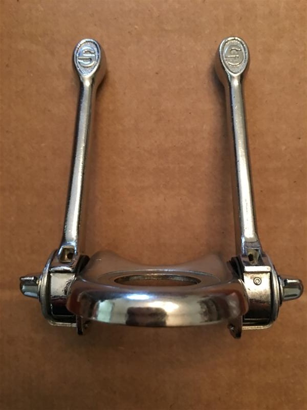

The bicycle's stikshift levers began in 1967 so it is unlikely to be earlier.

Another SCHWINN feature, the STEM SHIFTER (referred to as Twin STIK on 10 speed, single lever STIK on 5 speed models)
Perhaps METACORTEX might explain more on the subject of perhaps why SCHWINN made this change that I will mention here:
(s) 1967 - 1973 have the funky looking (s) on the shift lever
(S) 1974 - Chicago end has the cleaner looking (S)
On the 1974 5 speed SUBURBAN ONLY, the shifter was a Shimano thumb lever that was on the right side handlebar......1975 it returned to the STIK (S)
THE LATER (S) shifter is said to pull more cable and requires less throw (up + back movement)
THE 1967 -1973 earlier shifter is easily identified by the (s) that looks closer to the (s) s-shape as seen in the early kiss rockgroup logo than just a simple s-shape.......thus I refer to it as the funky looking (s) on the 1967-1973 STIK.
**************That is another distinguishing characteristic.
