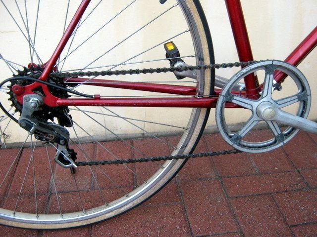

I'm doing a single speed conversion atm, using an old Sugino No.3 single ring crank, the BB is a Shimano UN51, spindle length - 114mm, sized it up and will fit perfectly
If that helps.

BTW, I used this same crank converting an old Indi 500 road bike, made it a 5X1..index thumb shifter, the 48 tooth crank was a good compromise, i thought
Was only on the market for one day
