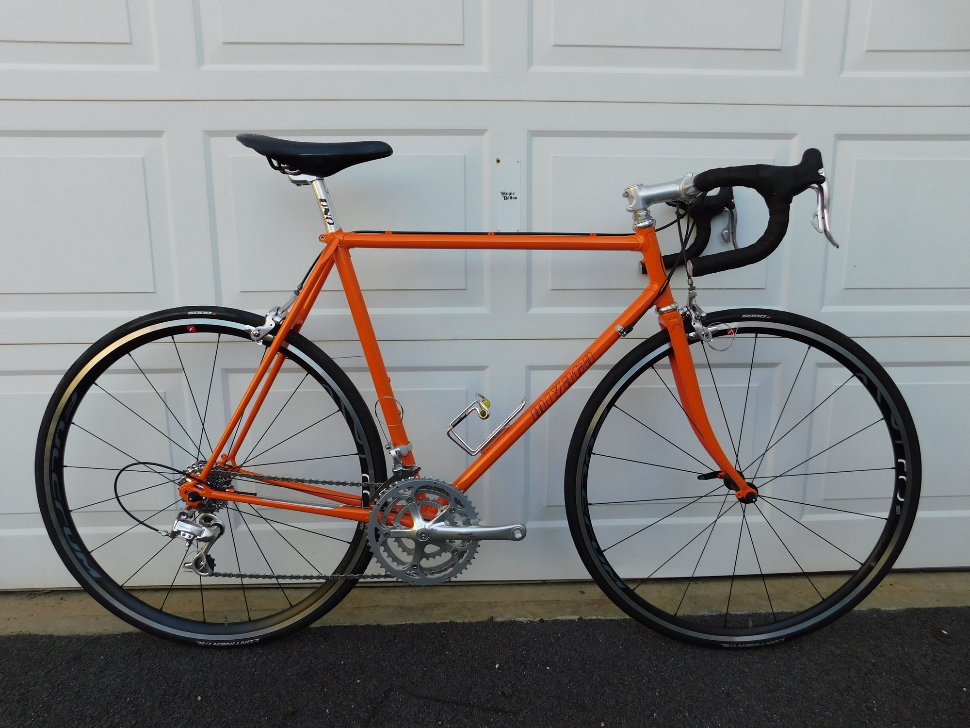

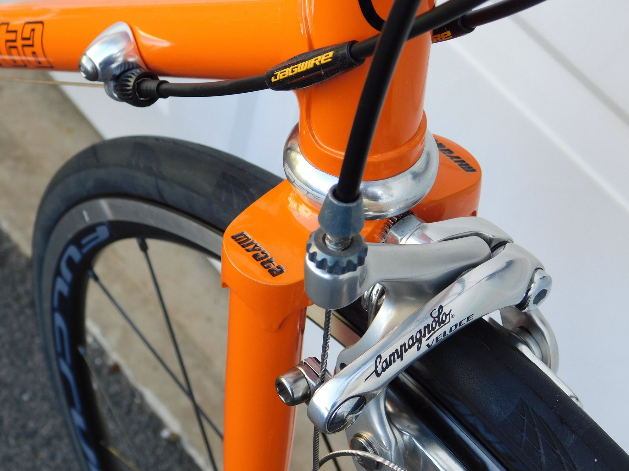

Finally got the last bits to cable this up. First time Ergo build (3x9 group from Brewsmith). This frame came to me in a swap with forumite Hobbitman. Was very happy with the deal, and seeing the original finish up close, even happier that my refinish plans were justified. This is an '86 Miyata 912. New color is Prismatic Powder PMB5342 "Aztec Orange" applied by Groody Bros. Black infill on the fork crown by yours truly. Decals from Velocals. Ritchey bars and stem with adapter. New 13-26 cassette. New KMC chain. FSA Duron headset. Wheels are Fulcrum Racing 6 with Continental GP5000 25s. The Cinelli Unicanitor CMX is a placeholder, but looks pretty good. I'll likely use some Look Keo Classics, but still not 100% decided. Weight without pedals is 22 pounds even.

Awesome job
The orange is great.
That infill work is also quite nice.
Ride report??

@chainwhip Thank you!
No real ride yet. Preliminary testing in the neighborhood here was fantastic. Love the ergonomics. Was pleasantly surprised at the ease of using the thumb levers from the drops. And I think I'm really, really gonna like these tires. Can't wait for a true test.

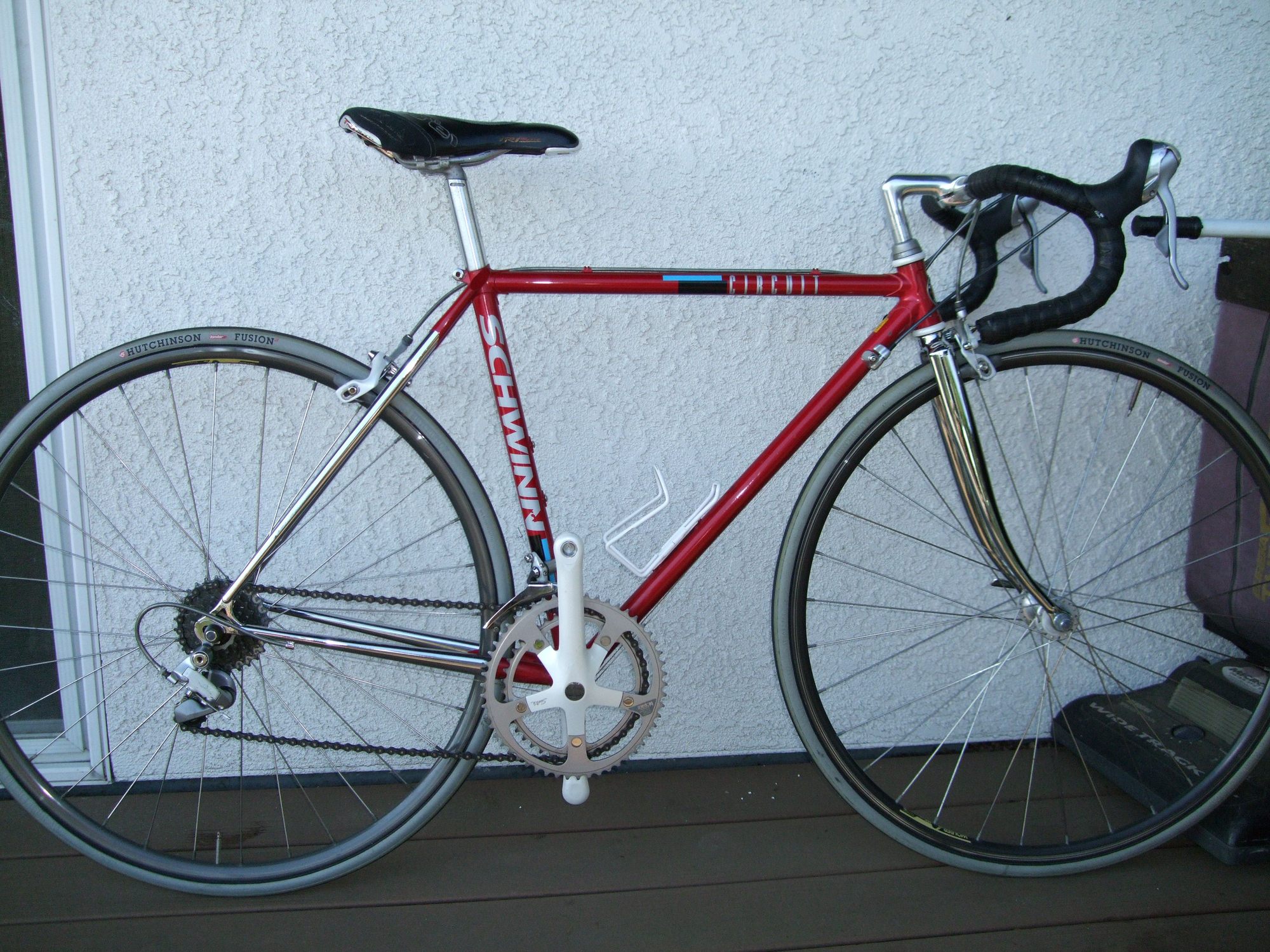

I've bought, upgraded and sold this very small Schwinn Circuit a couple of times over the last 15 years, here being sold yet again locally by the person who bought it this summer!
https://sacramento.craigslist.org/bi...240310729.html

Miyata Ride Notes
OK, got a little ride in today on the Miyata. Temps in the 40s, bit of a gnarly headwind heading south along the river.
Had the bike up over 30mph briefly and it felt great. The frame's a 57 and it feels really good. Most direct comparison I have is to my '87 Ironman, and this feels quicker, though I haven't been on the IM in a while.
No hiccups in just under 14 miles, though I need to tweak my FD high limit screw a hair. Shifting was nice - different, but nice. There were a few times when I pressed on the brake lever out of habit. I also noticed that I was pressing a bit too hard when shifting a single cog. I don't know if this is the norm, but when I did that, I'd get chatter at the derailleur. I discovered that if I gently apply pressure to the thumb lever, not enough to click, the chatter disappears. Being that these Ergos will span so many gears in one throw, I assume this is an intentional design? Maybe not? Once I figured out I was pressing too hard to shift one gear, all was smooth after. Shifting also felt quicker than it does on my STI bike. Overall, I really like both systems, and the Campy Ergos are really nice to use.
The Fulcrum freehub is really quiet. The wheels were relatively inexpensive, shipped super fast from the UK, and ride really nicely. Tire mounting was tight with the Continentals, but not a bear.
The highlight of the ride was the GP5000 tires. They are outstanding. Fast, grippy, supple - so glad I found these on sale! Highly recommended.
Would have liked to get a longer ride in but this was my time window. I am really pleased with the way everything came together. The hardest part was waiting for the USPS. Next time I get the chance to take this bike out, I'll head up and out of the valley. Looking forward to that.

Your posted pics don't show pedals... did you throw on some clipess?
Really liking the orange paint!

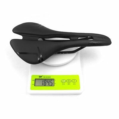

Here's a link to a nice saddle option . The real thing is probably marginally better, but for $40 , I've run a similar item for 2 seasons with very good results. This listing is only $30/ free ship:
San Marco Aspide knock off:
https://www.ebay.com/itm/2020-Carbon-Fiber-Saddle-Bike-Seat-Road-Bicycle-San-Marco-Aspide-Super-Leggera/373275972200?hash=item56e8fb5268:ghQAAOSweupfiGp8

Yes, I put a pair of Look Keo Classics on for that first ride. Likely stay that way, but still not 100% sure.
Thanks for the link. I'll add that saddle to my list. Currently considering a Prologo Nago Evo Pas and a Flite. I have the Prologo on another bike and like it. Never ridden a Flite before.

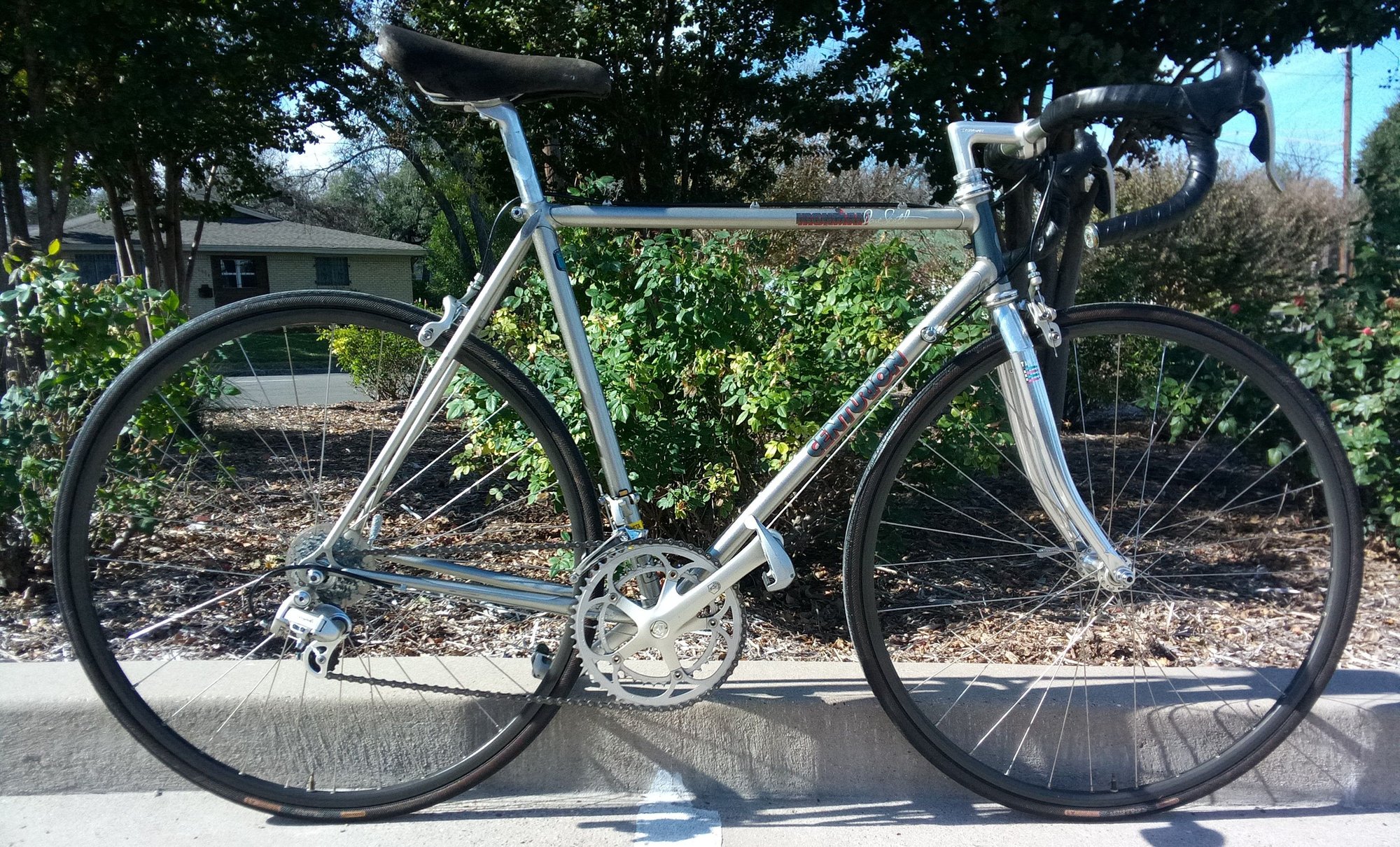

Fabric Scoop saddles are also well-made, reasonably priced and don’t look out of place on a vintage frame.

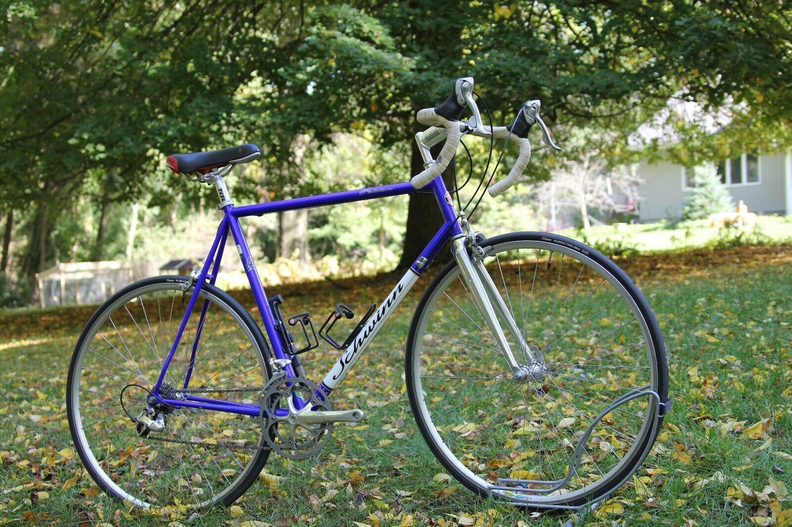

Last night I purchased a 1999 Schwinn Peloton that appears to be in excellent condition. I don't really like the frame though it should fit me, so down the road I plan to use the full Ultegra 9-speed group set (with Dura Ace rear derailleur) and the Ultegra hub/Mavic wheelset as a donor setup for my first real retro roadie! Of course, for the time being, I think I should just try to make the Peloton frame work and see how the thing goes. I've heard good things even with the aluminum fork still installed, though it's rather fugly.
That's the eBay advertisement photo below!

Ooh, late 90s Schwinn 853 road frame! Super neat. Its amazing to see how many brands had 853 road frames in their catalogs in the late 90s and early 00s.

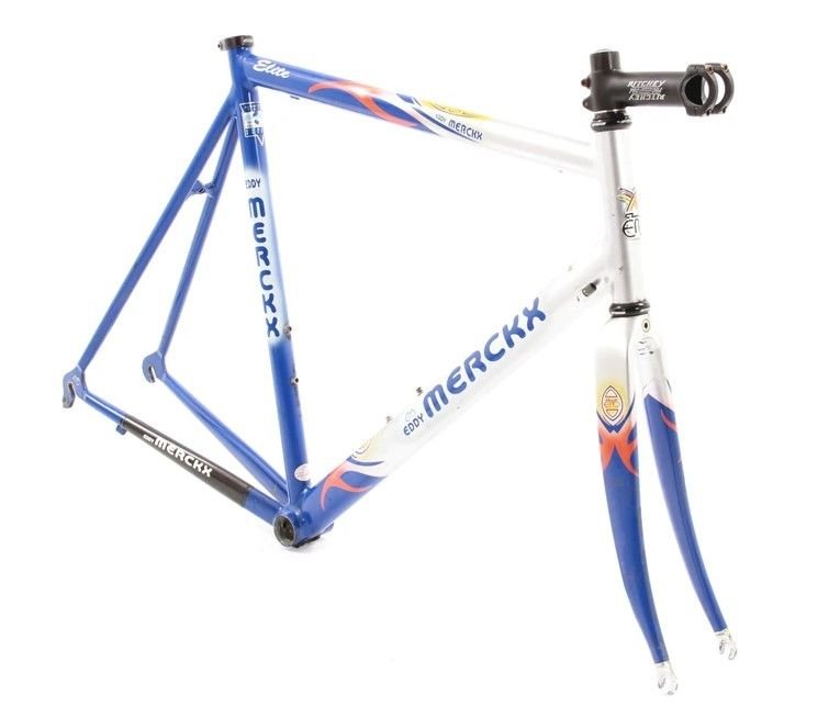

I am very close to buying a 2003 Eddy Merckx "Elite" aluminum frame with carbon fork all in a cool matching flame job paint scheme, and then swapping all of the components over. However, I keep reading great reviews about how these 853 Schwinn frames handle, and even about how crit riders from back in the day were swearing by them. The point of this project is to give myself a more explosive ride than my classic, relaxed steel frames and perhaps going all the way for the Merckx is overkill, considering what I'm reading about the Schwinns...
I'd say I need to wait and see what the Peloton feels like before making the choice, but I don't want the Merckx frame to get away if I go that route! In any case I'll want a new fork on the Schwinn, so that'll be about 1/4 the cost of the entire Merckx frame set, which I think is very cool looking and would undoubtedly be fast... Choices, choices!
