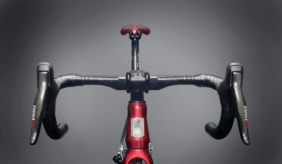

The look of 'no cables/housing' has the best visual impact (IMHO) when the internal routing starts at the handlebars. That totally clean and aero appearance up front also likely has the best practical aero benefit, too. Internally routing the wires on frames with significantly curved tubing improves aesthetics, too.
I never really understood the practice of piercing the top tube twice to hide a rear brake cable for a straight distance of only 50cm.
