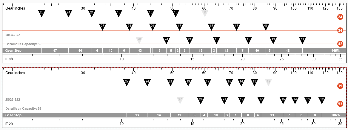

HTupolev
Join Date: Apr 2015
Location: Seattle
Posts: 4,264
Quoted: 1974 Post(s)
Liked 1,298 Times in 630 Posts
Originally Posted by sovende
I suppose a person could memorize the “progression” but that’s too much work for me!
Interesting. I sometimes make charts, but mostly to plan builds or explain gearing to others. Referencing a chart mid-ride has always sounded very cumbersome to me.
Even if I was going to tape something to my stem, it would probably not be this...
...but instead something along the lines of this:
But I mostly have the latter in my head anyway.
HTupolev is offline
Of course you are joking with the crazy decimal fractions . I like the “dot” diagram but I’d have to put it on the top tube! My “chart” is much simpler:
