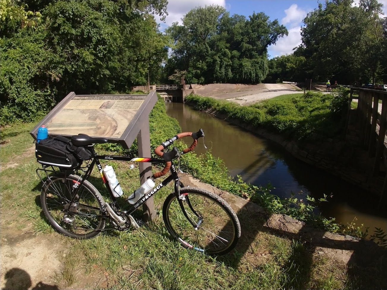

The wheels that you have are probably good and serviceable. Don't let the bike shop worry you into buying something you don't need. Ride it and see how it goes. It sounds like it has a good hub, if the rim is straight you are in good shape. Even if it goes out of trues sometime later, have it trued and keep going. If the rim eventually fails, then look for a new wheel (save the hubs, they sound good).
By the way, the best part of the pertinent information is that you rode it 75 miles right off the bat. Keep enjoying it and don't worry.
I do have one issue and that is I'd like to see a picture of your Peugeot. Please get a picture and post it.

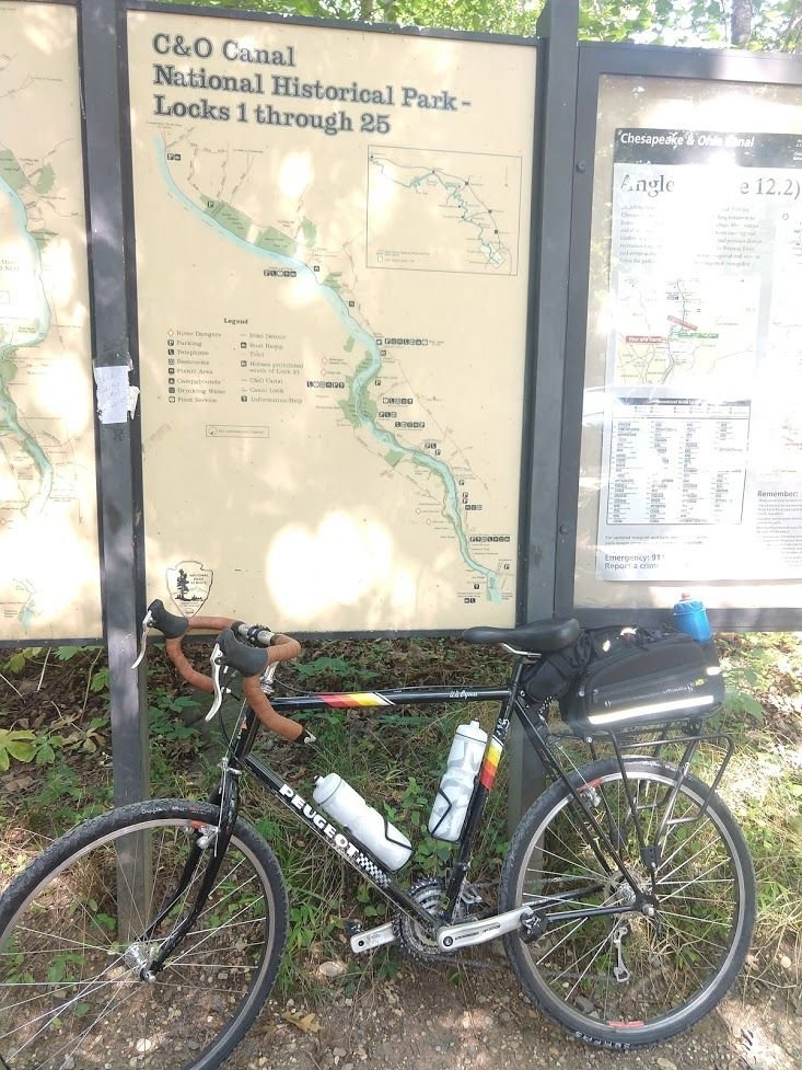

Don't have to ask me twice

Looks like a fun-loving bike! If it were mine, I'd be willing to build it new wheels in a heartbeat.

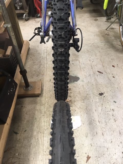

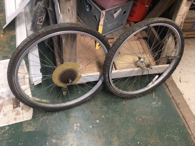

I volunteer at a bike kitchen. We have so many 26" wheels we (almost) can't give them away. I say "almost" because transients will always take them.
While I'm not sure what a bike kitchen is... I think it's probably similar to the places in my area I was thinking about. Certainly seems like the vast majority is 26" and if that's the case I'm sure I must be able to find *something* if it ends up being needed.
Yeah man... Having only a road bike for the last few years I've been wanting something I could more comfortably take on some of the rails-to-trails type paths in my area. This has kind of surpassed my expectations in a very short time. What are the odds that someone would make basically the bike I was considering? Finding an old cheap MTB (adverts I've been able to find on this model call it an ATB, which I guess would've been more accurate) adding some drops and more road oriented gearing. What's more, I almost buckled and bought a gravel bike for the purpose, but I don't think that would have made me as happy as this has. There's something to be said about riding a bike that I would have thought was cool when I was a kid in the 80s.
