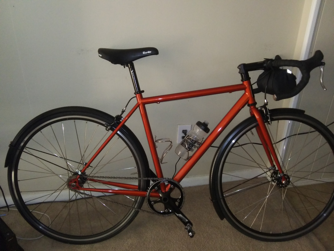

rear rack no bottom eyelets
Any advice for mounting this rear rack? I there are screws up top, but nothing to fasten to below.

What bike is that?

Old 07-13-21, 12:01 PM
sensitivejonah
Location: Michigan
Posts: 18
Quoted: 6 Post(s)
Originally Posted by 10 Wheels View Post
What bike is that?
It is a State 4130 Single Speed

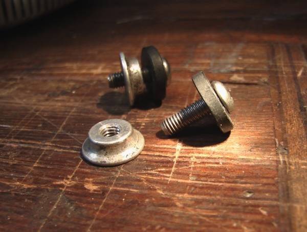

Old 07-13-21, 02:16 PM
JohnDThompson
Old fart
JohnDThompson's Avatar
Location: Appleton WI
Posts: 22,837
Mentioned: 134 Post(s)
Quoted: 2682 Post(s)
Liked 1,395 Times in 866 Posts
P-clamps are probably the easiest way to deal with this. Make sure you get steel ones; plastic p-clamps are only strong enough for mudguards.
Alternatively, Blackburn used to make "custom eyelets" that fit in the window of the dropout. You can still find them on e.g. eBay.
I'm not fond of mounting racks on the hub axle; it makes wheel removal awkward.

Old 07-13-21, 04:31 PM
squirtdad
squirtdad's Avatar
Posts: 7,706
Mentioned: 79 Post(s)
Quoted: 1432 Post(s)
Liked 765 Times in 515 Posts
I had a set of these once worked great. I recently made similar using m5/6 bolts, washer and plumbing rubber cones..... it OP is creative and can do a few trips to ACE it is really not that difficult to do....just fiddley

Old 07-17-21, 10:52 PM
Miele Man
Location: Ontario, Canada
Posts: 4,395
Quoted: 1208 Post(s)
Liked 773 Times in 543 Posts
Here's what the Blackburn rack adapters look like in real life.
Cheers
