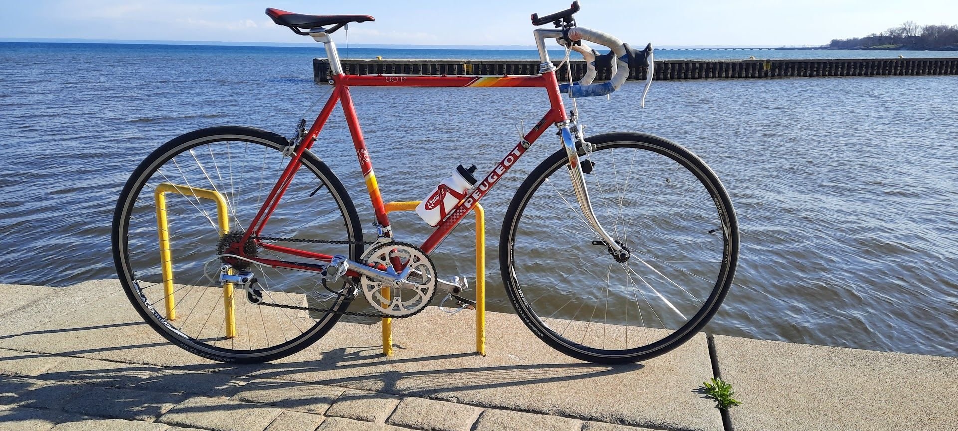

Bike riding I've always done but bike maintenance is something relatively new to me and I used to just take it into the LBS every few years for a "tune up". I noticed the shifting on my newer road bike was starting to diminish so I adjusted the rear derailleur which improved things a bit but decided to take it to the LBS to look over. They said the chain was worn 100% and would need to be replaced along with the cassette. I didn't think to check the chain.
I then went home and checked my C&V bikes for chain wear but wondered how easy it would be to replace the chain and the freewheel? some of them I've replaced with new wheels and cassette but even then, not easy to find older cassettes these days. Do I leave it or get on this right away?
TBH they all ride nicely and I'm scared that if it ain't broke, don't fix it.

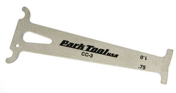

What @genejockey said. Also, a chain wear checker tool (Park and Pedro's make good ones) can check your chain in 5 seconds. Barring that you can use a steel ruler to measure 24 links of a taut chain (should be exactly 12" = unworn, 12-1/8" = shot, and 12-1/16" = time to replace
verktyg
Posts: 4,030
Mentioned: 207 Post(s)
Quoted: 1036 Post(s)
Liked 1,238 Times
654 Posts
Park CC-3 Chain Checker
It's been superseded by the CC-3.2 gauge with .5% and .75% wear indicators rather than .75% and 1.0% on the original checker.
This short video has a lot of good info on chain wear and how these gauges work.
Park also makes a more expensive CC-2 for more critical measurements on 10-11-12 speed chain.

I'd check the chains with a ruler and replace as necessary. Chain checker tools are nice for a quick and easy reading, but many, like the Park shown above, can sometimes tell you a chain is worn when it's still OK. Pedro's makes one that is better about that but harder to use. A metal ruler with easy to see lines is a reliable tool for this.
I wouldn't replace the freewheel unless you have some reason to believe it's worn. If your chain is really stretched, there's a chance the freewheel may be. Bike shops will suggest that you replace both together because that makes their work more reliable. They want you to have the best possible experience out the door. If you're doing the maintenance yourself it's usually not necessary. I replace my chains about every 2-3000 miles (sometimes as little as 500 miles depending on the conditions they've been used in), but my cassettes last much longer than that. If you don't have shifting problems, you can look for visible signs of wear on the cogs.

Ok so I got the chain checker tool, had a look the chains on my bikes and 3 are fine but my favourite bike, the Peugeot is at 1.0 so it is worn. It doesn't have problems shifting and it doesn't skip on me when riding but then I'm not racing or taking these bikes on long tour rides. Usually for short rides or to the coffee shop.
I have 4 vintage road bikes. Two of them I have upgraded the wheels to 700c, modern wheels which required a cassette and the other two I have left original wheels on which still use a freewheel, hence both systems in my previous comment. Both cassettes I bought used so I guess I was lucky they even worked OK with the existing chains I had.
Is there a recommended chain I should be looking at for older bikes? It sounds like it would be handy to have Verktyg's left over Sedis chains but I guess I will have to find something new.
Sorry for the confusion, the original bike I took to the bike store which was assessed with the worn chain is a newer bike and that will be addressed later. My concern and reason for the post was about my older bikes, and how to keep them running with 30+ year old components. Here's the vintage bike with the worn chain.

For me, the best chain checker is still a ruler. If 24 half-links measure more than 12-1/16", the chain has elongated by 0.5 percent, and it is time to replace it.

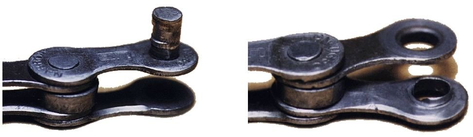

Chains don't "stretch", the pins and side plates wear which results in the length increasing (photo courtesy of Sheldon Brown RIP)
This shows the area where the cogs wear.
Here's another type of sprocket wear - "Shark's Tooth" or hooked sprocket teeth.
