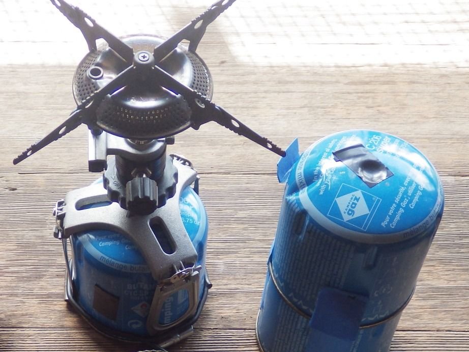

Photo of my MSR Superfly on an Ezy Clic canister. (Someone was giving away a couple of these canisters at a swap meet since he did not have a stove that worked on them, I was happy to take them off his hands.)
The MSR stove in the photos above will NOT work with the nozzle type adapters that I cited earlier in this post. Only threaded stoves will work on those adapters.
