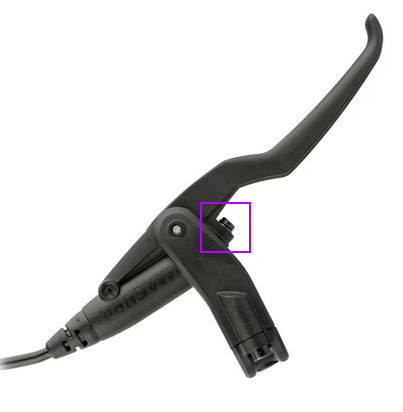

I have a couple of questions (for the HS11 rim brakes, FWIW):
1. Is this Torx 25 screw used just to adjust the reach (short/long fingers) intially once and for all, or must it be tightened as the pads wear?
2. When replacing old pads, is an extra step needed not mentioned in the official video*? What to do when the new pads touch the rims, and won't let the wheel spin?
Thank you.
