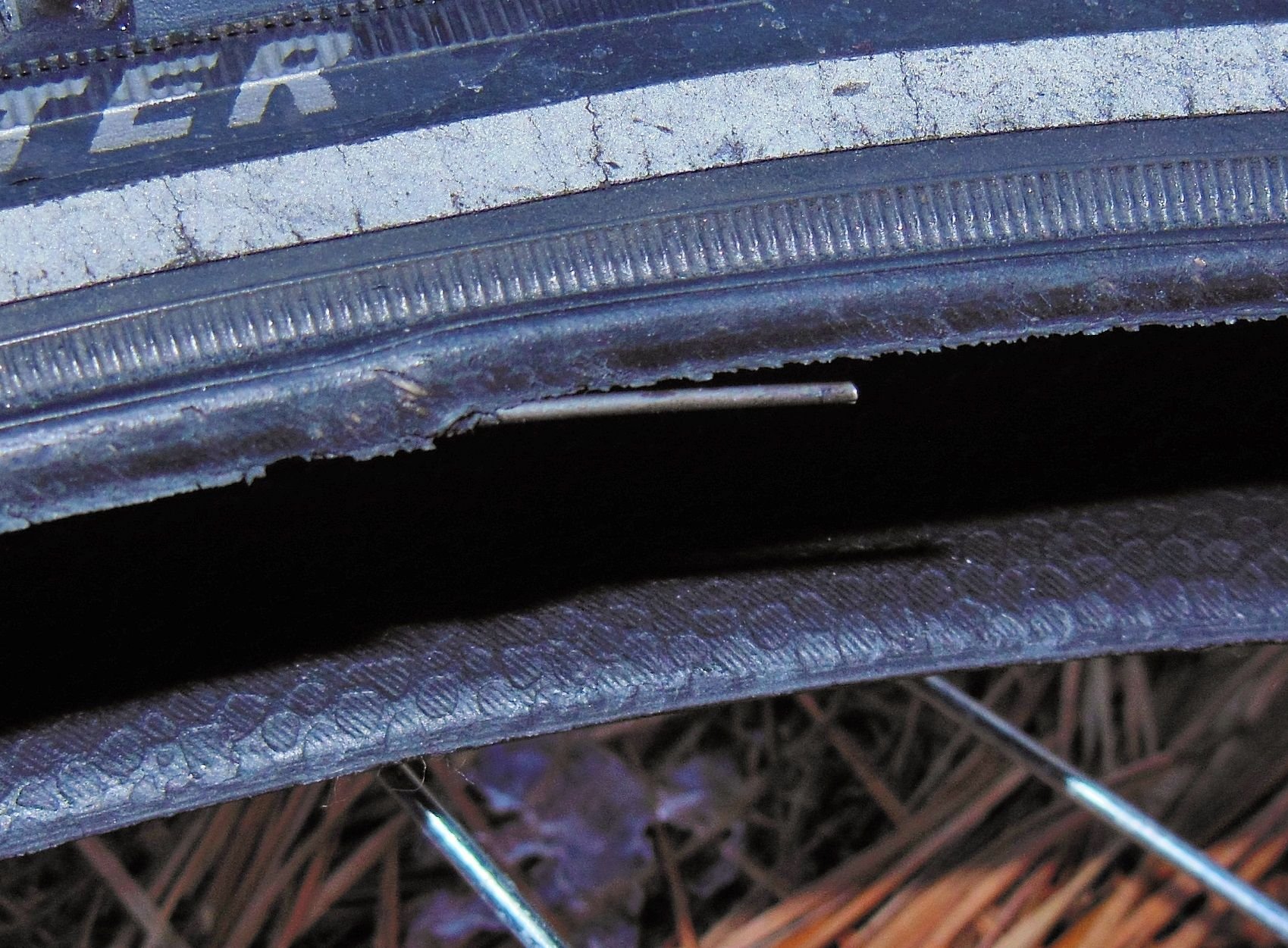

got 2 flats from this problem (broken wire bead poking thru the rubber). on a set I bought used. 1st flat didn't realize the cause. the 2nd flat shortly after, oh yeah, saw that then. installed last tube I had on me & covered the wire with tape & band aides. it was holding but I hitched a ride back to my car. got lucky cuz it was getting dark & I was in a state forest exploring one winter. it cudda been a long cold walk back to my car
I can not access my photo albums however right now for some reason. luckily google helped me find an old post from 2/5/17 w/ the pics

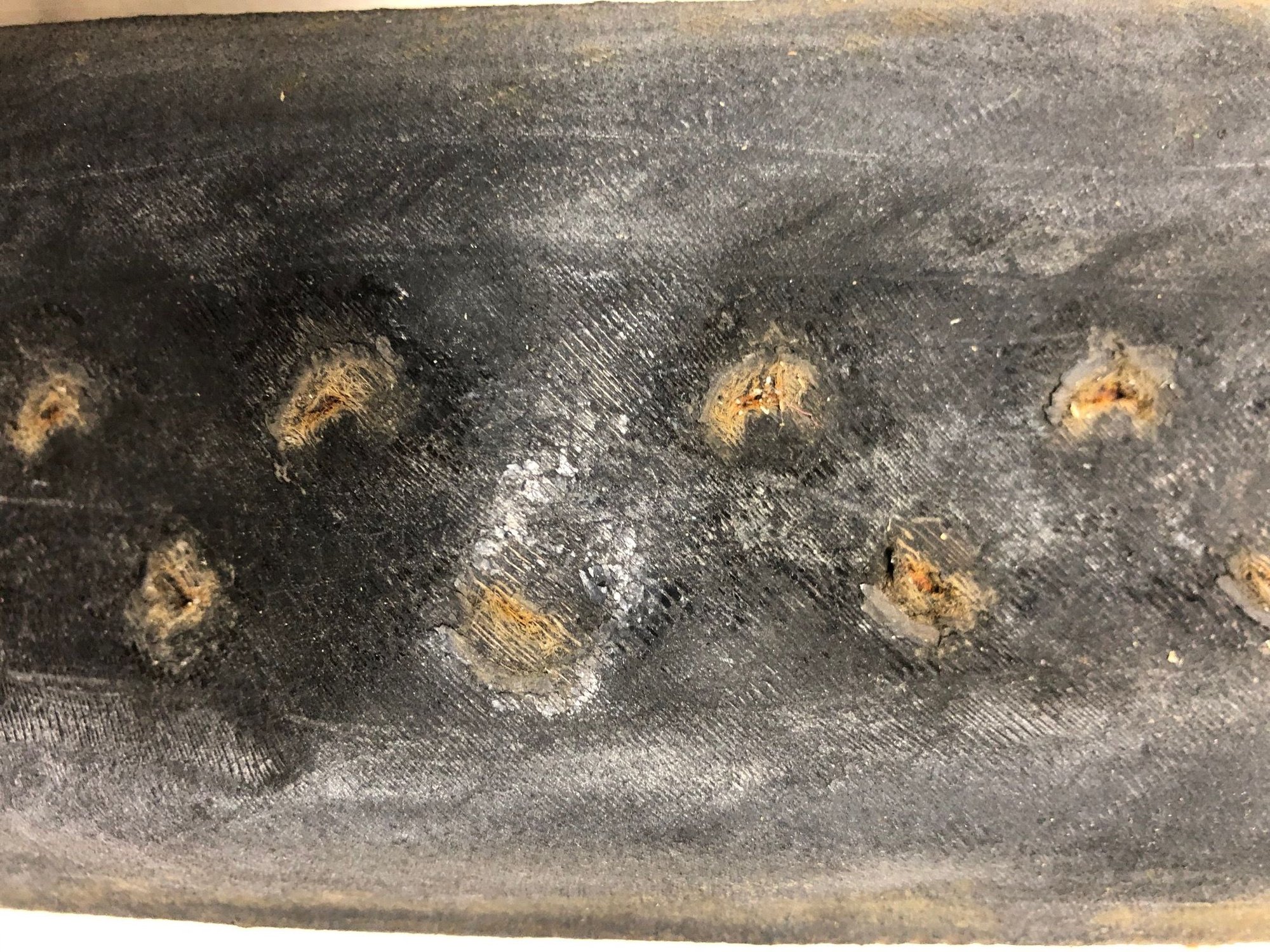

I've been using Marathon Winters for over 10 years on a folding bike with 20" wheels. I had some of those self-inflicted flats after the first couple winters. The rear tire deteriorated fastest. I would have bullet-proof performance the first year, then the occasional flat. As you point out, flats in the cold are not fun; I'd go farther and say on a commuting bike they are unacceptable.
I have for several years now been using "Mr. Tuffy" tire liners. I have had *zero* flats except for a valve stem that conveniently came off after arriving at work. Also, I have not had the experience reported by others of flats caused by the tire liners themselves. I don't get as many miles as you report; on the rear, I probably get 1,500 miles on a tire, probably 50% more than without the tire liners. This may be because they are 20" tires.
Installing the liners is a bit of a challenge, but I've been using double-sided tape rated for "outdoor use" to keep them in place while mounting the tires (8 one-inch strips).
I have a set of Nokian "Extreme 296" tires that are used on my mountain bike, not for daily commuting. These are several years old and have not deteriorated appreciably. I am unable to say for sure that this is due to higher quality because the use is so different.
This Marathon Winter is probably shot, but no flats resulted over its last winter due to the use of a tire liner.
Here's a Marathon Winter with one winter season on it. Early signs of stud wear-through can be seen. At the right, the end of the tire liner is seen.
