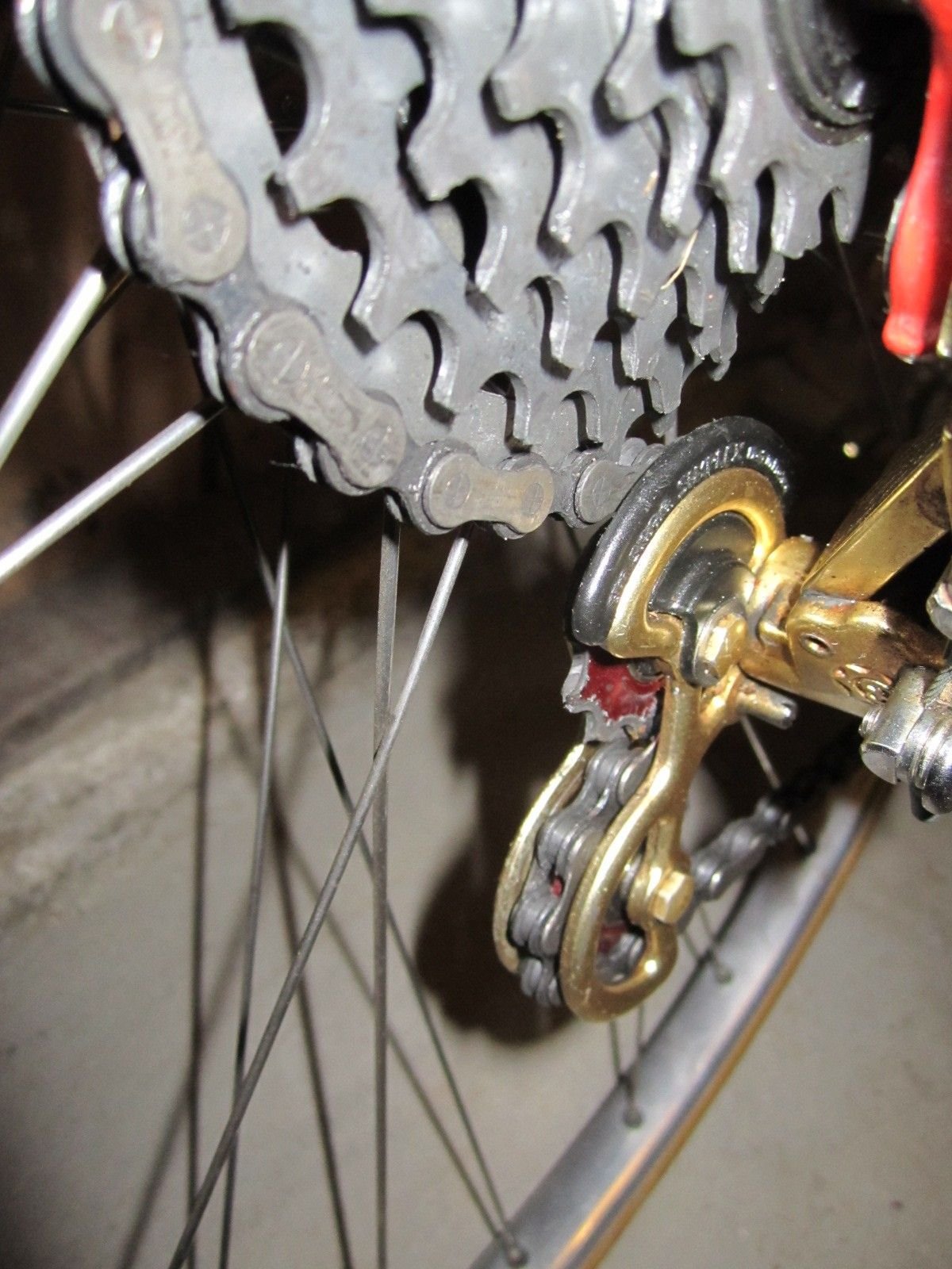

Sedis Sport Gold Chain
Originally Posted by Chombi1
Nope, I don't think it was "golden" old grease. You should have seen how nice and gold it looked under the pool of WD40 in my component cleaning tray before the finish disappeared......
Here ya go Chombi1, Sedis Sport Gold chain on my 1980 Bertin C37bis that I got new 37 years ago. This is the original chain and I haven't ridden this bike that much, maybe less than 1000 miles. It's dirty but it's original dirt... Actually an old picture I took a few years ago to show the Simplex plastic pusher plate.. You can still see gold color on the links. It would look better cleaned up, but it would just get dirty again....
I suspect that the gold color on the side plates was brass plated. It seems like that was the the most economical way to manufacturer them. The biggest problem is fixturing those small parts.
As far as the colored fixiefool chains, I think that the component parts on those chains are coated with an epoxy type paint.

Originally Posted by Lascauxcaveman
Yeah. And pretty much every bicycle mechanic (professional and amateur) I've met uses WD40 to good effect for degreasing old components. I haven't met one who's complained about it 'ruining' anything. Except maybe a thin and fragile gold colored finish on a chain. And frankly, that's a new one to me, since I've cleaned up a couple of old gold Uniglide chains with the stuff and those chains are still nice and gold-colored. I'm guessing contact time matter quite a bit here.
If you want to make the point that WD40 is not a very good lubricant, I'll go along with you there, as it evaporates pretty quickly. But for cleaning stuff up before you add the lube; it's pretty hard to beat.
WD40 was developed to displace water in electrical equipment thus WD. Back in the 70's it was supposed to have contained some silicone which is a light duty lube???
In those days in New Mexico we used to use WD40 for chain lube. Water was almost never a problem but dust was. Most other lubricants at the time would pick up the fine grit and wear out your chain and sprockets. I applied the stuff before every ride. It helped keep the chains clean too.
Since I was running the shop and we bought Sedis Sport chains on 50 meter and 100 meter wooden spools, I changed my chains every 3000 miles whether they need it or not. They only cost me $3.00 each.
Fortunately I saved the old ones in baggies. I was having some shifting problems with my Ironman with a 7 sp SIS indexing RD. Out of frustration, I bought a Park CC-3 Chain Wear Gage. I found the problem, it was a worn out upper pulley. But Wait! I checked out all the old Sedis Sport chains and they were all good.

Originally Posted by Cute Boy Horse
Well the WD40 tells us you wanted the chain ruined anyway. Seems it worked.
I tend to agree. The factory lube on chains is imo the best lubricant the chain will ever see in it's limited life, due to how it is applied when the chain is made. Removing it right away takes away one of the best parts of a new chain. YMMV.
