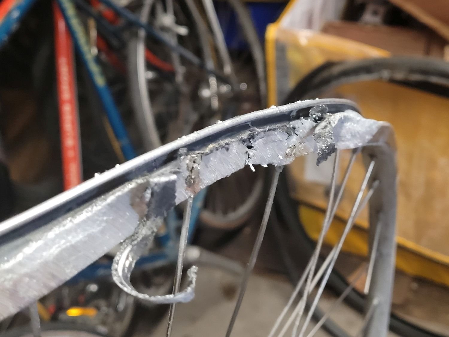

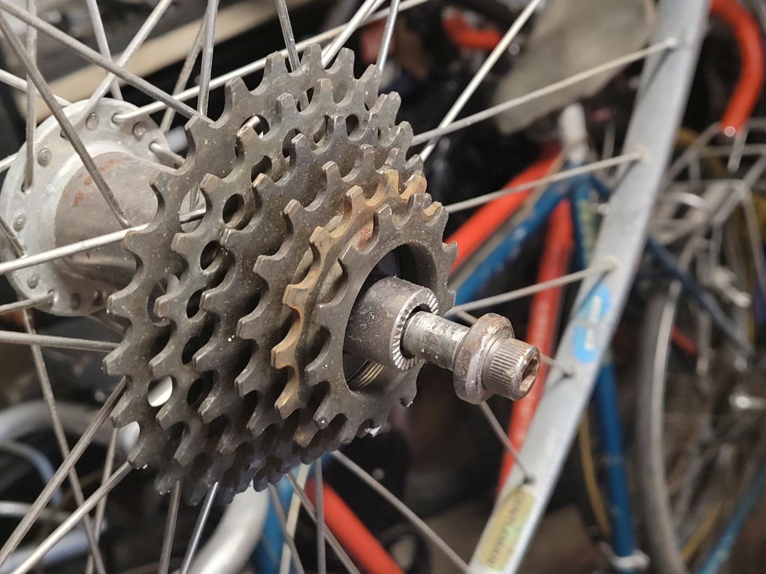

It slipped right out. Pushed the wheel forward of the drops, removed the derailer from the dropout for ease, unwrapped the chain, and the wheel tried to fall to the floor. Chain looks fine.
Part of the axle is missing on the rear Phil hub, and the inner shaft started to pull out as I undid the drive side bolt.
Speaking of which, this has to be in a vise for any straightening. It's most definitely not budging at all - even with the Park straightening tool - if in the conventional stand (not that one would want to, lest they damage the seattube). Still, but this compound bend is a lot stronger than one might think from looking at it:

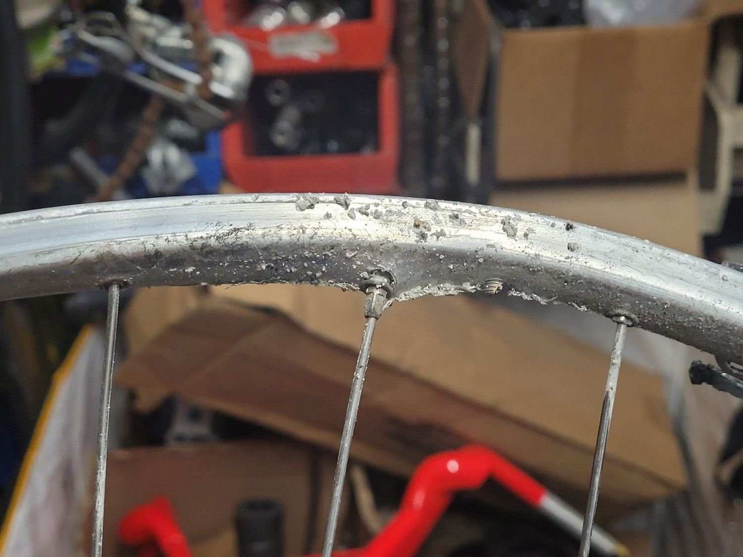

Some more looks at the impressive carnage on the tire and rim:

Obvious gravel/concrete dust:

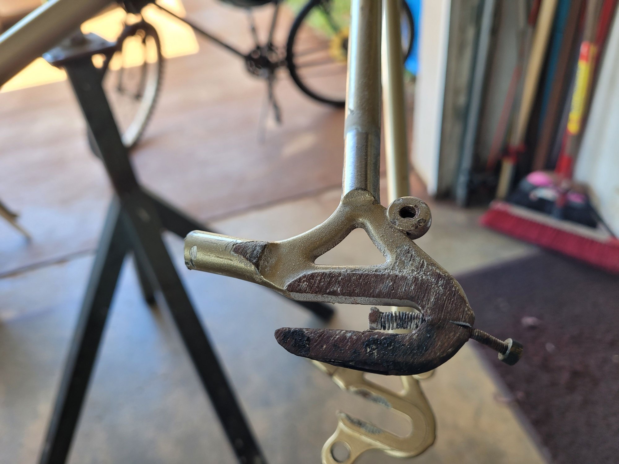

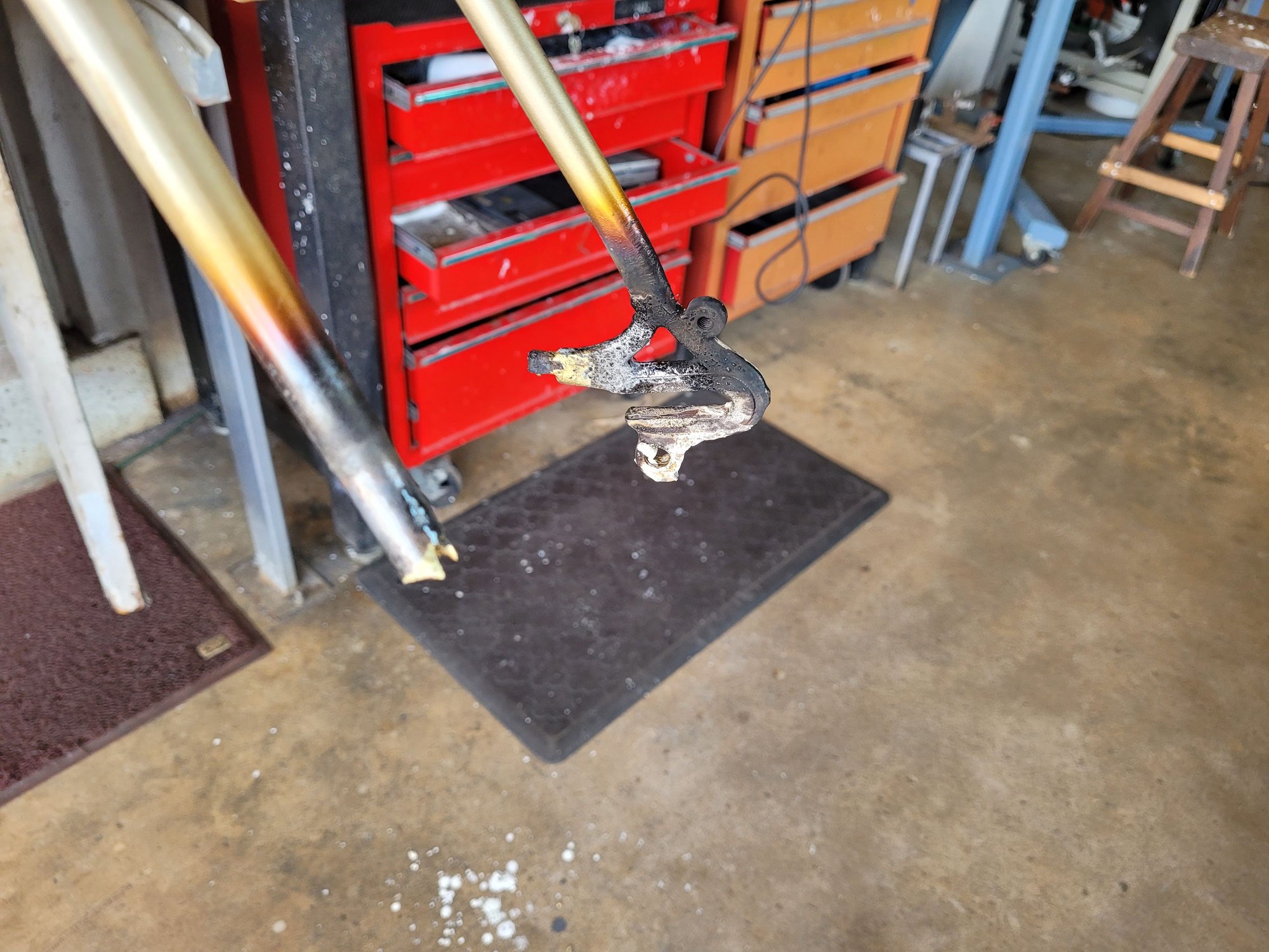

And now for another episode of Be Fruitless and Fustrify:
The Park chainstay straightening tool could only do so much. But I was impressed at what it did do.
And here's the results after I lost interest - or rather, realized the limitations - of what I can do. The seatstay still makes the rear triangle ludicrously strong (what was that nonsense in the recent Pinarello thread about cold setting rear triangles being bad?), and the left isn't isn't far off from being where it should be.
I was surprised to see it develop a kink here. I think the left stay was pulled backwards so hard that it weakened the 531 on the outside edge. Inner dimple is fine.
Dropout is cracky cracky. Nothing unexpected.
I'm probably going to throw it on Mike Terraferma's frame table anyway. Just for giggles.

Well, if I play my cards right, this thing just might get put back together. It'll probably be another three weeks before anything starts - but in the meantime, if anyone has an orphaned, left-side 1010A - eyeletted - that they want to sell, I'm open to it.
Kind of amazing how well it held it's shape. Quality bike tubing is pretty damn impressive.
You said it. These 531 stays do not bend with the ease of hi-ten.

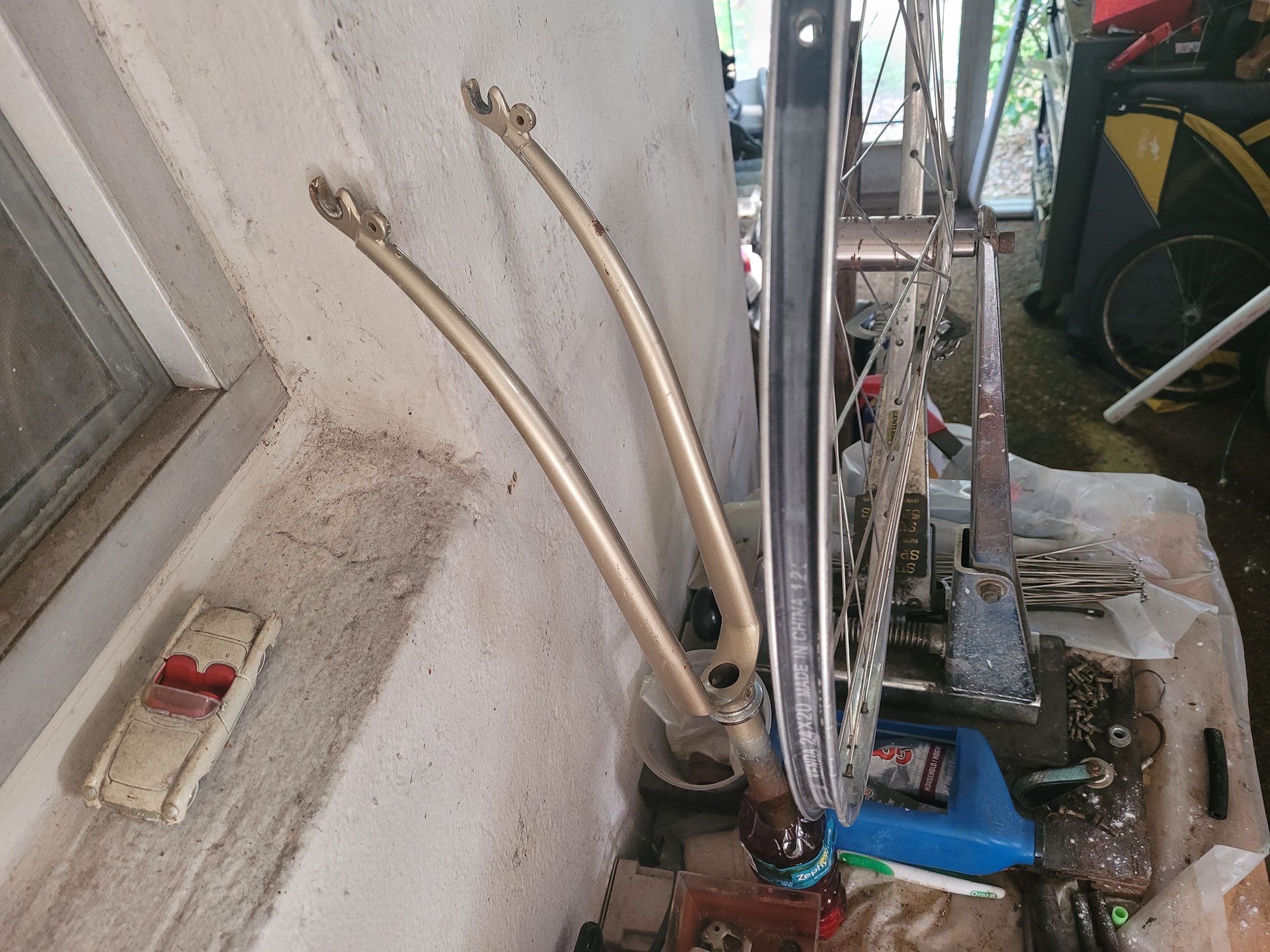

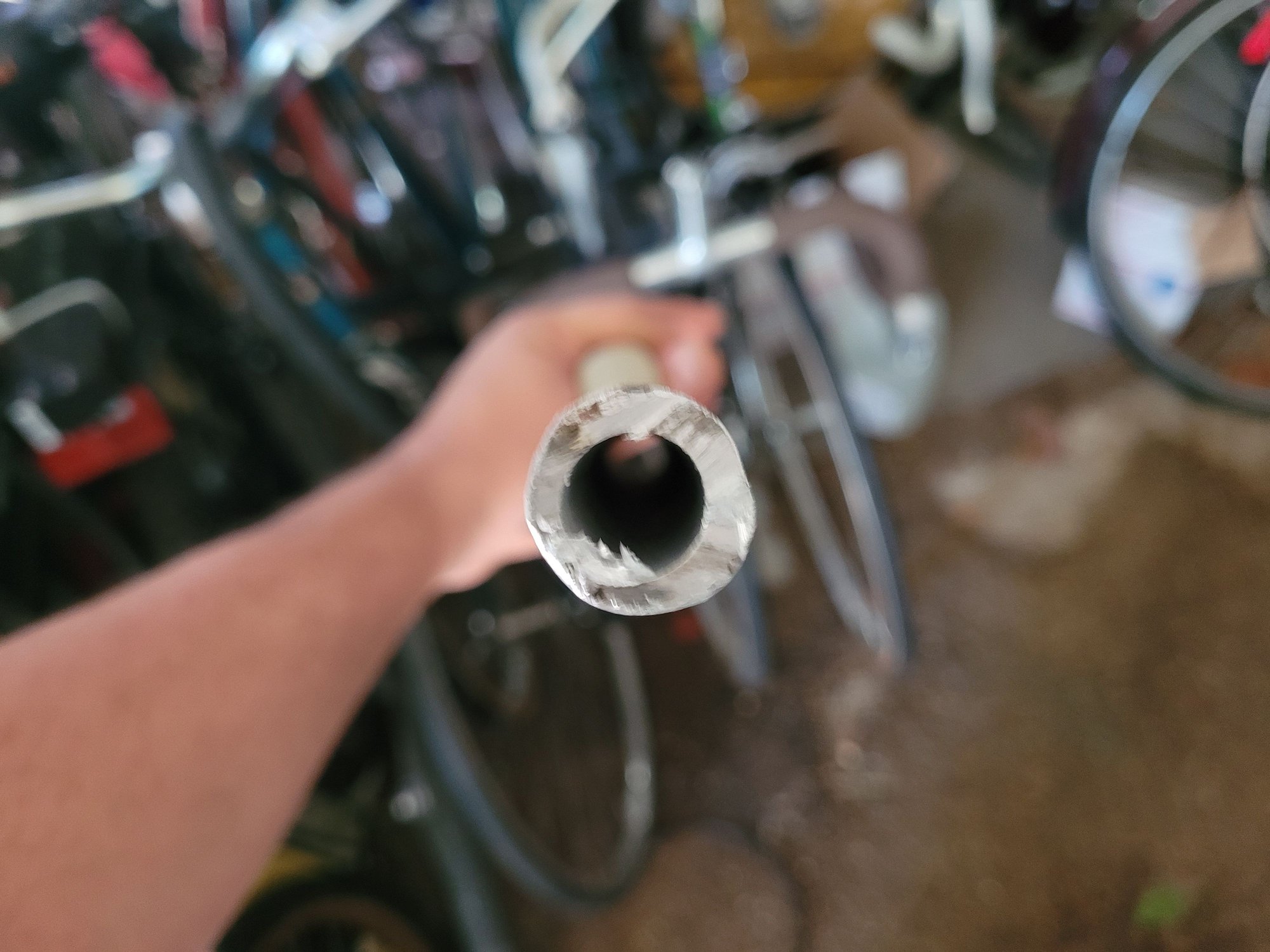

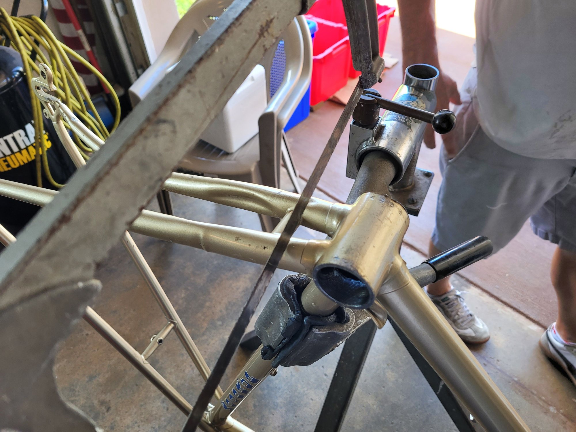

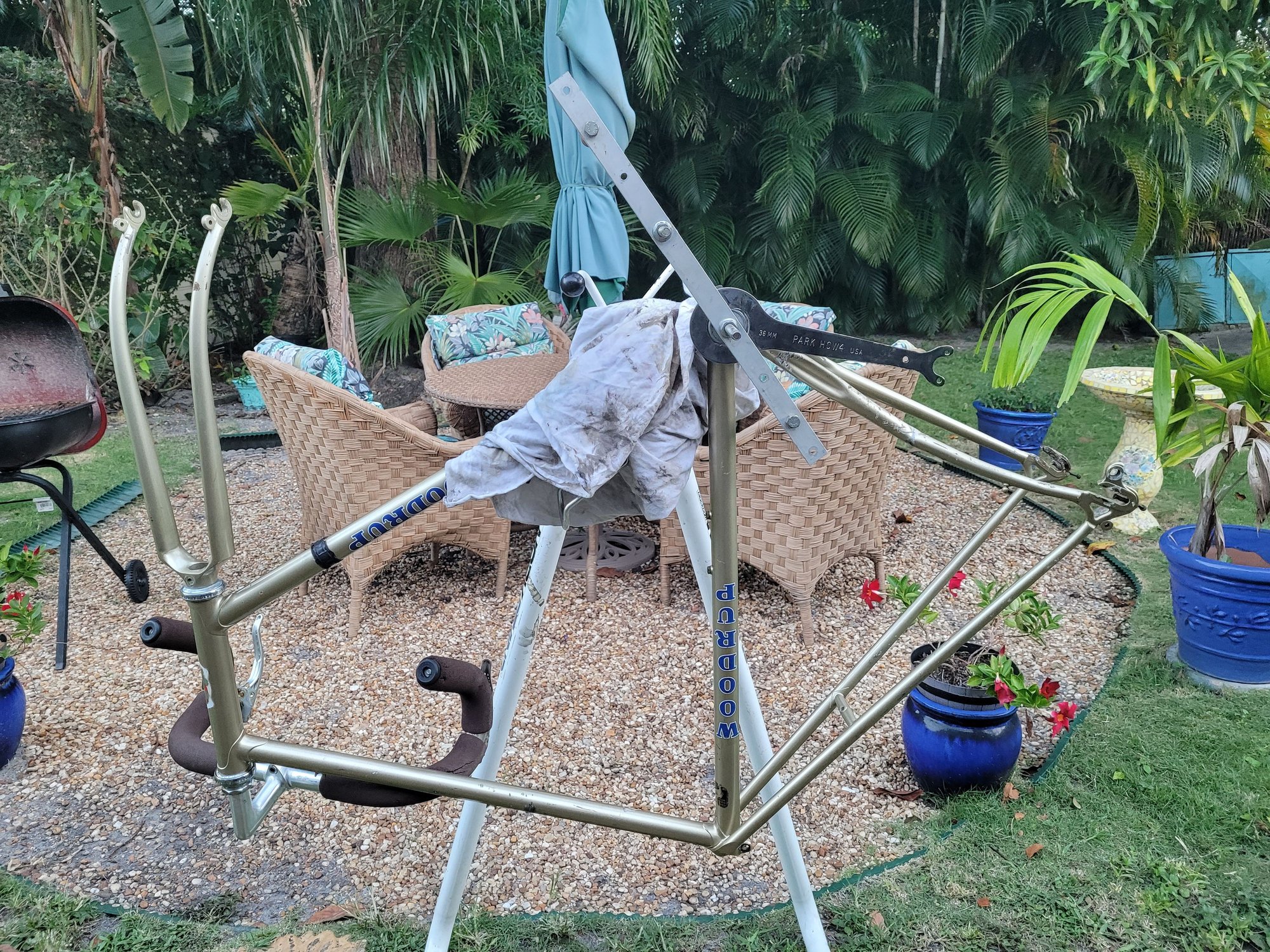

Not much of an update, but at least it's ready(ish) for the frame table and jig as soon as I cut the stem out and pull the fork. Fixed cup wouldn't budge, not even with the beautiful Var tool. I wound up resorting to my old, homebuilt bodge job of a tool - which has yet to fail. I've also never cut it down and simplified it as I should, but that's another story.
This is, however, the first time I've ever had to wail on it with a sledgehammer:
Everything came apart with no damage (hahaha!); now to take care of the stem. Really don't want to sacrifice yet another Cinelli stem to the gods of stuck stems but...well, at least there will be more spare binder bolts.
-Kurt

Funny that you should ask, as I dunked the fork a few days ago. I'm experimenting with something else though - mostly to satisfy my own curiosity: Oxalic acid. I've always wanted to see what it does in this scenario. If it removes rust and it eats aluminum, in theory it should have an effect on a stuck stem, but I've yet to read about anyone trying it (probably because it doesn't work, but I want first-hand experience!)
Correct me if I'm wrong, but the idea of the ATF/acetone trick is that the acetone helps draw the slippery ATF into the gap between the stem and the steerer, correct? I'm not convinced it'd work in all scenarios, but if this doesn't work, I'll give it a try.
Here are the pictures. I cut the stem nice and long so I can grab it in the vice later.
Cinelli stems get wider the closer you get to the top of the quill, so I tapered it with the handheld belt sander. Could have used a grinding disc, but the belt sander was easier to grab at that moment.
Also rather lucky (if I want to apply pressure from the bottom) that the stem wedge fell right out of the steerer. No nails or rough spots around the crown in this fork.
And here it has sat for the last few days. Not sure if I should up the oxalic content.
-Kurt

The fork has been dunked for a few days now to no effect. Going to neutralize the OA bath and swap over to a smaller container of ATF + acetone to see what happens. I still have my doubts; I dare say the aluminum needs to be dissolved for this to work.
Meanwhile, developments with the frame:
Seat tube was twisted to the right by a good ~15mm, worse than what the photo suggests.
Headtube was also off plane. Some unceremonious cold-setting fixed it:
Chopping off the stays from the BB. The Woodrup is brass brazed, not silver brazed, so the tubes have to be ground out with a die grinder; heating them up could potentially get the BB too toasty - and result in it cracking when the tube is pulled:
Lots of tension in this sucker:
Paint removed from the left stay in preparation for it's removal. It had a surprisingly small amount of brass holding it in.
Left dropout out, and the tip of the right chainstay is off too.
Next order of business is to die grind the chainstays out of the BB, then reconstruct the left side of the rear triangle.
