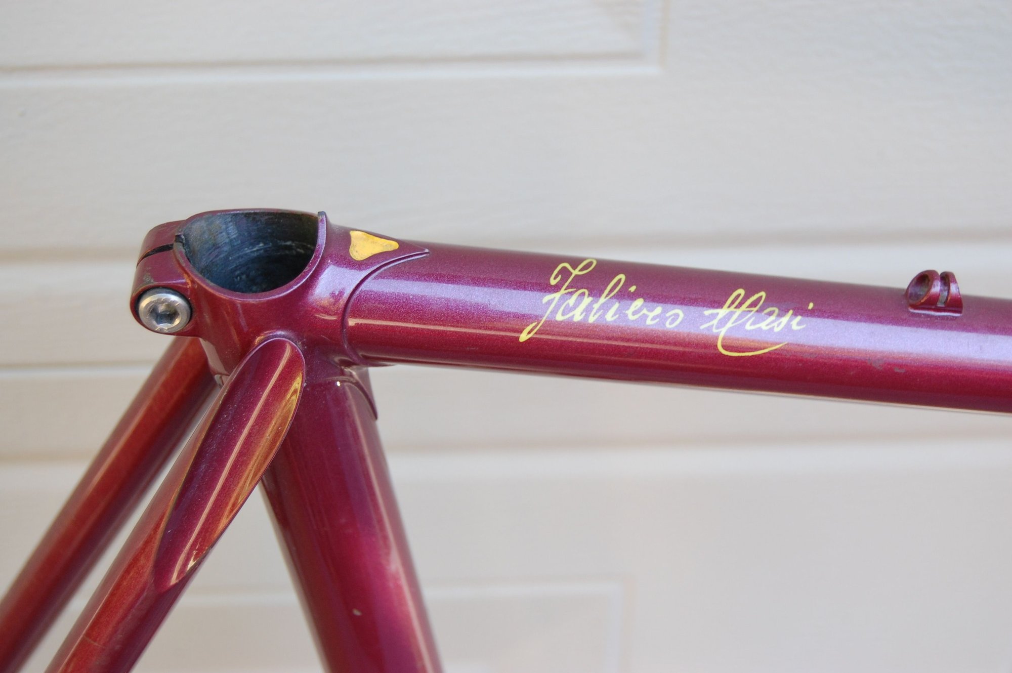

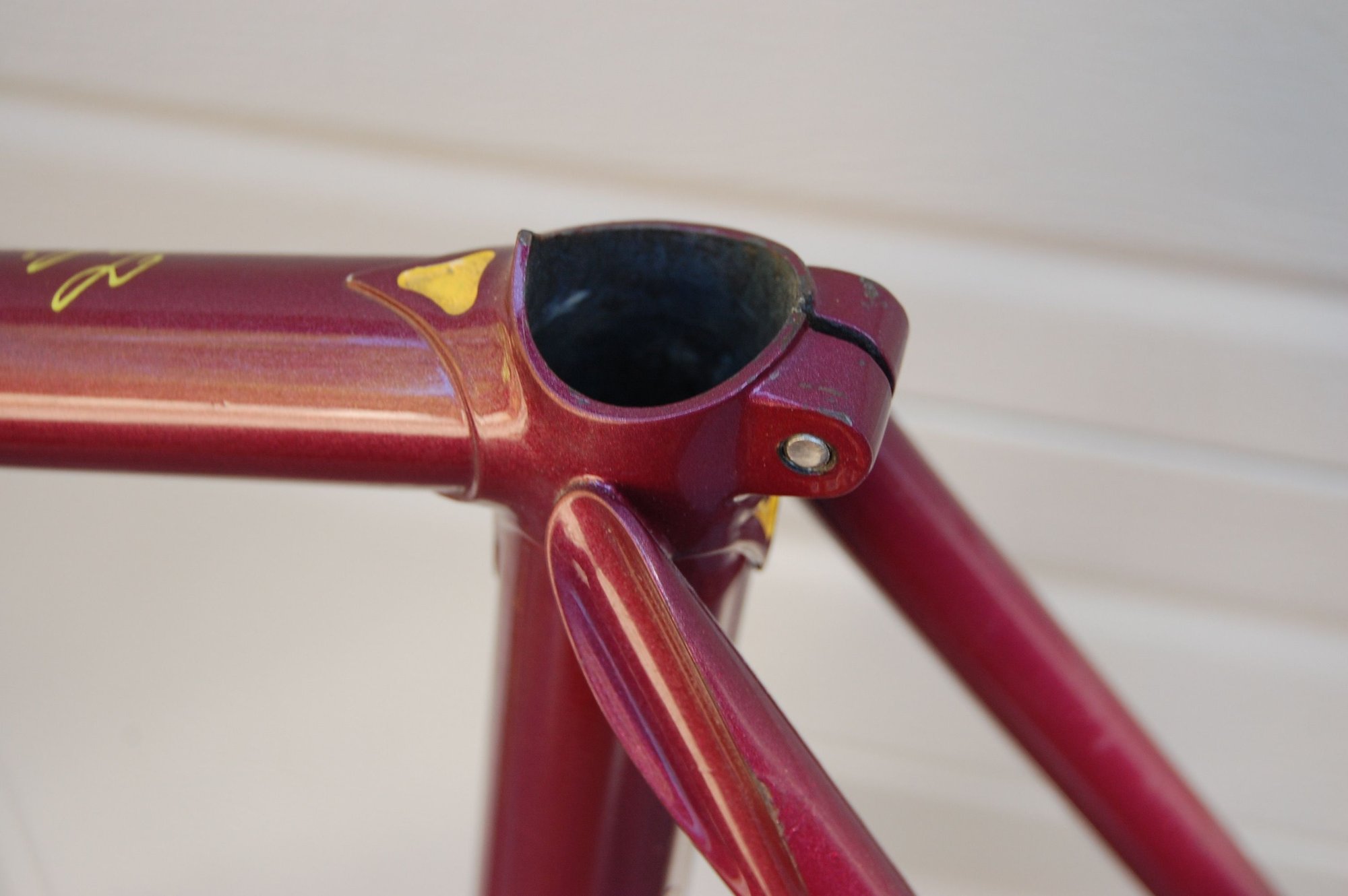

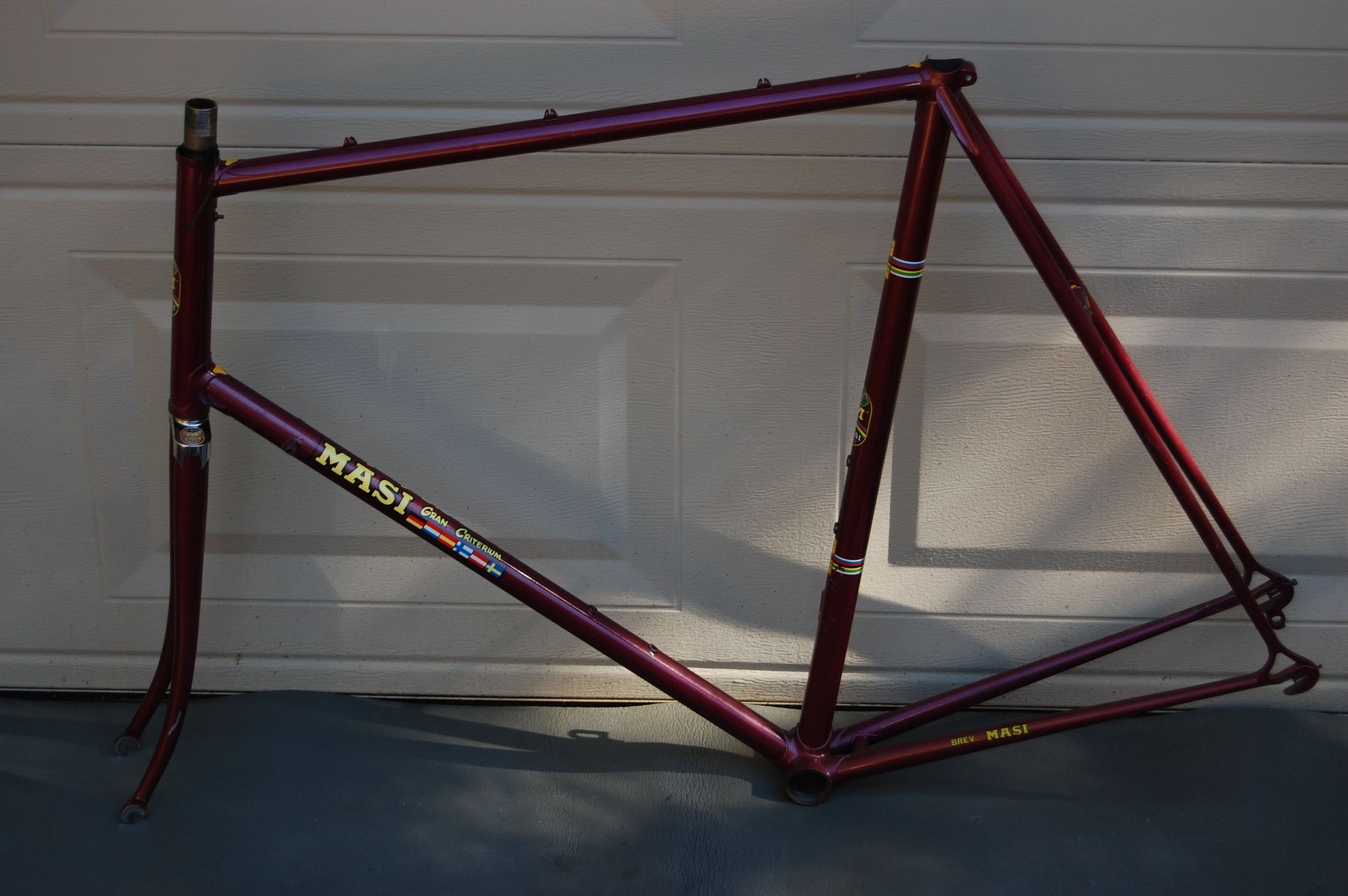

1975 64cm California Masi GC
This is my 1975 64cm Masi GC. I’m it’s 2nd owner. It has a Brian Baylis repaint. I am 6’4” and this frame is too short in the top tube (58cm) and seat tube (62.5cm CTC) for me. I have a custom 350mm titanium seat post with 2-bolt Campagnolo head to give me correct seat height.
I bought this bike from its original owner in 2019 and I have ridden it once since building it in 2020. Due to its short top tube (to me) it feels cramped, even with a 130mm stem.

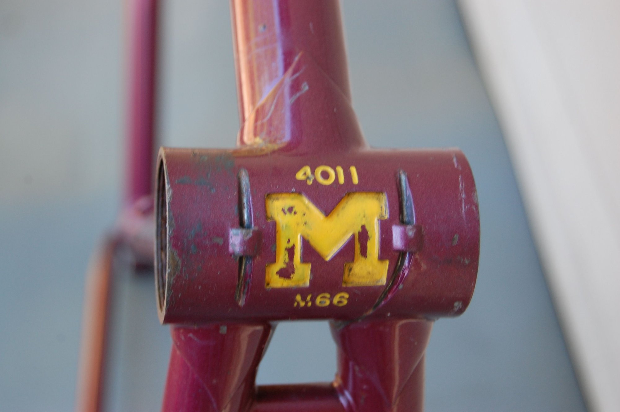

I’ve been approached by the owner of a later, 66cm San Marcos-built GC that was the 11th frame built in 1984, likely by Dave Tesch.
Despite being 9 years newer than my own frame, the 66cm frame is not in as good a shape as mine. It has a small dent in it’s top tube and some paint chipping. I have attached photos the 66cm frame’s owner has sent. It has a 59cm top tube.
We are still hammering out the details, but basically a frame swap is what is proposed. Given that my earlier frame is in better condition it’s likely that the newer frame would require a repaint or at least replacement decals and touch up.
My question is, how much does a “fault” like a dented top tube affect the value of a proposed trade? Thanks in advance for your thoughts!

Dents are value killers. If you are seriously planning to repaint, then that small dent can be repaired. A quality repaint is serious $$. Myself, I avoid repaints even more than dents. If you are just looking for a rider, then discount the trade and go for it! Certainly not an even swap or anything close to it.
Not sure the trade is worth the effort given you are only gaining 1 cm in TT length.

I agree that a dent is a value killer, however , that ding is non structural and hardly noticeable. If you are planning a repaint any way and it would allow you to enjoy riding a bike that you want , then work something out that would make the deal fair. Your 1975 is obviously a more valuable bike even though a repaint and you have a pretty good knowledge of these bikes so I am sure you could come up with a deal that would work. I just had my bike repainted by a good shop (Franklin) and it was less than 600 but with shipping almost 750. It came out beautiful and I can’t wait to ride it. The value of a bike, to me, is what pleasure I get from riding it. I rode my Colnago for almost a year in its patina state and loved it but wanted it to look as nice as it rode. It will not be any different in ride quality but it will make me happy to have it look new, that’s what counts for me. I ain’t in it for $ value.

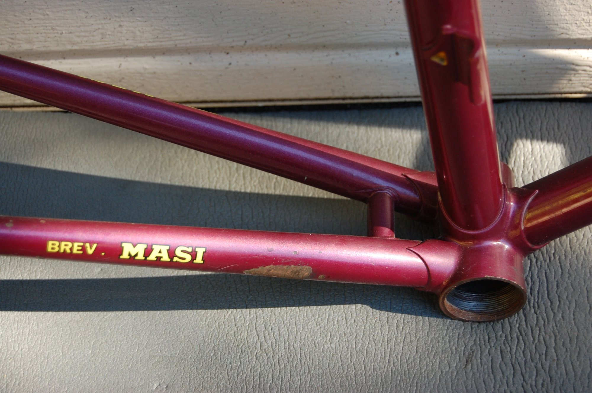

I'd also make sure that rust on the chainstay is just surface.

In most cases a dent ruins it for me unless i was planning a total re-finish. It would bug me every time i rode it . Kinda' harsh, but there are plenty of bikes out there with no dents (in my size that is ---- if you yourself are legitimately having a tough time finding the bike you want in your size, then procuring one with a dent and having it re-finished may be a better option for you

I’d offer that your early Masi frame is worth 2x+ the frame on offer, even without the dent, but opinions differ.
Masi, Wizard, Medici, Appel, DiNucci, Gangl, Tesch, Fuso, Gilmour, Serotta, Davidson, Colian, Trek, Ritchey

Thanks for your thoughts, folks. I have decided to wait on the trade, and try a longer (140mm) stem and perhaps a Maes Bend handlebar to stretch out the cockpit.
The gentleman who pointed out that I’d only gain 1cm in top tube length, you were right on the money! I have 3 frames with 59.5cm top tubes and they are quite good on rides in excess of 30 miles.
And I already have 7 “project” frames that need a paint job and I don’t need another one!
