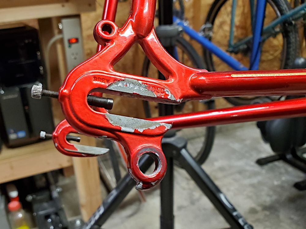

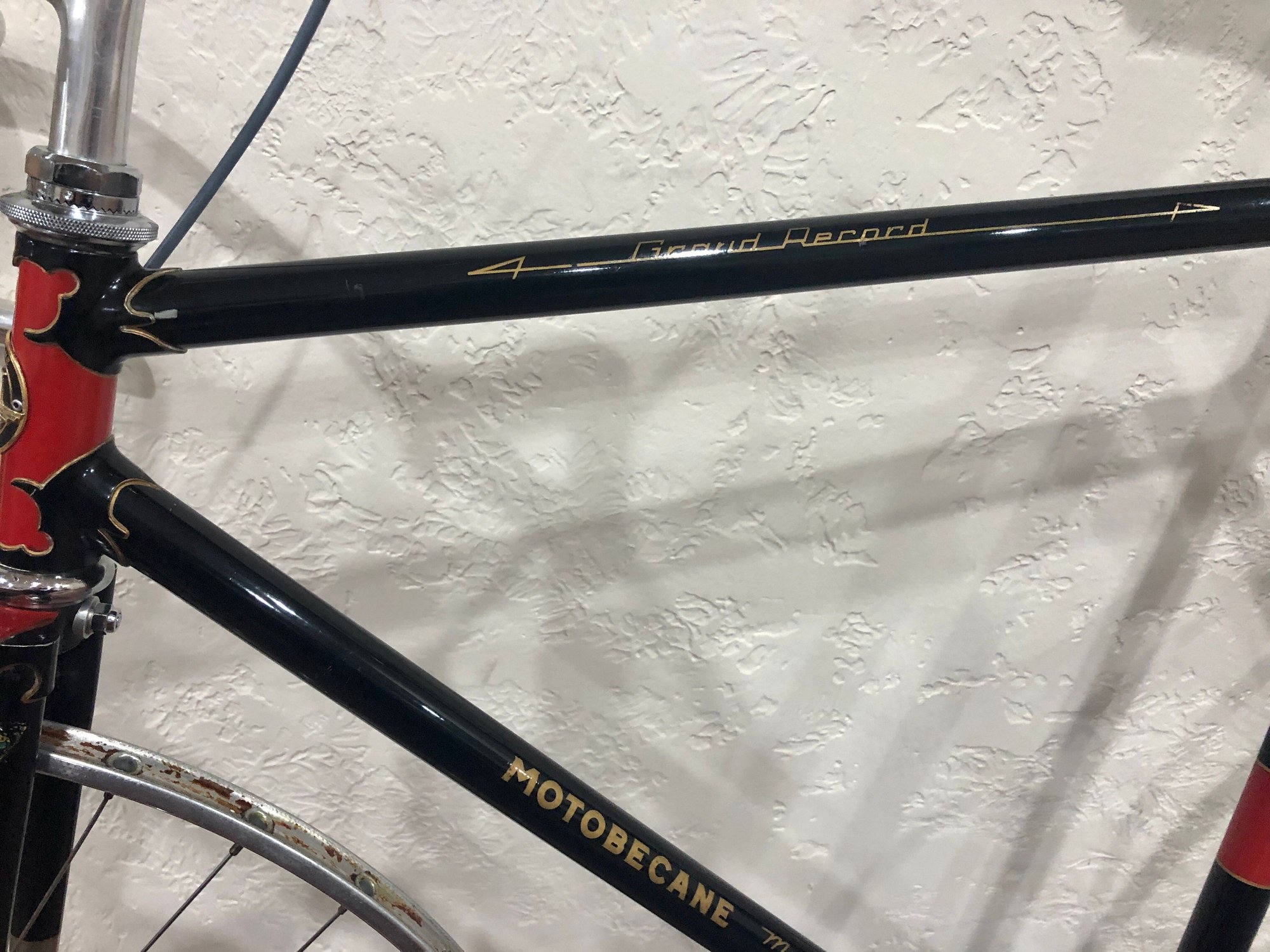

Hey folks, I am starting a build on a '74 Grand Record, in the black/red combination, which is one of my holy grail bikes (along with the orange Team Champion, lilac Le Champion, and red/black Grand Jubile, which I have already). I bought this from the original owner, who kept it remarkably well, and it is for the most part original, with the 3 pin TA crank, Atom 400 pedals, Stronglight competition headset, Brooks Pro with plain alloy tube post, Phillipe bars and stem, NR derailleurs, and the original Normandy Luxe Comp hubs and generic Super Champion tubulars with the dimpled sidewalls....
In the process of rebuilding, I see I have the unique opportunity to do a compare against my '74 Grand Jubile, both are the same frame size 21". This is an early '74 Grand Record, so has the 3 main tubes in 531 (not the seatstays or chain stays). The fork is 531, which I had heard folks say is the only difference between the two frames. In other words, the theory is that the Grand Jubile from that period is but a rebadged Grand Record, with a non-531 fork.
In comparing the two, I was prepared to agree with this theory. On closer examination, however, I noticed the head tube for the GJ was somewhat shorter than that of the GR, despite the seat tube length being identical. I then measured the top tubes on each - the GR was about 21 3/4" C-C, while the GJ was about 22 1/16". The longer tube on the GJ then would account for the shorter head tube, and thus probably has a more relaxed geometry and longer wheelbase. So, it does appear that each frame is actually unique to the model.
For reference:
GR serial number: 2872104
GJ serial number: 2512275
Will keep posting as I proceed...

Looks like a fantastic paint job on your GR. Show me a Peugeot that looks like that.
I've only had one Jubilé, a '79/'80 Vitus 172 frameset. Super nice bike. The chainstays were quite a bit longer than my '75 GR of basically the same size.

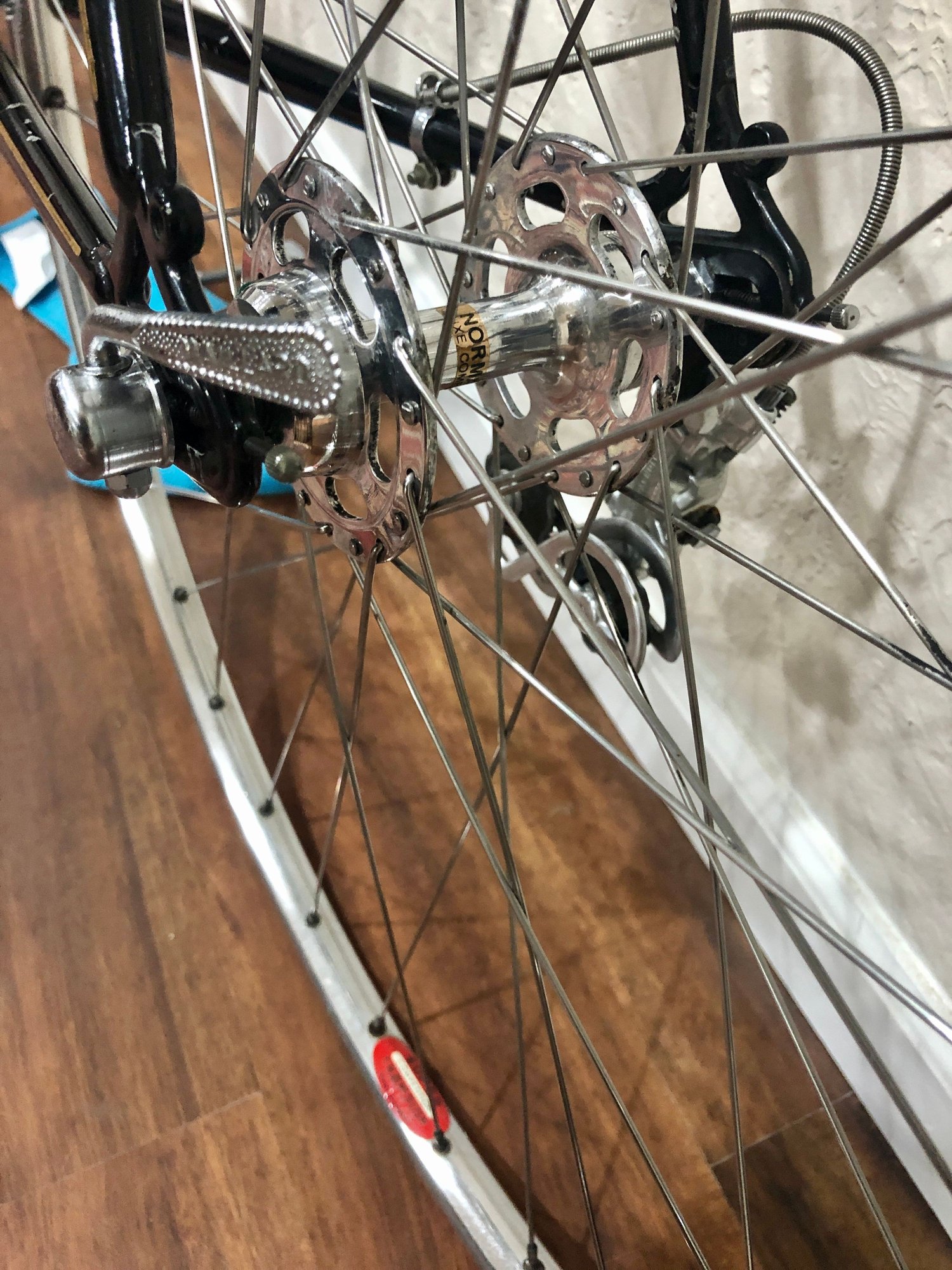

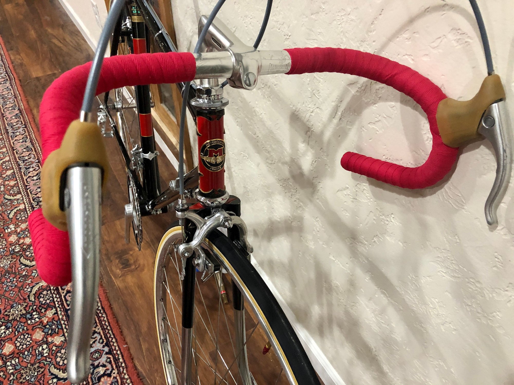

Updates
Getting things back together now... I decided to go with a nice set of Campy brakes, will keep the original Weinmanns in reserve, along with the 3 pin TA, which is really nice, but I will put on a Campy NR....
Original Normandy Luxe Comps were in good shape, minimal wear on the cones...
Original MM Atom skewers
Original Super Champ rims, not marked as any model. They have the textured sidewalls, and are kinda heavy, I think even more than the Arc en Ciels...
Great Phiippe stem and bars, original
'74 NR, original
'74 NR, original

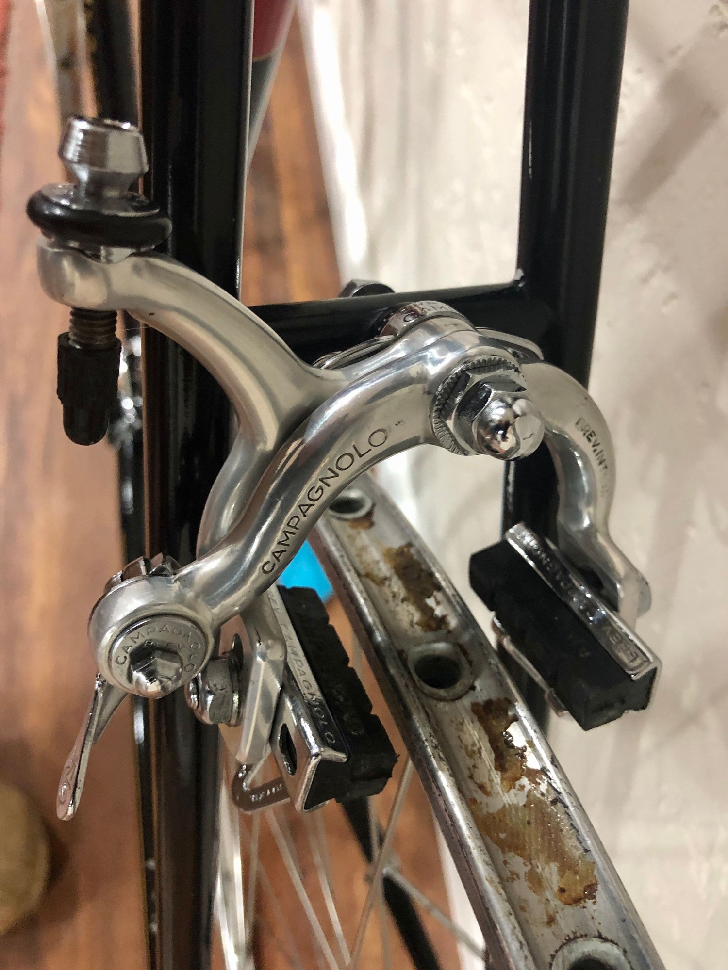

Seeing those calipers reach 700c rims sort of threw me. I always thought the GR came with 27" wheels until later in the '70s. But now I look at the catalog pages, and it shows the '74 and '75 models with 700c rims.
If I used those calipers on my GR, they would not reach. I always thought mine was a '75. Maybe this confirms it's a '76. So confusing!

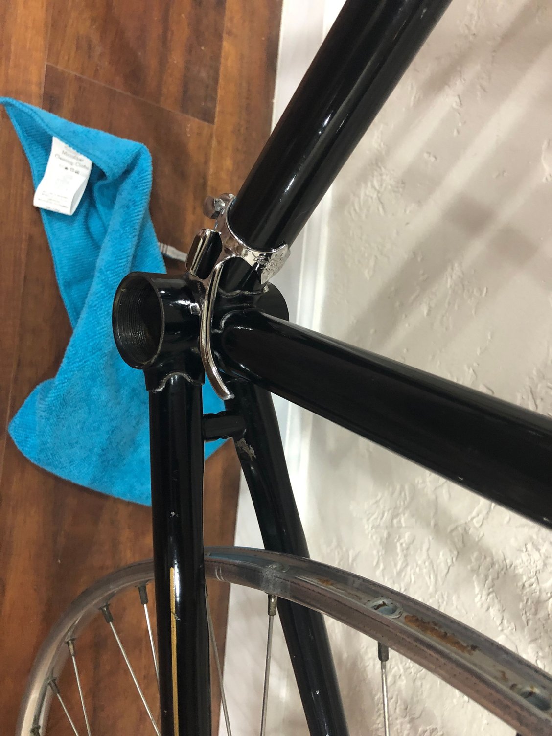

I have owned both a Grand Record and a Grand Jubilee. The Grand Record was a wonderful handling bicycle and the Grand Jubilee was just about as good. Put another way, I would jump at the chance to get either one again for a decent price. This is how I had my Grand Jubilee set up when I was last riding it...
And this is what it looked like when I sold it...

For sure, short reach Campys would not work on this one. I've got standard reach, and they work, but pretty close to the limit! My philosophy on this one is to consider what I would do if I had this bike in the late 70s and what I would upgrade, and that would include upgrades to Campy crank and brakes - it is called Grand "Record" for a reason after all....

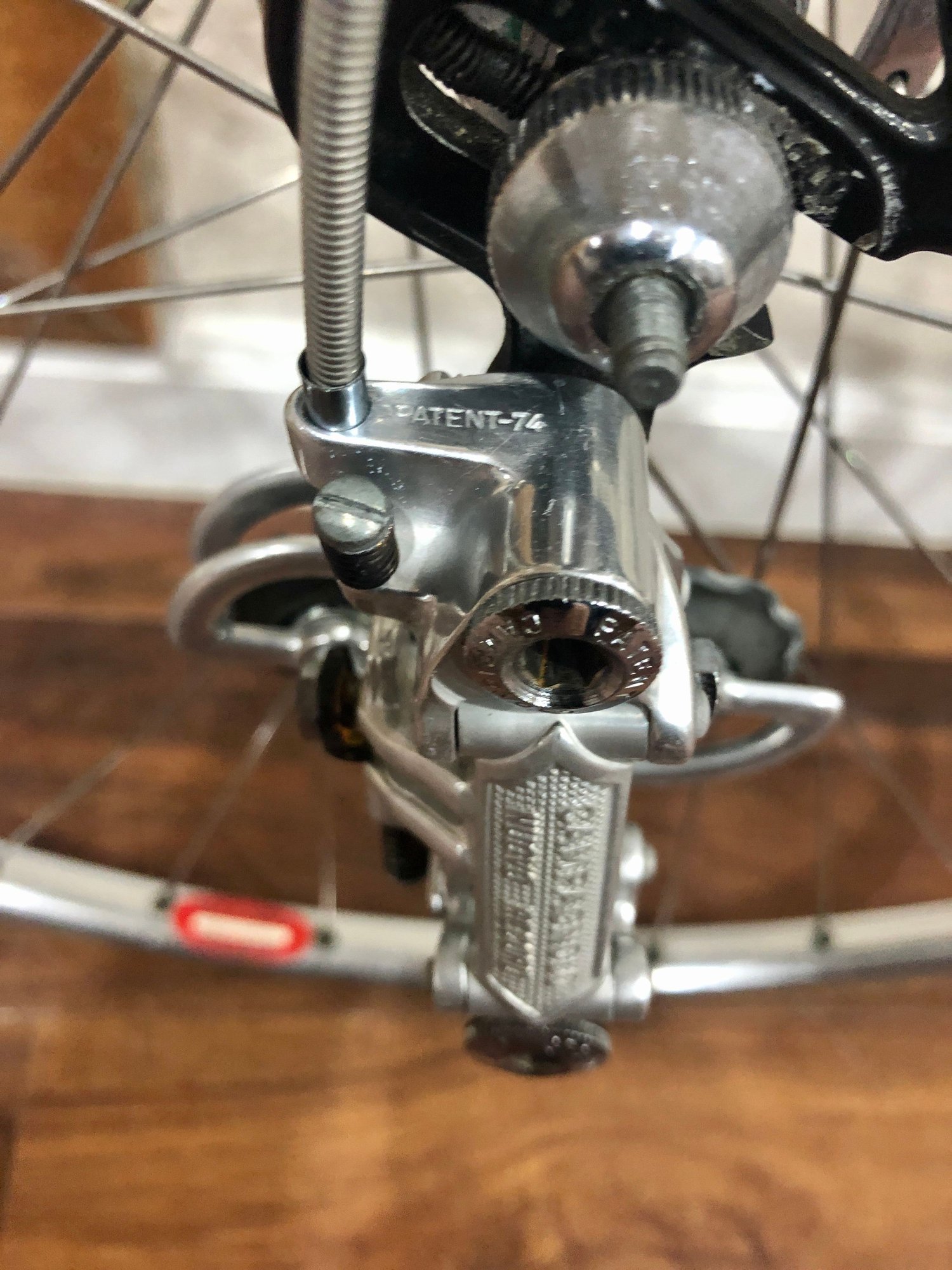

I have a "same" Black/Red GR with same lugs and round headbadge, but mine (which I thought of as either '74 or '75) has the "Full DB 531 throughout" decal, not a "3-mains only" decal.
So never having owned a Grand Jubilee, did these ever come with Huret DOs (to match the RD)?
Or did Lawee always spec a Huret RD that works with Campy DOs? (I understand there is such a version, no?)

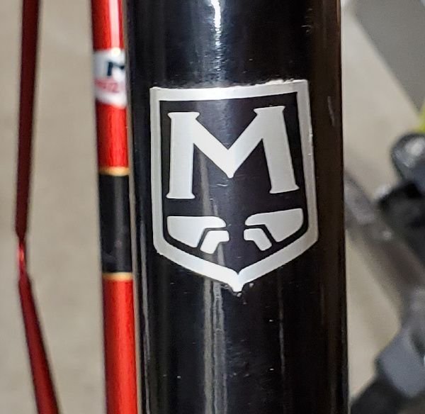

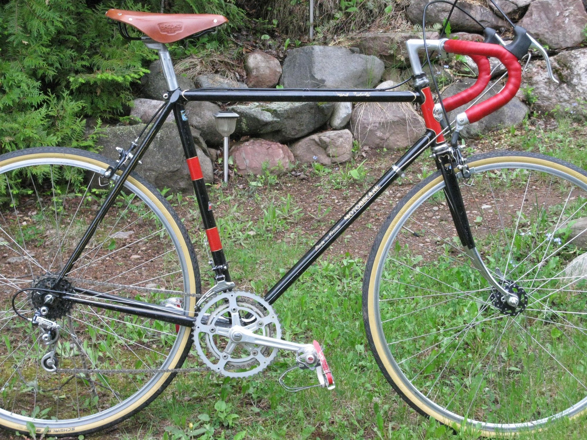

I think a lot of the early Jubiles were made with parts on hand, mostly a mix of Grand Record and Grand Touring.
GJ Serial #1861369
Chrome narrow point crown, script instead of block font on downtube, sticker head badge, campy dropouts
GJ Serial #1861369

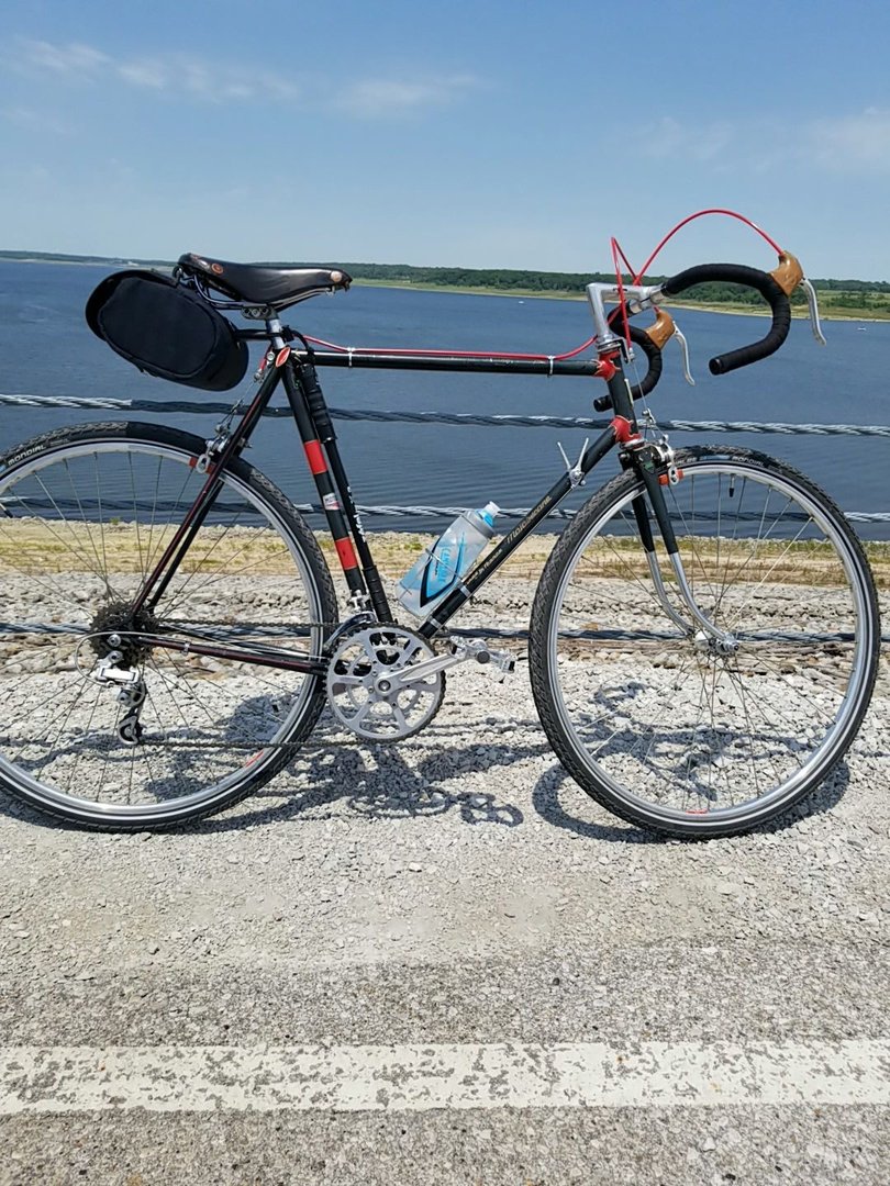

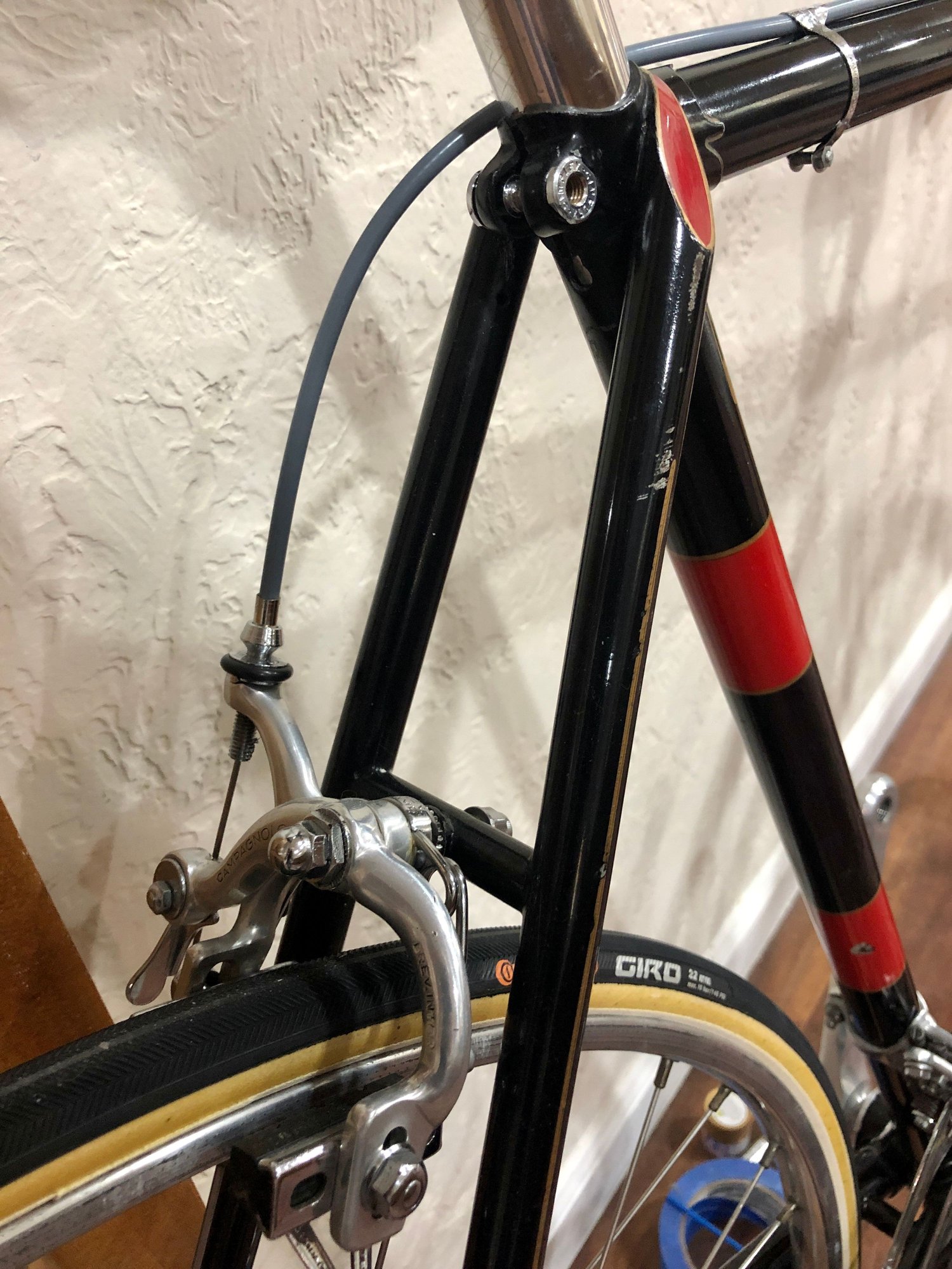

I bought a GR frame last year, it has the black/red paint and I think it's about a 74. I also have a 75 Jubile and a 72 Le Champ. All of these make pretty nice racing-style bikes, or equally nice touring/city riders.
My GR has long brake reach and generous tire clearance in the front, and much less in the rear, which seems kind of weird and limits tire size. But it's so pretty that who cares. I plan to put on a set of 590x40 wheels, rack, and fenders.
The GJ will just barely take 650Bx42 tires and fenders, I rode it that way for a couple years but if I inflated the tires too much they'd rub the stays. 38mm tires would probably work fine.
The GJ & GR (mid-70's) frames show much nicer workmanship than the LC (early 70's) frame, even though the LC is supposedly higher-end. The LC has the most clearance of the 3 frames, ample space for 650Bx42 wheels + fenders. It also has the most laid-back geometry, and IMO is the best-suited for a classic randonneur-style build. The later LC's were totally different.

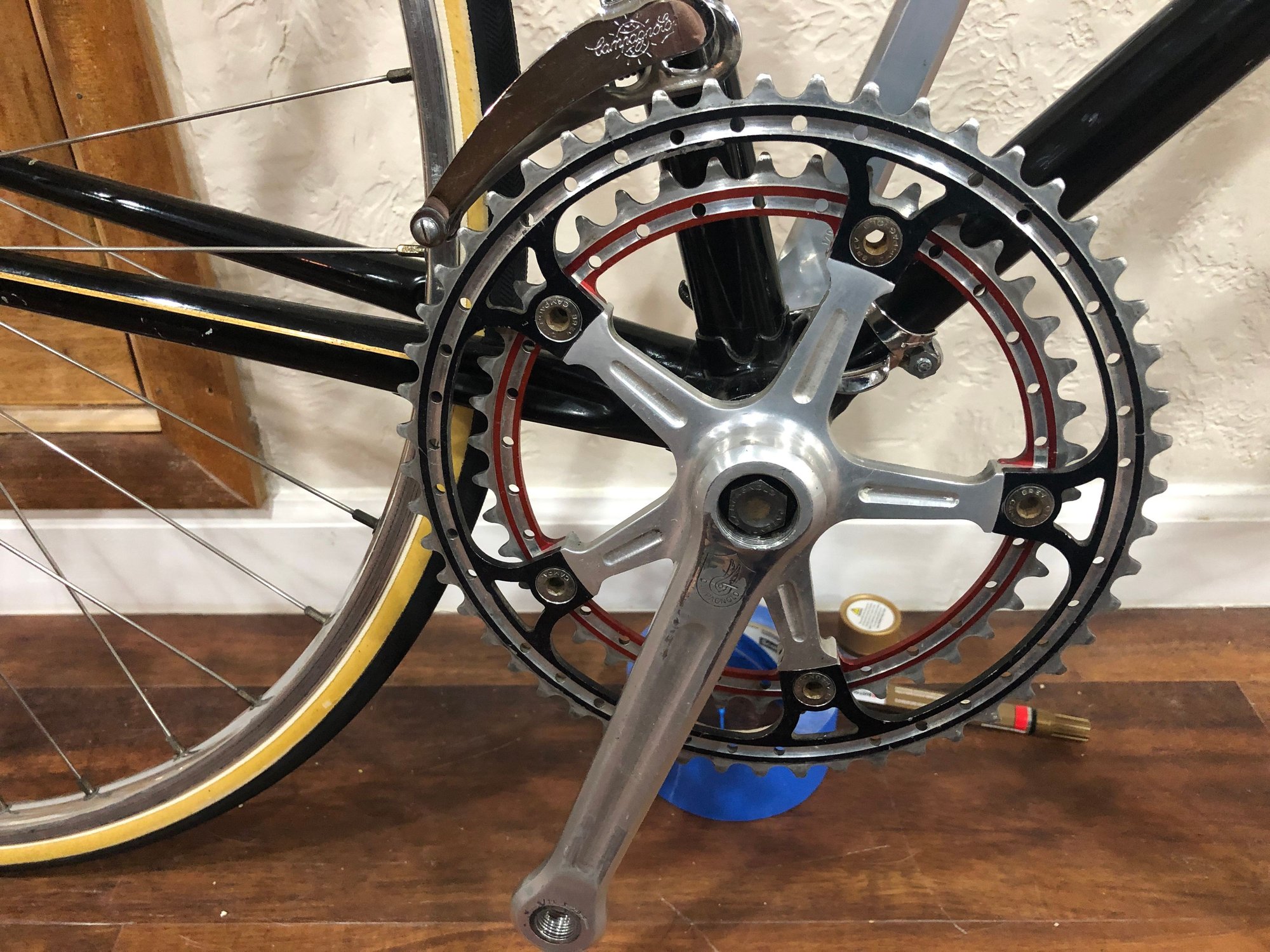

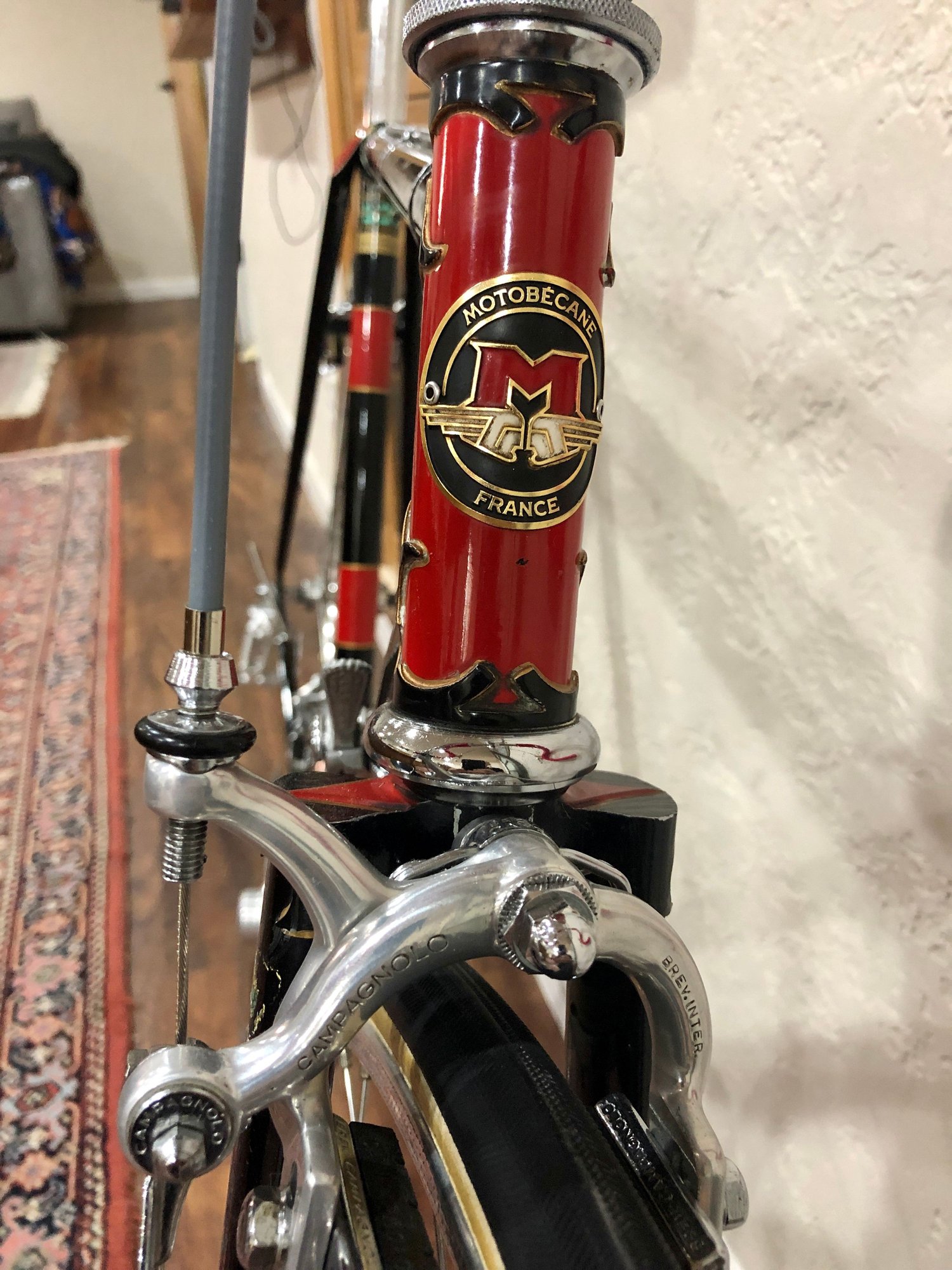

Almost done...
Nearing completion on the GR....
Swapped out the 3 pin original TA for a '73 dated Campy, with black and red Rino rings for the bling factor....
Swapped out the Weinmanns for a nearly pristine set of NR standard reach. They do fit the setups
Original Super Champion tubulars, original Normandy Luxe Comp big flange hubs, and as far as I can tell, original spokes (Robergel maybe?)
Almost there.....
Almost there.....

Don't know how the Rino rings will wear but they do earn some black/red style points! Too bad your Normandy Luxe hubs aren't the ones with red seals, you'd add a few more points (but the gold foil label hubs may be a tick higher in grade, dunno, they certainly are nice spinners so keep them clean and lubed: you cannot replace the races in these). My red/black GR came with the "OEM" Nitto Pearl stem which along with the Brooks saddle, Campy gear and Weinmann brakes are the non-French components but that's a really nice JP stem, IMO.

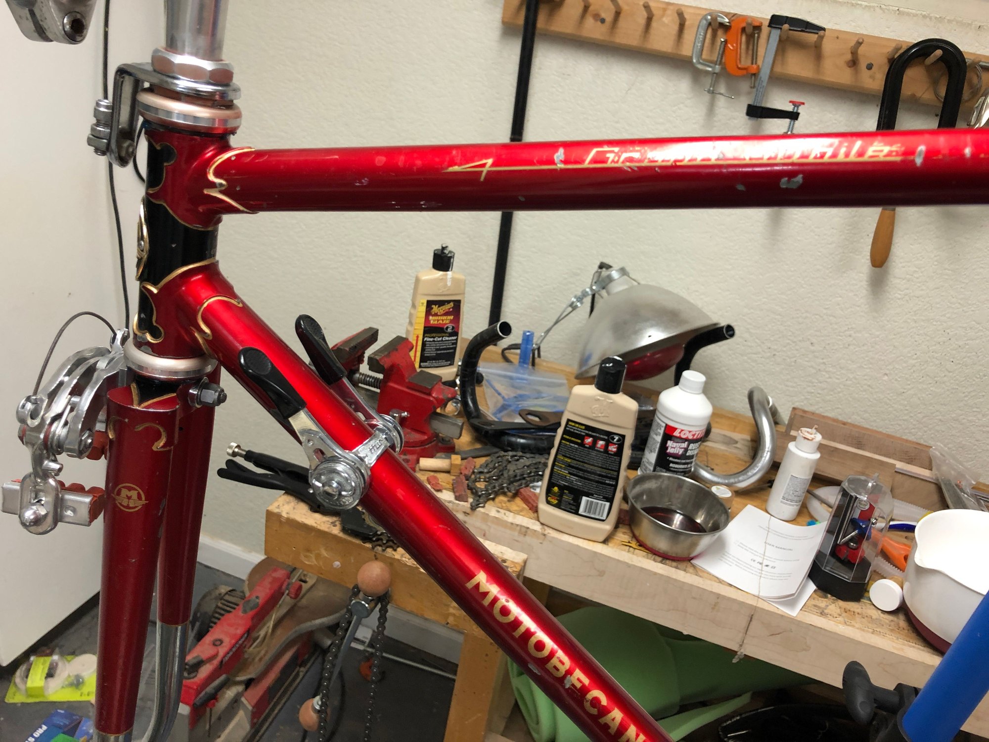

Oh, yes, the black and red Motobecanes!!!
Mom's Grand Jubilee, Vitus. Seat is low for my niece (at the time).
I do have a Grand Touring Mixte (I think). It has a similar shape, but far less refined construction.
