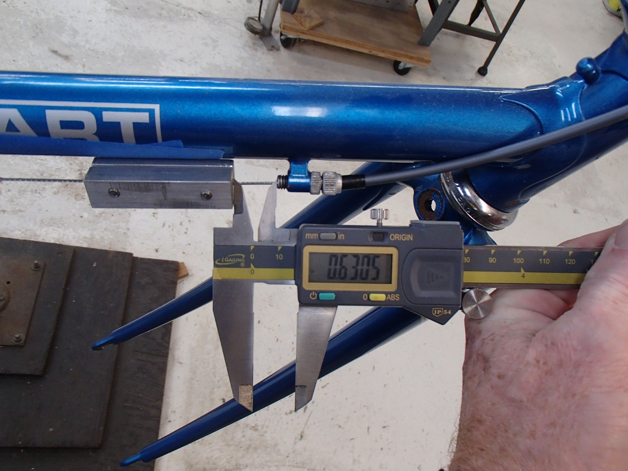

This thread is already many years old and others have gone before me here. I have run mixed drivetrains since the mid 1990s and don't want to move on from my many Campy Ergo (second gen pointy hood versions) levers. But stuff changes over the market cycles of nearly 30 years. It's too bad Campy didn't offer big cog compatible rear ders when it was about 9 or 10 speeds back there. I've thought about this for way too many hours while riding and decided to start some real research in cable pull ratios, guide pulley lateral movement per click and how "incompatible" choices can be made to work. I've been running JTek ShiftMates to translate between Shimano and Campy parts of the system for years too.
With the foundation of actual measuring beats reading I finally decided to make some shifter cable pull and resulting der cage lateral travel measurements and do so with some ease of repeating values and swapping out parts. A fixture was called for. Here's what i came up with.
I've had three different configurations measured and am beginning to see some trends. My measuring technique needs better consistency, Shimano seems to have a narrower range of high and low measurements in general and just because you can read off a scale a thousandth of an inch doesn't mean much in real life drivetrain performance.
The lever's cable pull differences per click for campy averaged nearly twice what the Shimano lever did. And as I expected the cage travel per click was better "controlled" on the Shimano system. No surprises here although I wish the Campy system scored better as I really like the fixed (WRT to shifting) brake lever blade design.
The test rig I did does mimic real bikes largely. I would make a shift to a lower gear at the lever, recycle back down a gear and return to that first shift again then pluck the cable mid point to try to settle all in better before measuring. Friction does seem to make those thousandths of an inch stand out. But the clicks points, and the lever cable travel for each, compared to what the cage was traveling didn't always seem to match up as I thought it would. I blame cable friction here, just like in real life
What do I do next? test more combos I have on hand and include the mixed systems that use a ShiftMate. Refine my technique. Think about lowering the cable friction (in these tests the cable was dry and all sliding contacts were in a liner or casing).
I'll continue exploring with the stuff I have on hand and report back with more info as I find it worthwhile. Andy

Very interesting test setup. What are the actual numbers so far?
is it possible to rig up another dial indicator for the cable travel block? I’m not a big fan of handheld calipers because the repeatability is not great.

I'll have to find the data, but I did a similar thing with Shimano 10sp front shifter. Mostly putting this here as a reminder, it's about time to go back to trying to convert my front shifter from a triple to a quad for the tandem.

Thanks very much for the research, Andy. You're delivering a whole lot of interested future internet people some solid information here. I'm looking forward to your results.

In a past life, if I had your setup to measure what you're measuring, I'd have done a Gage R&R Study. No doubt Shimano and Campy use GR&R or GR&R-type studies to monitor their measurement systems that guide the manufacturing processes used to make the derailleurs/shifters your measuring.
GR&R is a very organized, objective way to determine whether your measurement system is capable of reliably measuring, in this case, derailleur movement or cable pull. It can also be used to identify what, i.e. cable pull, your measurement system can reliably measure. For example, using arbitrary numbers, if a measurement system is determined to be incapable of reliably measuring 3mm of movement, you can use the results of the study to determine the measurement system is capable of reliably measuring 10mm of movement. Another example..if someone needs an accurate determination of, say +/- 0.01mm on a 15mm(target) steel rod diameter, a metric tape measure would be an incapable measurement system while a micrometer would be a capable measurement system.
All that said, a good GR&R study can be a fair amount of work. In a precision production environment, it's a great investment. It would certainly apply to your study, if you want to dive in.
Off the top of my head a couple thoughts.
1. I'd use new cables, if you're not already, just to eliminate any measurement variation noise added by worn, or less than ideal, cables.
2. New shifters would (probably) lower the measurement noise, but wouldn't be practical for what you're doing. I would use the same shifters for all measurements within a study and make sure they are in good condition and lubricated as needed.
3. You seem to be measuring cable pull through the rear derailleur body. I'd think the der body would add random noise to your measurements and degrade your results. It may be useful to measure rear cable pull by measuring the cable movement itself. You could also measure the same cable-pull der movement as you have setup now. In an ideal world they'd be the same, or the same within some consistent scalar amount. A comparison of the two sets of data would tell you how much noise measuring through the der adds. A new versus used der movement would be another study to give you an idea how much influence the der is having on your results.
4. Make sure you use averages for each measurement and not single points. Each data point for each shift-movement should be at least an average of 3 measurements. A better estimate of the true movement would be 10 measurements of each shift-movement. The estimate of the true shift-movement by averaging say 5 measurements isn't (statistically) any better than averaging three points. You need 10 determinations to get a better estimate than averaging 3.
5. It would be time well spent to just take a bunch of measurements (I'd do 10 each for the time being) of shift-movements and determine the average and standard deviation. Then divide the standard deviation by the average and see where you're at. Again, random numbers, if you have an average of 10mm with a std dev of 3.2mm then you have a relative std dev of 32%. Ouch.. If you compare the ave, std dev, and relative std dev of two adjacent shifts you may get some indication of how capable your measurement system is in measuring shift movements. There's more statistics that can be applied to this, but start small first.
6. It's worth the time to sit down and write out exactly the goal of your study(s) and what measurements you'll do to gather your data. It'll help keep you on track and it'll be easier to identify when you stray from goal or process.
Even "simple" studies can get quite complicated.
I think you're on the (critical) right track at the moment as you're asking "what am I trying to do?". If your not sure where you're going then any path will get you there.

Just yesterday I approved a PPAP for a high volume part with a Cpk > 5 on a 0.008 mm wide tolerance band. Admittedly that's the highest Cpk I've actually seen in the wild, but if you understand the significance of that you'll also understand that it requires excellent process control, and a very consistent measurement system, to achieve.
1. While I did throw some snark in there, basic calibration should always be done if you're to the point of an R&R.
2. Throwing in some more snark, a gage R is probably more relevant than an R&R unless you expect the OP to conscript 2 friends for this study.
3. My main point was more about appropriate levels of effort for the task at hand. The OP has already concluded that his measurement technique needs improvement. An inspection of the measurement system is a lot of work to confirm what has already been concluded. A lot of time some common sense will tell you if your measurement system is sufficient without the rigor of a full study. Other than the gage R&R part, the rest of the post seems to be good relevant advice.
4. Assuming that a lower force indicator is not available, stiffening the system up and measuring closer to the attachment points would help. At first glance the setup through the rear dropout looks stiffer than the plate attached to the derailer. I'd set the indicator up to measure directly off of the inner cage plate at the pivot.
5. Sprocket spacing is probably a published value, and can be easily determined by measuring a cassette off the bike. Ideal lateral derailer movement should match this value, so we know the target as well.
Knowing cable pull and knowing derailer movement aren't quite the same. I'd expect the derailer to have equal movement per shift from one end of the range to the other. I would expect cable movement per shift to vary slightly to account for the change derailer geometry through the range.
I'd measure cable pull as close as possible to the shifter. Taking it right at the downtube is a good start. When I did it I clamped the handlebars to a bench (granite surface plate in my case), put a pulley and weight on the cable end, and measured travel right near the cable. This removes the housing, and associated error, from the system.

icemilkcoffee- I agree about hand help calipers not being very repeatable in measured numbers.
When I started to figure out how I would do this I did consider using a dial on the cable pull measurement, the 2" dial was bought for this and I fitted a flat back to allow a closer positioning to the down tube, so the indicator point might hit the cable block tight to the cable. One issue with the cable block is that the cable will sag down just under the weight of the block. To add an off center pressure (the indicator point) would increase this and result in more deflection to the cable measurement. I had hoped that a longer cable block would reduce the sag (and as I write this I realize that rotating bike so the cable is vertical would eliminate this. Oh, how the creative process works...)
I mentioned technique. In the 5 tests I've done I saw some changes of values dependent on how I cycled through the shifting range. Quickly I decided to "standardize" my technique to have any real ability to compare or extrapolate from. The two initial test runs I discarded as being relevant to the system design and about learning how to work the set up. This will evolve. Andy

One more note, it looks like my first pass at determining cable pull per shift was repeatable within +/- 0.05 mm (0.002") across 5 runs. The instrument I was using has sub micron repeatability, so the variation was all my setup and the front shifter. The upshift data was noisier than the downshift data.
Something I have not seen in this thread is an idea of how close is close enough. +/- 0.1" is likely too coarse, and the 2 nm flatness of our interferometer calibration artifact is likely not needed.
The rear derailer adjustment screws I've measured have all been M5x0.8, and the smallest adjustment range is 1/8 turn, which equates to 0.1 mm as the smallest adjustment. A single detent of adjustment doesn't make much difference, so I'll argue anything under half of that is good enough for what we're doing. Parenthood has thrown that particular project on the back burner, so I probably won't have more data any time soon.

Yet another “one more note”. I also found more variability in position than I wanted as I was setting up my experiment, and concluded making sure everything in the shifter was seated would help.
In your case, after you orient the bike so that cable section is vertical, you might also secure some weight to the cable somewhere downstream. This will help over-ride friction in the system.

All valid experiments should be repeatable, so I went ahead and threw something together to try to validate your numbers. It wasn't nearly as robust a setup as my previous measurements (fastened to a granite surface plate, no housing sections to compress, a weight on the other end of the cable, etc. I don't have any 9sp shifters other than the ones on my bikes, but the results still seem reasonable.
The setup:
Some observations:
1. I should have flipped the indicator around the other way, as you did.
2. Putting the jog on the indicator tip rather than the item attached to the cable prevents the cable from being being displaced as much by the force of the indicator. I haven't done the math to see how much this influences the results, but my guess is not much.
3. The 1-2-3 block secured to the water bottle mount on this frame is NOT a particularly rigid method of attachment, mostly because the bosses are not flat on this frame. It does however work for a quick setup, and I'm not planning to re-use it as you are.
4. I could introduce a full mm of movement by greatly increasing cable tension by hand. All of it appears to be in the housing run from the shifter to the downtube stops. I was a bit surprised simply because I have no shifting issues whatsoever on this bike.
Results next post.
The setup:
Some observations:
Results next post.

Ok, now the interesting part.
1. My upshift (cable release) results were much more consistent than my downshift (cable pull at the shifter) results, so I used those.
2. This is done on a 1st gen (silver caps, 2000ish?) 9sp Ultegra STI shifter in sub-par condition.
3. This plot is cable pull between sprockets, so there are only 8 entries for the 9 speeds.
4. My 2 results are in red. Your 2 results are in blue (from your data in post #20).
5. I defined #1 as the large sprocket in the back and #9 as the small one (11 tooth in my case). I think we numbered our data in opposite directions. If this is not the case, then something is off, so please point it out if so.
6. In general our results are very similar. The end values are very different. This makes sense as those positions are controlled by the derailer limit screws, not by the shifters themselves.
7. As suspected, the cable pull per shift is not constant. We know (or at least I strongly suspect) that the sprocket to sprocket spacing is constant, so as a result you can expect derailer ratio to change through its full travel.
