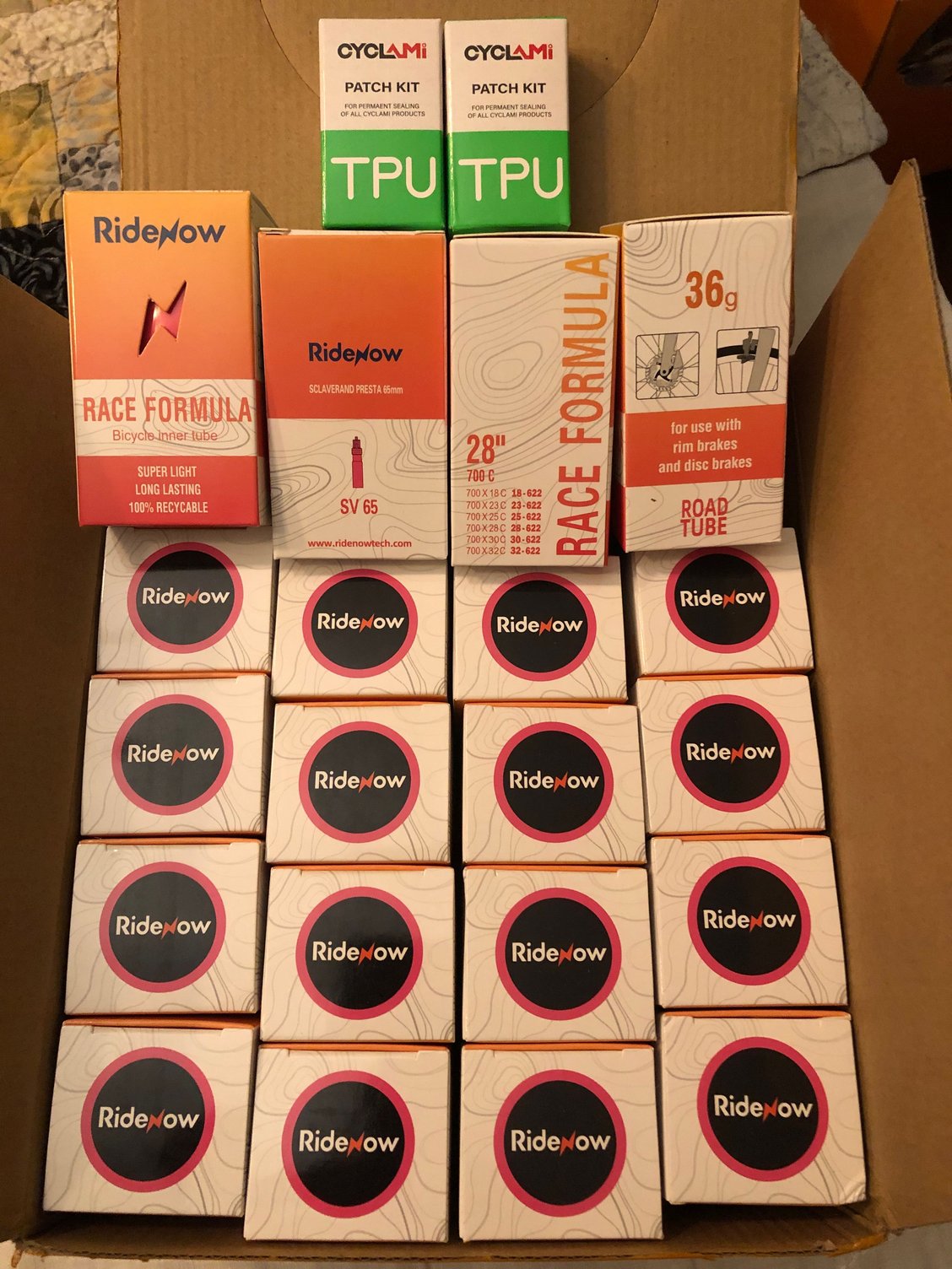

2 of my friends tried tubeless but switched back to tube……TPU tubes. Here in the SGV area of SoCal there are plenty of potholes and road debris.

My order of 20 Ridenow TPU tubes arrived yesterday. It was $142.56 for 20 tubes and 2 patch kits so about $7/tube. It arrived in 8 days with free shipping from a seller on Aliexpress. My friends want to try them so I ordered for them.
3 tubes and a Park GP-2 patch kit (which supposedly works according to a poster in another TPU thread on this forum) weigh the same as the butyl tube I carry in my saddle bag.
