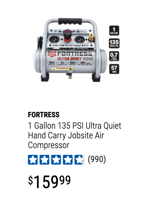

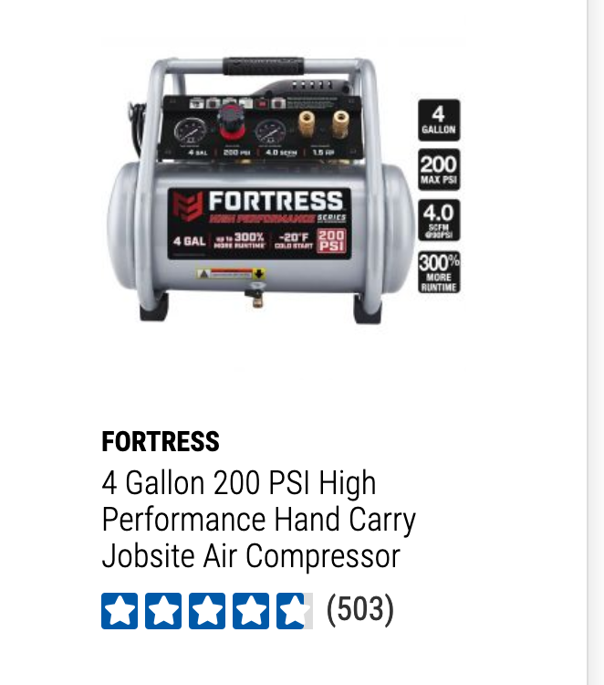

That makes me feel better about my canister floor pump. ha-ha
How many gallons and what psi will your air compressor do? I know some of the tiny compressors only go to 135psi. I tried seating my tires with less than 150psi it did not work so well.
this one might struggle on some tires
this one should be a lot better than a canister floor pump
