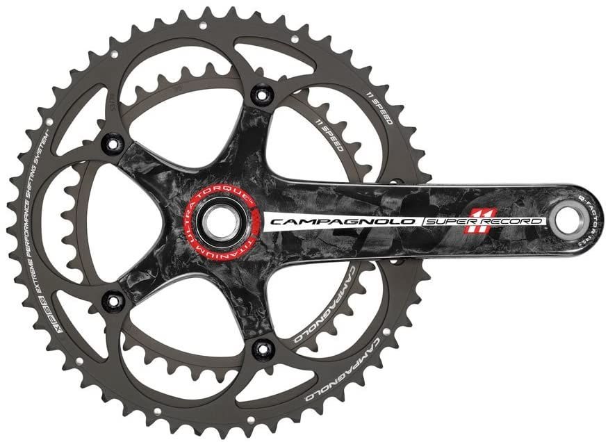

The Campagnolo carbon Super Record crankset of the picture (with "Ultra Torque System" and "11" written in white) is the one with steel axle.
There is another one with a titanium axle that weight less (with "Titanium Ultra Torque" and "11" written in white on a red background).
Steel axle Super Record crankset:
Titanium Axle Super Record:
Jipe is offline

Now that Campagnolo moved to 12s, this gorgeous 11s crankset can be found at discount price.
Chainrings are 5 arms BCD 135.
For two chainrings, the XPSS system of Campagnolo provide excellent shifting.
