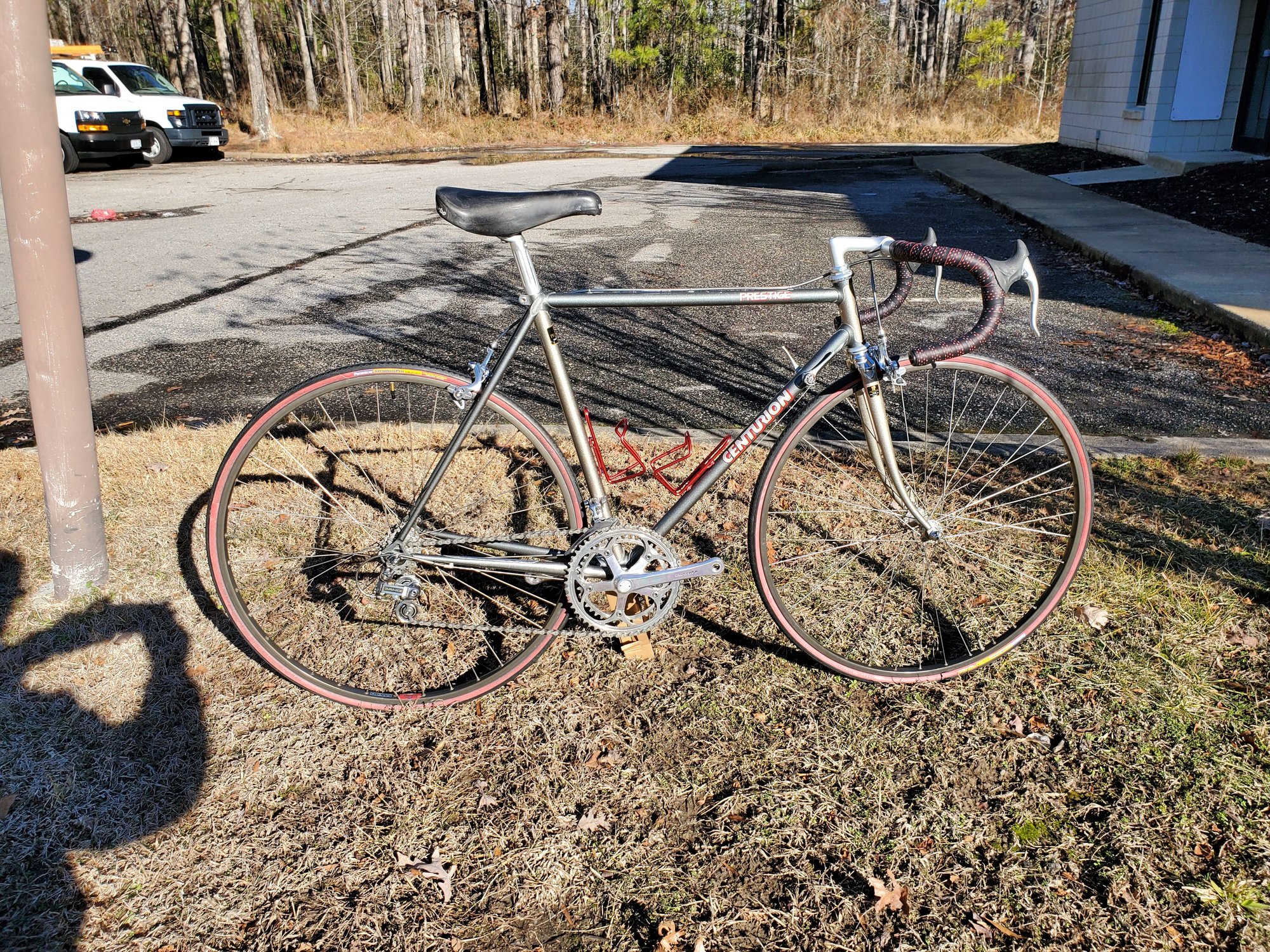

Originally Posted by seypat
As found.
The first really quality bike I ever saw. My mid-1980s grail bike, before I even knew what a grail bike was.
smd4 is offline
As it is currently.
As it is currently.
Beautiful. The two-tone paint job back in the day was very high-quality. Centurion always took pride in their finishes.
smd4 is offline

Ja KrazyMB's from Velospace: 1993 Novaro Team
Davidson Impulse
