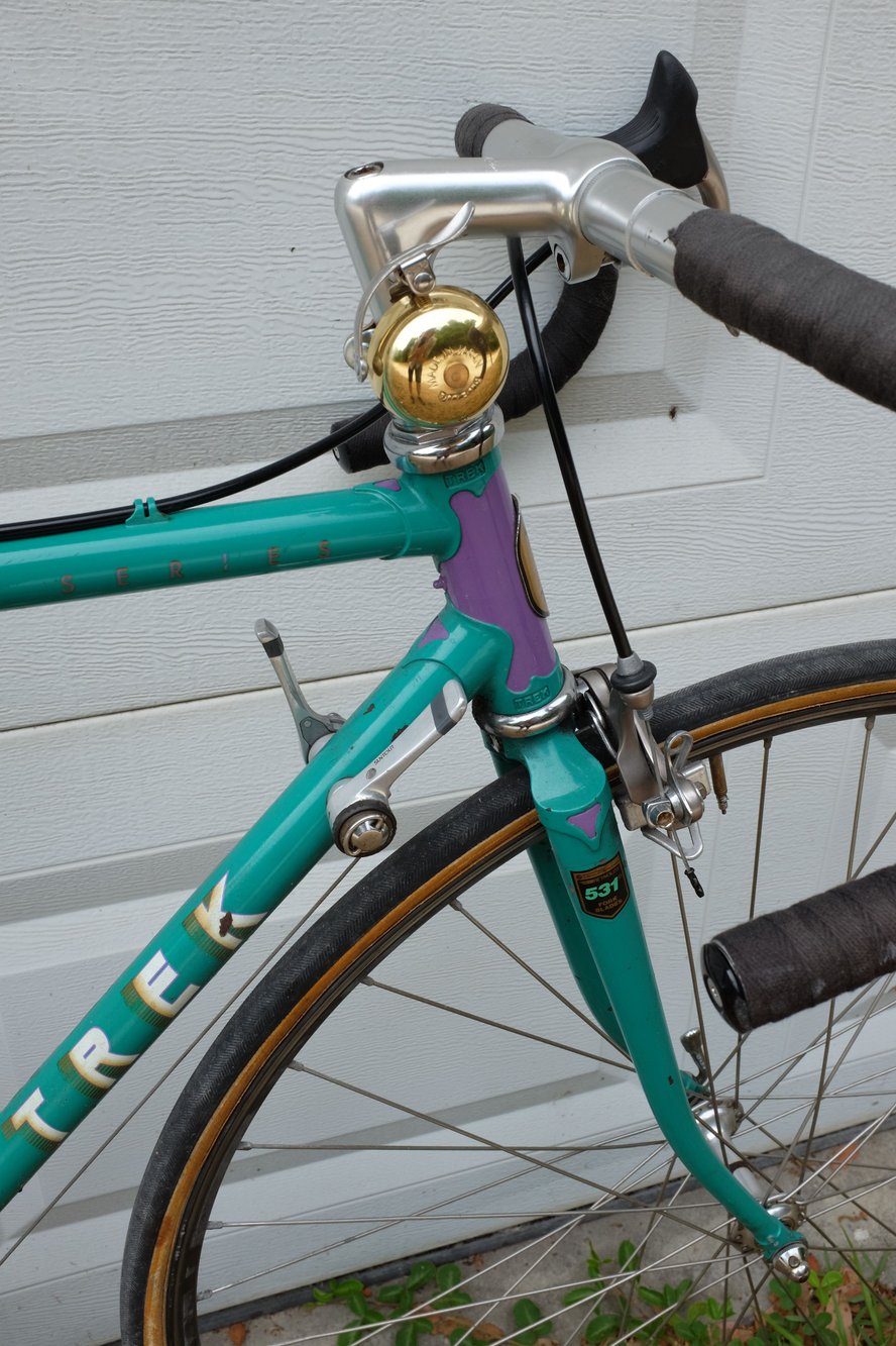

Just bought my first vintage road bike! 1986 Trek 760
Although I have bought vintage bikes in the past to fix for friends or flip, this is the first vintage road bike that I have bought just for myself (the '84/'85 Trek 770 with the damaged frame from another post doesn't count). Saw this on FB marketplace a few days ago and it immediately caught my eye, even more so after seeing the price of $250. I convinced the seller to hold onto it a few days until I could make the hour and a half drive to come and look at it. Not sure why, but he insisted that this was an '89, that someone had painted the head tube and lug cutouts. Not one to argue, I looked it over and decided not to try and haggle the price, even though in the ad he stated that the price was negotiable. From what I've been able to find out so far, most of the components are original- Specialized 52/42 crank, Suntour Superbe Pro derailleurs, Suntour Sprint shift levers, and DiaCompe Royal Compe brakes. The wheels have been replaced with unknown tubular rims laced to Campagnolo Record hubs, stem and handlebars are Cinelli, the saddle is a very clean Brooks C-15, and the pedals appear to be some random/cheap ("Performance" written on the outside). As an added bonus he even threw in a pair of new tubulars to go along with it, probable because the current ones are showing signs of age.
Took it on a quick 15 mile ride this afternoon after getting back home, and I couldn't be any happier right now. The downtube shifters are going to take a little getting used to; I figured that since I run bar end shifters on my touring bike it would be pretty much the same thing, but it is definitely a bit different than that. Not sure about the tubular tires, but since most of my rides around here are on protected paths, I probably needn't worry about a flat 30 miles out. Was also not sure about the cloth tape, but I found that I actually enjoy the feel much more than the thick cushioned tape that I run on my tourer.
Although most of the components are correct, I'm thinking about possibly installing the Super Record groupset that came off the 770 that I picked up last month. I'm sure some of you will say "it's your bike, do what you want," but I'm curious what kind of difference going from the existing setup to the S.R. would make. Anyone have any thoughts on this?
I guess I'm just excited about my new addition, and wanted to share it with those who appreciate the beauty of these older bicycles, and who have also helped educate me over the last few years through their sharing of knowledge on this site. Cheers!

Great bike, great components, great paint, great condition. What more can you ask for?
As far as changing groupsets around, you almost certainly won't notice much of a difference. Except perhaps shifting quality. But a corn cob freewheel and 52/42 chainrings are easy to shift with just about anything...so even there it won't be that big of a difference probably.

Not trying to rain on yer parade, but that color scheme was used for the 1985 760 models. However a lot of those were sold as frame only items. They were factory equipped with Suntour Suberbe drive train and Sprint or Modolo brakes. Even so the frames were identical for both the 760 and 770. The difference was the paint scheme as 770 was often yellow and blue decals. I still think you have a great riding bike as I owned one of each model and they rode the same. Smiles, MH

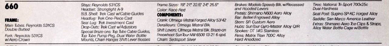

Not trying to argue with anyone's knowledge here, but here is what I found from vintage-trek that I was going by.
1986 Catalog screenshots:
The green with lavender headtube certainly look correct, and the crank/derailleurs/brakes are the same as my bike.
The 1985 catalog:
Obviously the color on the '85 760 is not even close, however the 670 is similar, minus the lavender headtube; perhaps that's you were thinking about?
Again, I'm not trying to argue, just pointing out the sources that led me to the conclusion that it is a 1986 year model.
Interestingly enough, the serial is 203035, which according to vintage-trek, puts it as a 660 in 1985. I guess I'm just confused by fact that the paint, decals, and groupset match up exactly to what the 760 in 1986 shows in the Trek catalog for that year. Who knows, maybe someone spent a lot of time and money making an '85 660 look just like an '86 760.

Originally Posted by trainman999
jbz255 if you look at the 85 660 frame specs and the 86 760 they are the same. last yeare leftover 660 frame painted this year as a 760. notice there is no 660 in 86
I'm confused by what you said, maybe I'm not looking at the same specs as you?
'85 660 specs:
'86 760 specs:

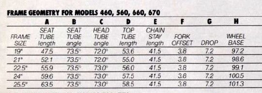

Are you referring to the frame geometry? Looking at that, I think I see what you are talking about, the '85 660 and '86 760 have matching specs, except the fork offset and wheelbase; that would be due to using a different fork, yet same frame I'm assuming? Thanks for that info, that clears up my confusion about the serial number!
'85 Frame Geometry
'86 Frame Geometry

Looks nice, but I'm not convinced that it's a 760 frame. The one-piece cast head tube was not used on the 7nn series frames (at least not when I was at Trek 1980-86), but the fork with the Cinelli crown would have been appropriate for a 760 frame -- but the sloping Cinelli crown fork had been replaced by a flat Tange "trident" crown by the time the Trek cast, socketed dropouts went into production.
I suspect that what you have is a chimera of sorts; a 560 or 660 mid-80s frame matched with a 760 early 80s fork. Do you have a serial number that can be checked against the database at Vintage Trek?

The serial number of 203035 puts it in the 1985 21" 660 range. Again a great riding frame and equal to all of the frames that came out of the factory back then. Smiles, MH

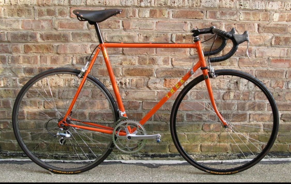

My ‘85 670, along with my ‘85 600, are some of the nicest riders ever. The 670 is the same color as yours (absent the painted head tube). Despite not really needing both, I keep hesitating to let either go.
