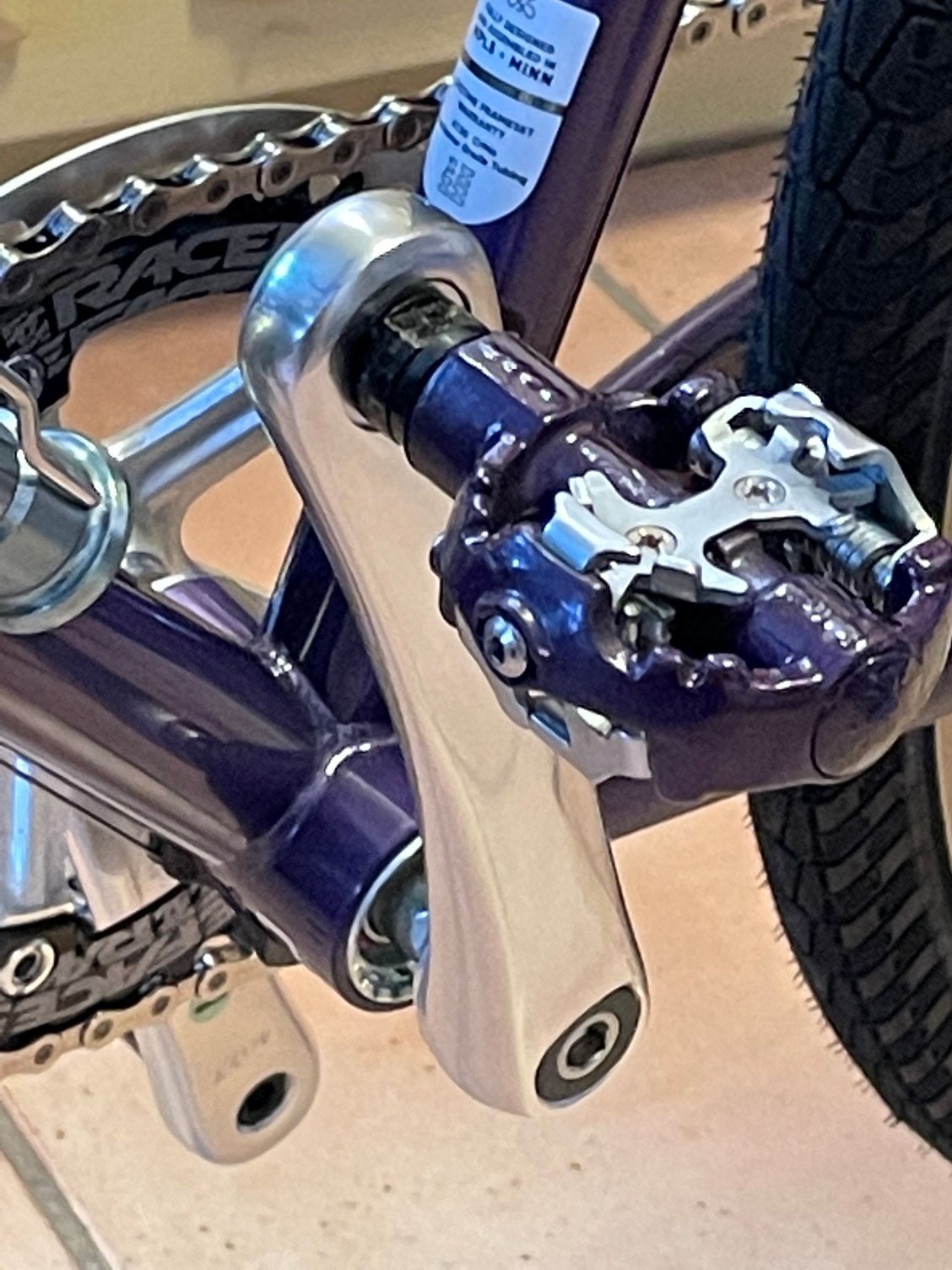

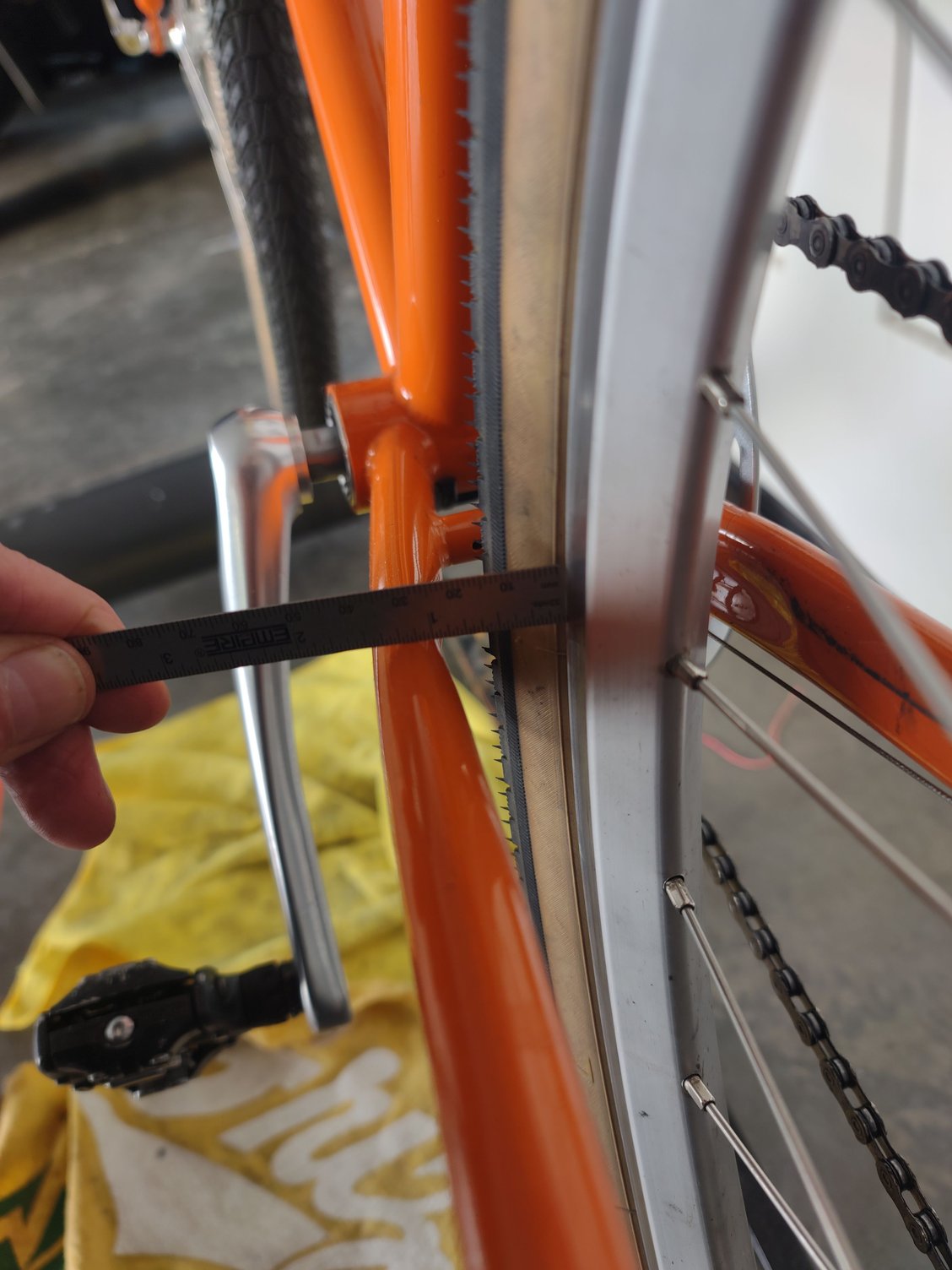

Either the crank or bottom bracket has shifted. There never was much clearance but now there is zero between the chain stay and chain ring. Handsome says they have not seen that before and one set up like mine in their shop is close but not nicking the paint.
jadmt is offline
Likes For jadmt:
Old 11-15-22, 06:27 PM
  #287
beicster
Location: Berea, KY
Posts: 1,027
Quoted: 316 Post(s)
Liked 203 Times in 139 Posts
Did you tighten the crank down before this happened? Have you checked to see if the non drive side crank has moved further away from the chainstay?
No and non drive side has more clearance but don't know if it always has been that way. I just installed a new chain and noticed there was no gap at the stay
Is there any extra drag when you spin the crank? I can't imagine that the bottom bracket spindle could shift without there being an issue with drag. I would probably tap on the non drive side crank with a rubber mallet where it attaches to the bottom bracket to see if it shifts any. Also, does it rub on the full circumference of the chain ring or just in a spot? Could you have bent the ring?
it is all the way around, it is a narrow wide chainring and every fat tooth rubs, the chainring is not bent. Handsome is sending a new bb and crankset and i will send the old ones back.
I am glad they are making good on it. Let us know what it looks like when you take the old one out.

Liked 299 Times in 148 Posts
Handsome sent a new crank and bb and looks much better.

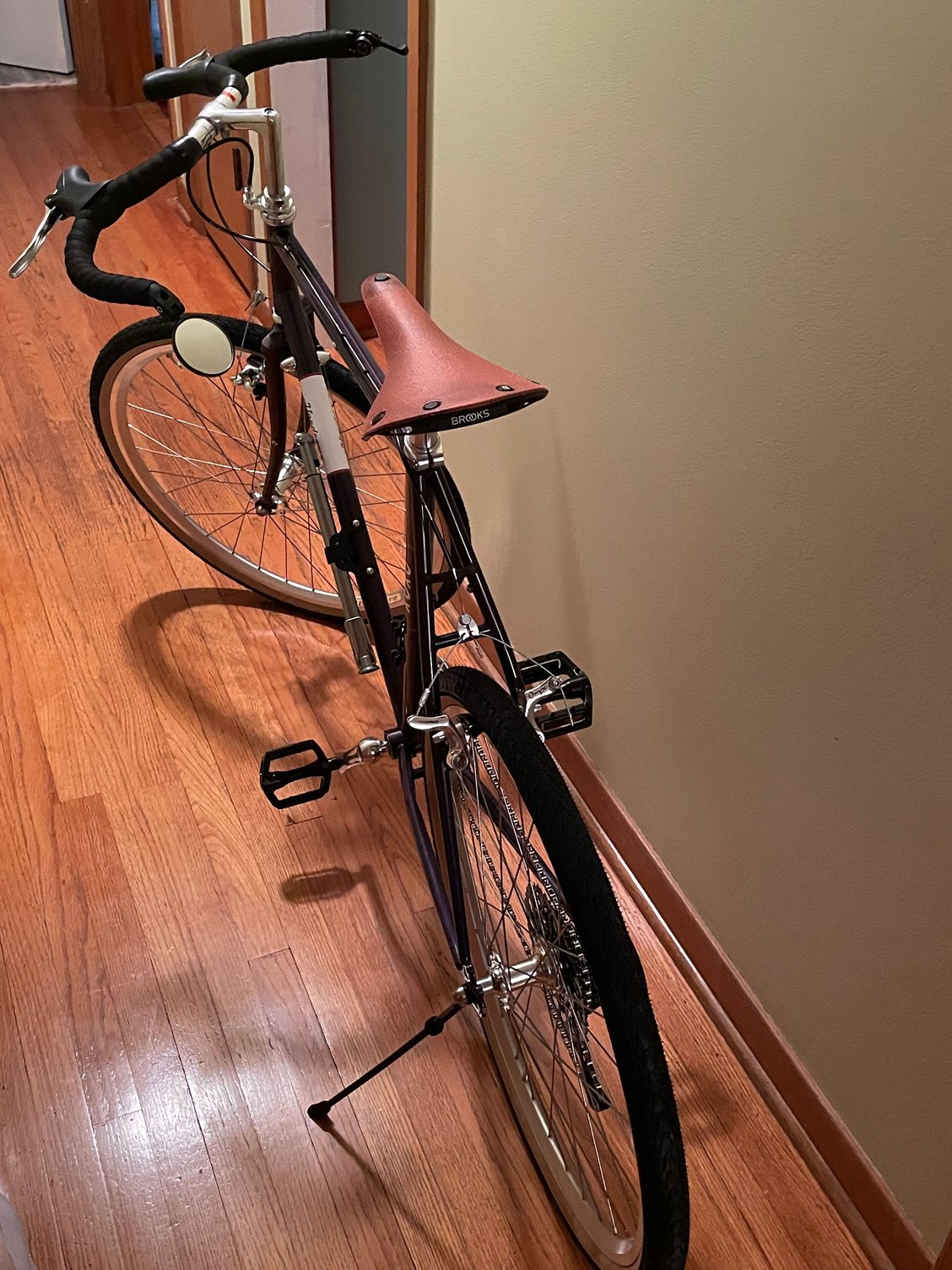

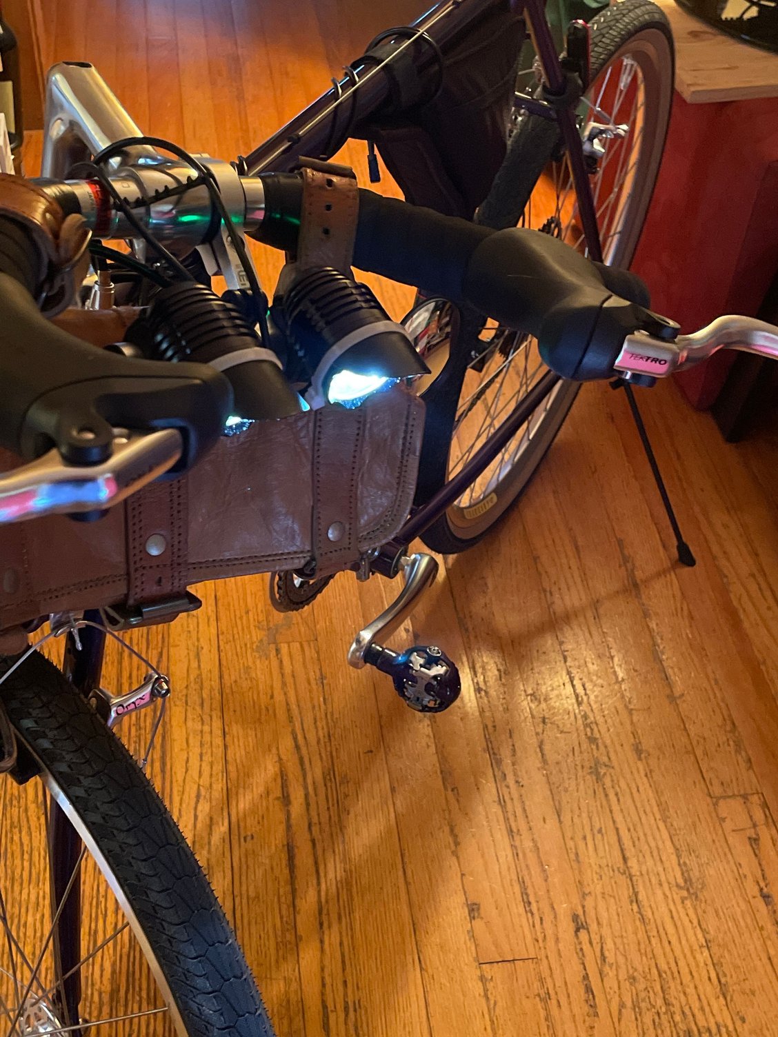

Laid up…
But here are a few pics to tide us over. Back by spring, this one hopes.

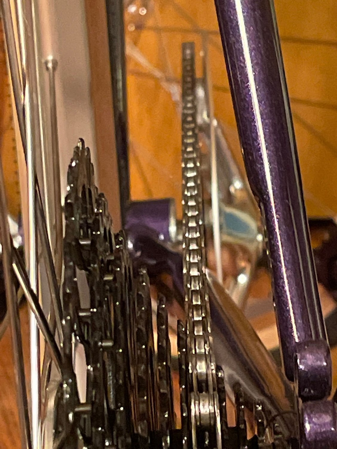

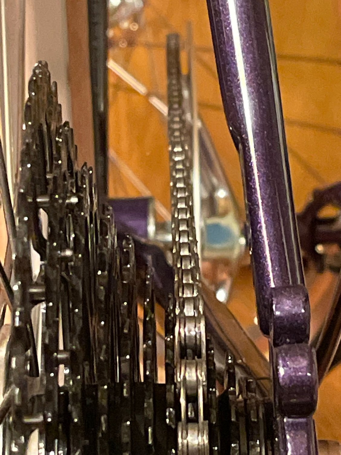

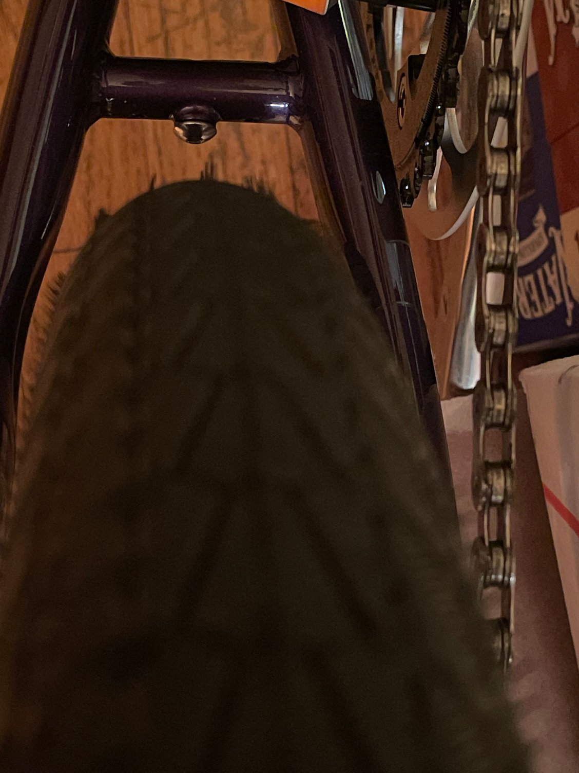

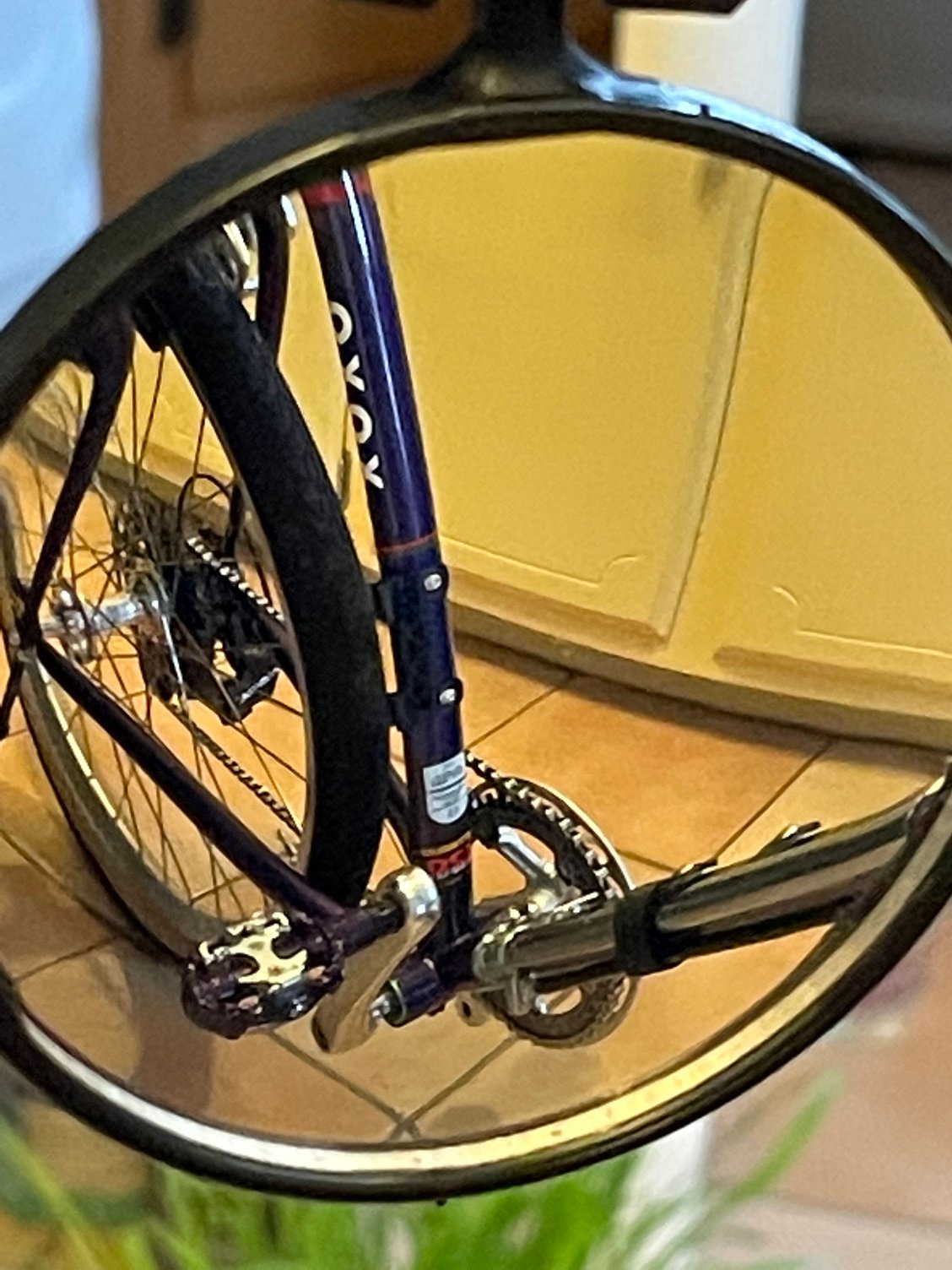

looks good. how does the bar end mirror work for you? Also is your rear wheel perfectly centered between the chainstays? ie is the rim exactly the same distance from the stays on each side?

A few more with added doo-dads.

Originally Posted by jadmt;[url=tel:22732489
22732489]looks good. how does the bar end mirror work for you? Also is your rear wheel perfectly centered between the chainstays? ie is the rim exactly the same distance from the stays on each side?
Thank you! The mirror works for me. Riding a Paso sort of has a similar position. I placed mirrors below the bars on a can-am I streeted as well.
First glance, a lot of people had wondered then also, if I could see out of it them mounted so low.
Fortunately, my wheel is and has stayed centered but I’ve only 20 or so miles on it so far.
(photo assist by my lovely wife)

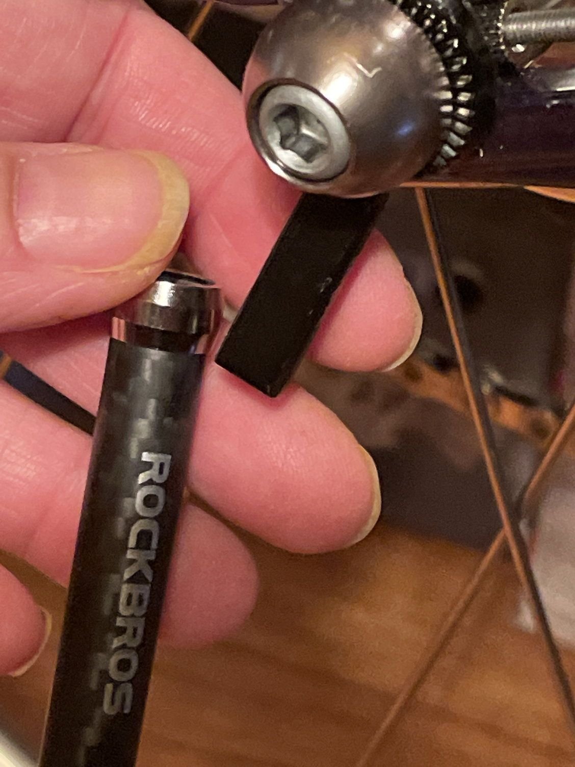

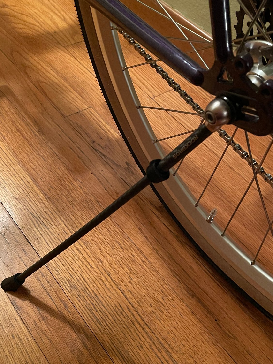

I went to these hex head skewers. The kickstand tab stays on the bike between frame and skewer end cap. It shifted once and the wheel went left in front a tad but that has been corrected, the stand dialed in, and a little more torque added. Nothing shifted in my low side fall.

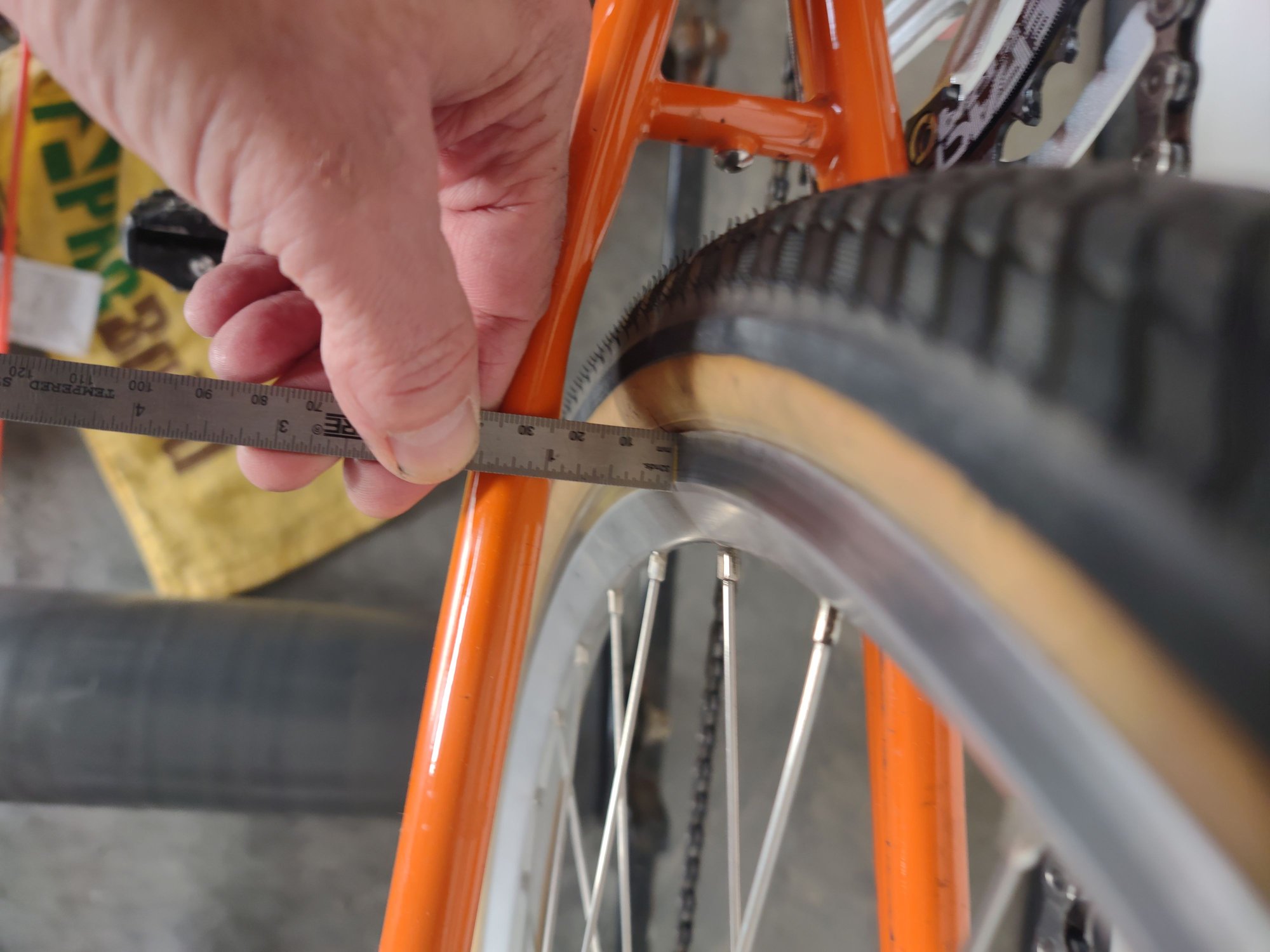

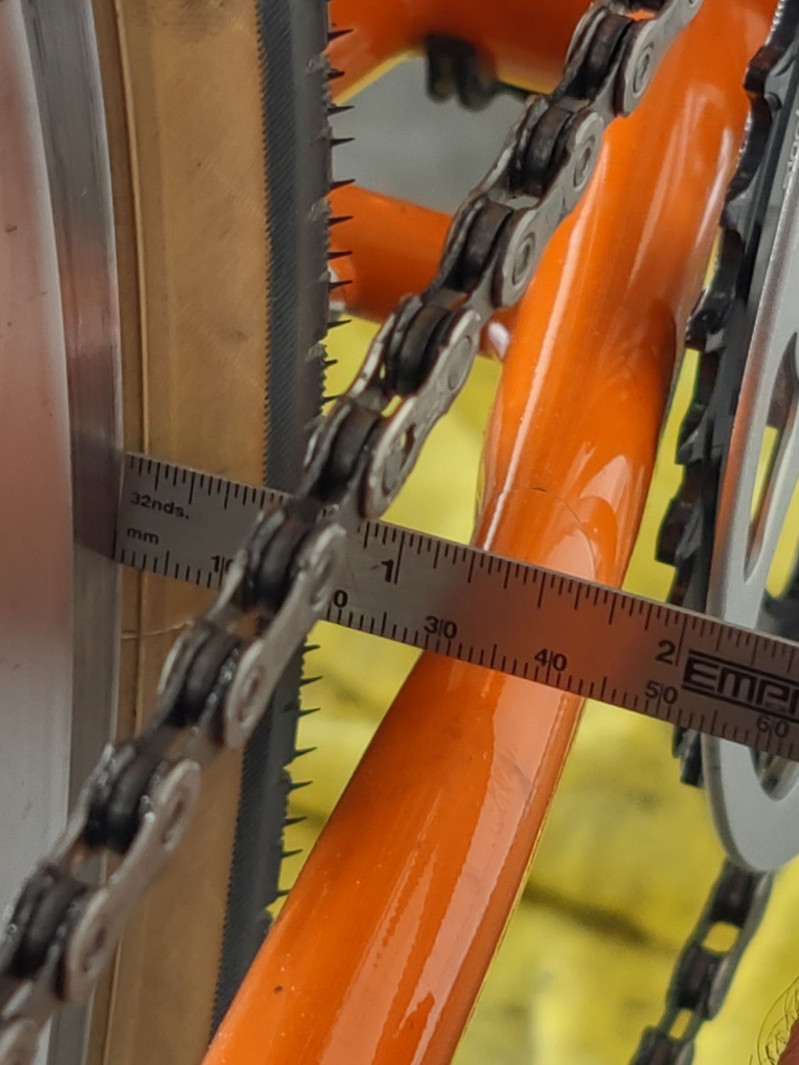

So I don't mean shifting in the drop outs I mean here? what are these measurements on your bike? thanks.

Sorry, pictures are difficult to show the actual angles or distances, but I’m glad to help. I hope the pics help some. I show the right stay to brake surface as .980”
I show left stay to brake surface as .880”
There is a one-hundred thousandths difference.
If this helps any, my chain line seems
straightest between fourth gear and fifth gear. There is a slight cant to the right at the rear in four
A sight left cant in fifth.
4th
5th
While the wheel shows a bit of left offset by stay to rim measurements where you indicated, I don’t know that it’s not proper, in order to account for the gear cluster and wheel dish or tire to chain clearance. On mine it doesn’t seem to mess with the actual tread being centered.
Eyeing this up now, I wonder if the wider rtp might rub chain in 11.I haven’t looked down at chain alignment while riding yet. I’ll get this on the stand after a follow up and doctors approval to be more active.
These rear alignment issues, and wheel building aren’t areas that I have had to delve into before, but I am eager and willing.
Judging by the tire alone, the center of tread still seems to align with the center of the seat post, the bolt in the chain stay brace, the center of the bolt in the seat stay cross brace/brake hanger, the brake cable housing stop/hanger and the center of roller hanger on the straddle cable.
How large of a difference have you noticed? Iirc you had one set of wheels redone? Do you still have a greater offset than the .100” I’m seeing, or thereabouts?
Seems centered to frame center.

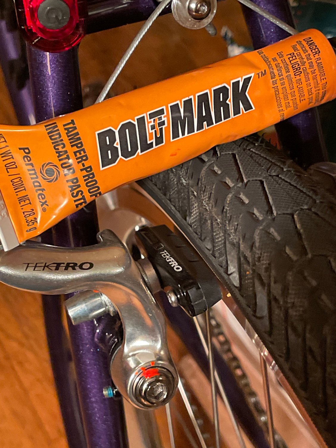

I’m using a tamper marker for two reasons: To show what I’ve gone over so far To monitor for any loosening or shifting.
When more mobile, I’ll check the seat stay distances to rim. What I may be picking up is .050” difference in the cross sections/widths of the two chain stays…the chain sode being seemingly a touch flatter inboard. So take that into account as part of the 1/10” diff here, perhaps.
