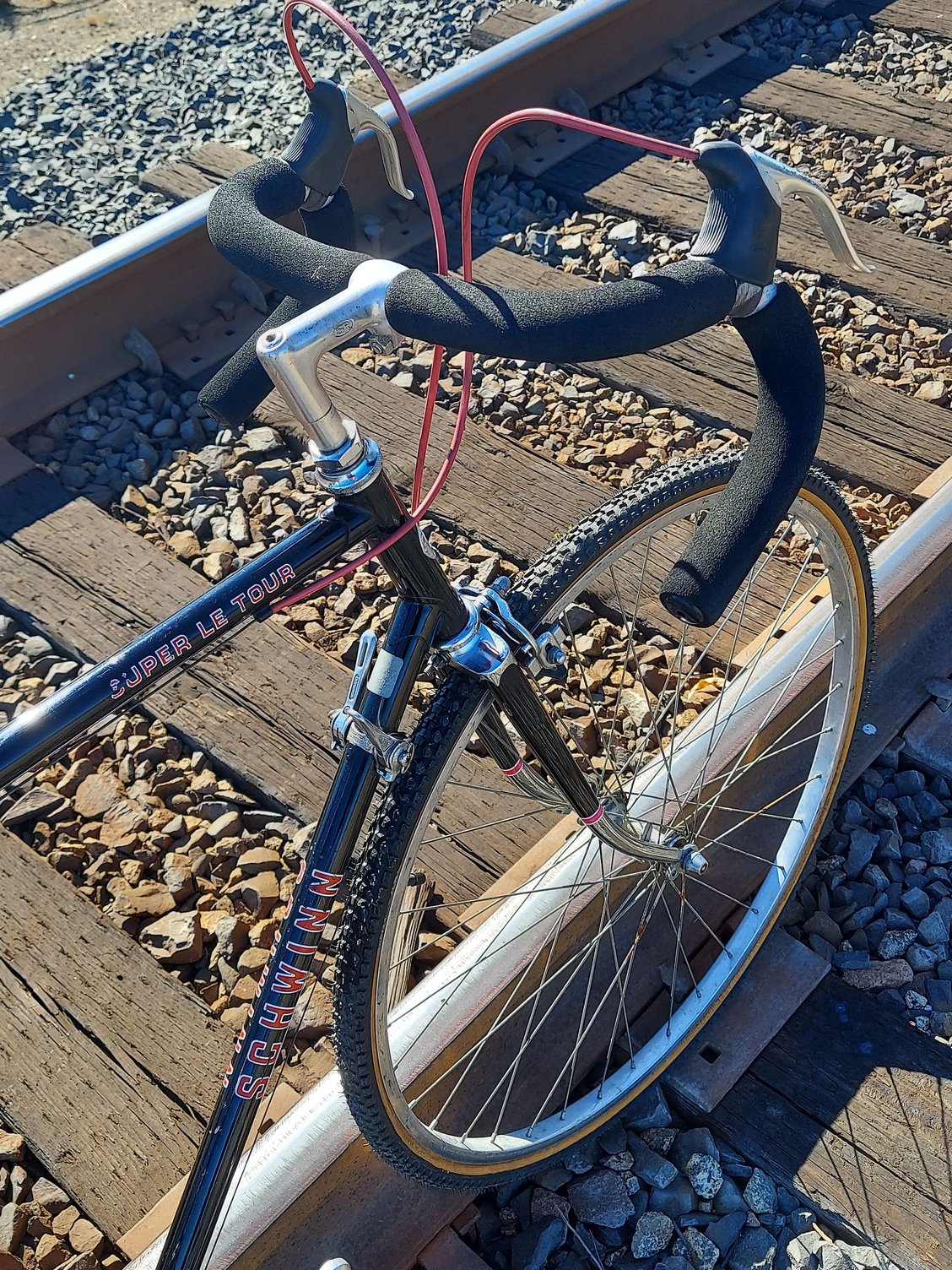

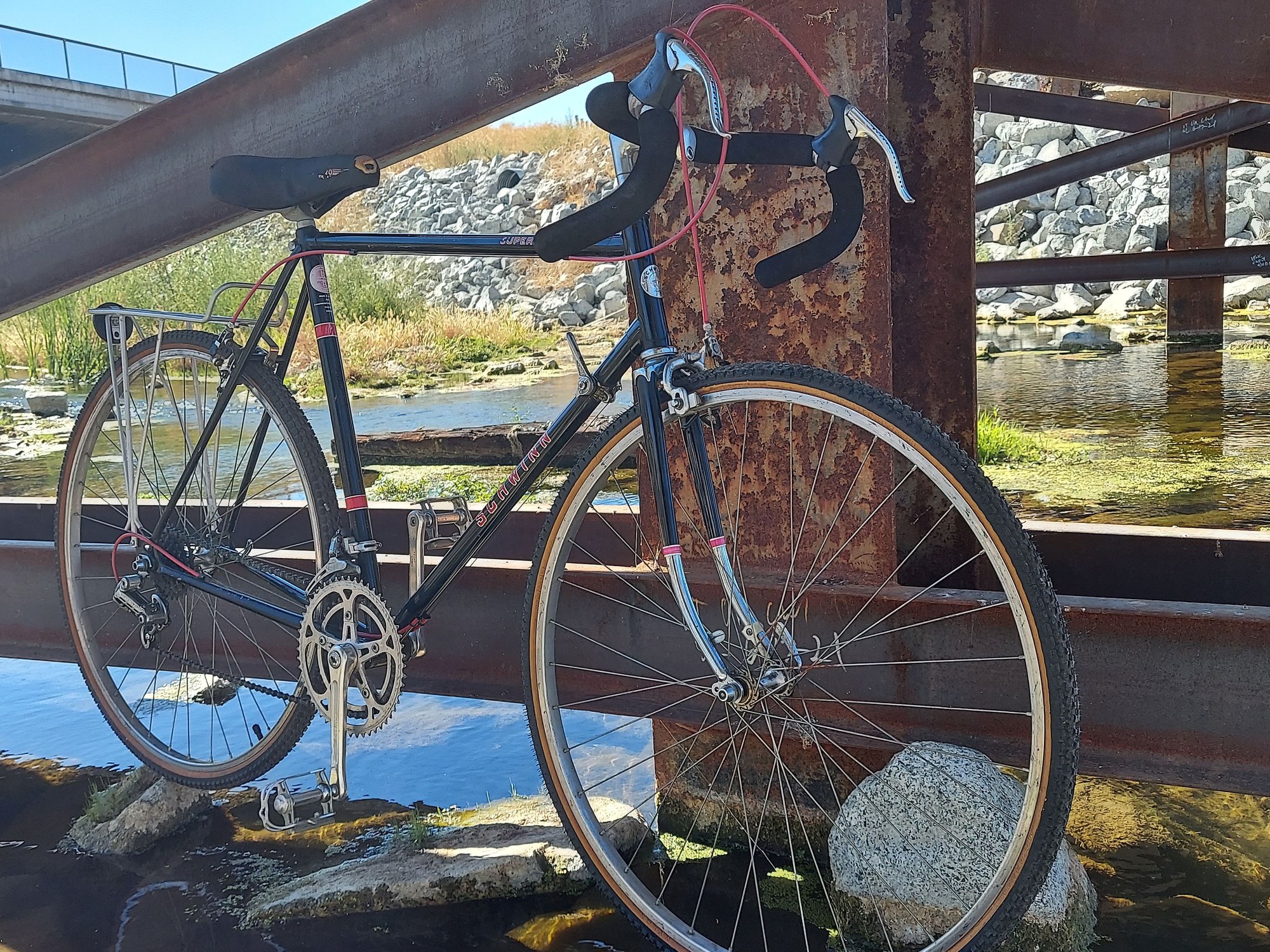

I really like my Swift Tire "Sand Canyon" tires, 27" x 1 3/8"
Cambodia bikes, 83 Gazelle Opafiets, A Klunker, Maxwell All-road, Bridgestone SRAM 2 speed, 2012 Fuji Stratos.
