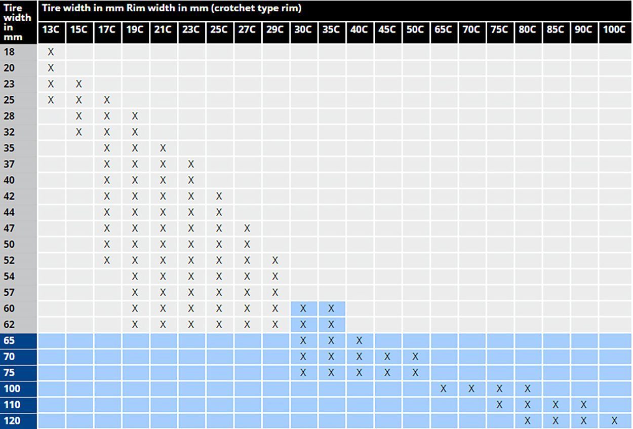

yep, 20 is pretty standard for that tire size. ETRTO standard lists it from 17 to 23. I've run it from 20 to 29 internal.
For reference, you can always search for the standard: etrto tire chart
