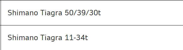

I am eagerly awaiting my new Performer JC-70 in sunrise orange metallic to ship from Taiwan, and I tested some other more expensive models from Ice and Catrike before deciding on Performer for a price vs equipment perspective. The performer is untested for me so hopefully it isn't too different from the ones I liked. I plan to post a nice introductory thread regarding assembly and my thoughts if anyone is interested. I decided on a trike at age 30 simply for comfort, fun, and the ability to go more than 2-4 hours without a numb lower half and sore back muscles and wrists. I have no health issues or physical shortcomings, just wanted to mention that so I can squash some of the stigma around the trike rider profile (you wouldn't or maybe would believe just how many people will ask me why I ordered a trike when I have bikes and I'm not old or disabled).
The Performer comes standard with a nice gearing range, or so I believe, for the type of travels I expect to go on with it. It has a 11-32 10 speed cassette and 30/39/50 chainring with Tiagra derailleurs. I am much more interested in properly-paced long distance adventuring over trying to beat my DF lap times for my typical routes so I am happy with the lower range between the first 2 front rings, and will likely never go into the third. New York is very hilly anyway. What I would like some feedback on is whether or not I should consider a Rohloff 14 speed hub over the cassette eventually (assuming I can even swap the components on this trike like that) in order to be able to fill in some gaps in between sprockets and gain more range and to gain the durability of the hub, or if I would be wasting my time and money to not notice a difference.
Does anyone have some input on the benefits of the internal hubs over a typical cassette other than the obvious "it's sealed and more durable" argument, which is strong already? I have never used an internal hub before, but many people who tour swear by them. Trying to do the swap seems daunting and it is incredibly expensive, but I plan to ride this trike until the welds on the frame break or my internal welds do.

There is something to be said for the simple 3X10 gearing already on your trike. You can get parts at most bike shops and if you need service they can do it. When you get into hubs like the ones I have used in the past (SRAM dual-drive and Schlumpf Mountain Drive) that gets a lot more iffy. Nobody that I could find in Las Vegas with a population of just under 2M is experienced in their repair. I had to do it myself.
You can use a gear range calculator to compare the range for any combination of gears. I like either Sheldon Brown or Mike Sherman's calculators. Your new trike has a gear range of 25.5 to 123.5. That's a little narrower than my Catrike 700 with a gear range of 20.9 to 124.2 using the same calculator. I ride mostly in the middle range and almost never use the lowest gears on the trike.
If you look up the current cost for just the hub unit for the Rohloff 14 speed it costs right around $1,500 to 1,600 depending on the source. Then you need to add to cost of rebuilding the rear wheel with new spokes. Add it up and you have darn near doubled the cost of the trike. Most new riders have a hard time with the hills until they develop the muscles needed to propel a trike. It's somewhat different from what you use on a DF bike. Give it a chance and you may save a bundle.

I agree with nearly all of post #2. I have a Performer from 2017 and the 10sp is 11-36! A 10sp 11-32 seems awfully ... close, but I don't claim to know it all. Still, the first thing I did to that BIKE was swap out the 30T granny for a 24T. Yah, a gear range starting around 16" and I don't find that impossibly low on a bike. There are trikes out there with low ends in the single digit gear inches. A 30 year old may not be ready for that quite yet but I would keep the knowledge tucked away, 60 comes up awfully fast when you are having as much fun as you will be having. A Rohloff on a Performer is kind of like a Bosch aftermarket fuel injection racing unit on Hyundai Econo-sedan. You saved a bundle (well played) buying that trike instead of an ICE or Cattrike so why would you even consider for a second blowing those savings on a $1500+ rear hub with only a ~535% overall gear range?
I will admit, I honestly have no idea how to make sense of ratios and charts. Inches, for example, is so confusing to me. The reason why I am considering the hub is because I plan to do trikepacking and long distance day rides with this trike and I am a firm believer that the only things that make more expensive bikes worth the money are the components and frame technology when you get into carbon setups or titanium where welds are critical. An aluminum tube frame on a trike is very basic, and most frames are going to be welded and butted properly from the beginning so frame to frame, brands can be very competitive, yet cheaper trikes like Performer's will sacrifice their base shiftsets and brakes, etc, but with upgrades a Performer frame can be just as viable as a Catrike or Ice. Because of this theory, I don't mind spending money on worthwhile uprades. Much like a $25k Jeep Wrangler can be upgraded to be better offroad than an $85k Toyota Land Cruiser with the right parts. a $2k Performer trike and a $3k Catrike both roll off the line sans internal hub. I have been assuming, based on video research and vlogger posts, that the internal hubs are a necessary upgrade for the sake of long term durability. Derailleurs break and fail much more often and are exposed to the elements and road grit, etc, so they, while more easily obtained, will fail far more often, and realistically give you less range than a hub. The range I envision likely doesn't give me any benefit, I just did the guesswork math and assumed it would. The closer ratios you can get, the easier your cadence can be managed while loaded down with gear.
I appreciate the responses, I am literally clueless about ranges and trike muscle use, etc. Forgive my lack of understanding of some of your points you made.

Also just to clarify, I misspoke, it has an 11-34 cassette according to lightfoot bicycles. They are the only website that shows the supposed specs for the Tiagra upgrade. ​​​​​​​

The concept of gear inches for a gear range is it allows you to easily compare bikes with different sized wheels. My first trike had a 20 inch drive wheel and 3X9 drive train. The gear range was 19 to 98. My second trike with internal hubs and still a 20" drive wheel had a gear range of 14 to 128 gear inches while my Catrike 700 with a 700C rear wheel is 20.0 to 124.2 GI. It's pretty easy to understand which trike had the lowest low and the highest high gear and how they compare.
I own one of the best trikes ever designed specifically for touring, a 2001 Greenspeed GTO. It came equipped with a single 65 tooth chainring, Schlumpf Mountain Drive (front internal 2-speed hub), and 3X8 SACHS Spectro 7 in the rear. That gave it the extraordinary wide gear range. It has Hope C2 hydraulic disc brakes for super stopping power, The frame is steel and the total weight is 39 pounds. The trike has more than 30,000 miles on it and I am the third owner. In those 30K miles the rear derailleur (Shimano 105) had to be replaced once. It didn't break but simply wore out from too many miles. The GTO has been out of production for more than a decade but they show up used on occasion, I paid $2,400 for it back in 2004 and it came with hundreds of dollars in touring accessories. I consider it a bargain purchase.
I'm pretty sure I used 11/34 for the cassette when entering the data in Sheldon Brown's gear calculator. I got the numbers off the Performer website.
