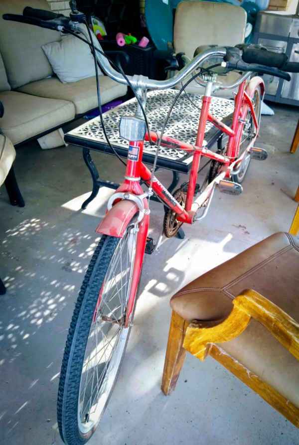

Here is our old girl, also in purple, from 1993.
I love these old steel bikes, though they are heavy. A lot of character and lot of fun.
Love to see pictures of your completed refurb.

I'm building my first tandem now, with a very similar color scheme. It's a Meridian, said to be (said by the seller) one of their last ones, and it has a very similar layout to this Santana, except for a taller rear seat tube. In addition the color is very close, and the decal size and placement are about the same. And both have 700c wheels.
Here's a picture of mine:
W
Thanks! The arms are an upper end Sugino with that original fine brushed finish shared with some Campy and with TA. The rear rings are a matched set of Race Face, with their finishes in polished and brushed.
