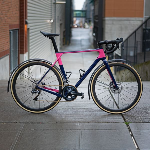

if it werent for the brakes that it has, I'd inquire more of that bicycle.

OP:
Would the bicycle that you posted a picture of happen to come equipped with hydraulic disc brakes?

Building the Bikes
Assembly was pretty easy. The 2 biggest concerns I had with Chinese bikes were poorly made press-fit bottom brackets and seat post sliding.
I wanted BSA bottom brackets as those are easier to manufacture and are therefore less likely to cause issues later on. Unfortunately, very few bikes I found had BSA. Press-fit bottom brackets are far more common. To account for possible press-fit bottom bracket issues, I used Token Ninja bottom brackets. For those unfamiliar, the Token Ninja is a bottom brack that comes in two pieces and threads together inside press-fit frames. You don't need any bearing presses and the fact that the two sides of the bottom bracket are connected with threads helps cover up minor alignment issues. The fact that it doesn't need a bearing press also makes it easier to remove and install again for internal cable maintenance. The other concern with cheap press-fit frames is bottom bracket creaking. To prevent that, I used Wako BPR V160 brake protector grease. This is very thick and tackey grease from Japan. I put it on the cups of each half of the Token Ninja where it interacts with the frame. Without precise measuring tools, it's really hard to evaluate bottom bracket roundness and alignment. But all three bikes did very well with the unscientific "spin" test with one of them doing far better than my Canyon and Specialized. The other 2 were on par with my name-brand bikes. Also, 2 have about 400 miles each and have no creaking, but I won't really know if I'm creak-free until a put a thousand or so miles on them.
The seat post issue seems to be pretty common on Chinese carbon bikes. 2 of my frames had no issue at all, but 1 frame did. When I did a seated effort of 500 watts or more, the seat post would slide down about 1/2 inch. The solution was simply some carbon assembly compound. A bit of that on the seat tube eliminated that problem.
Possible future issues
The only other concern I am aware of is with the wheelsets. Some people say Chinese wheels go out of true much faster. So far, they are fine, but I will keep an eye on it. Part of me is a little excited as truing wheels is the last thing I need to master in my bike maintenance journey.
