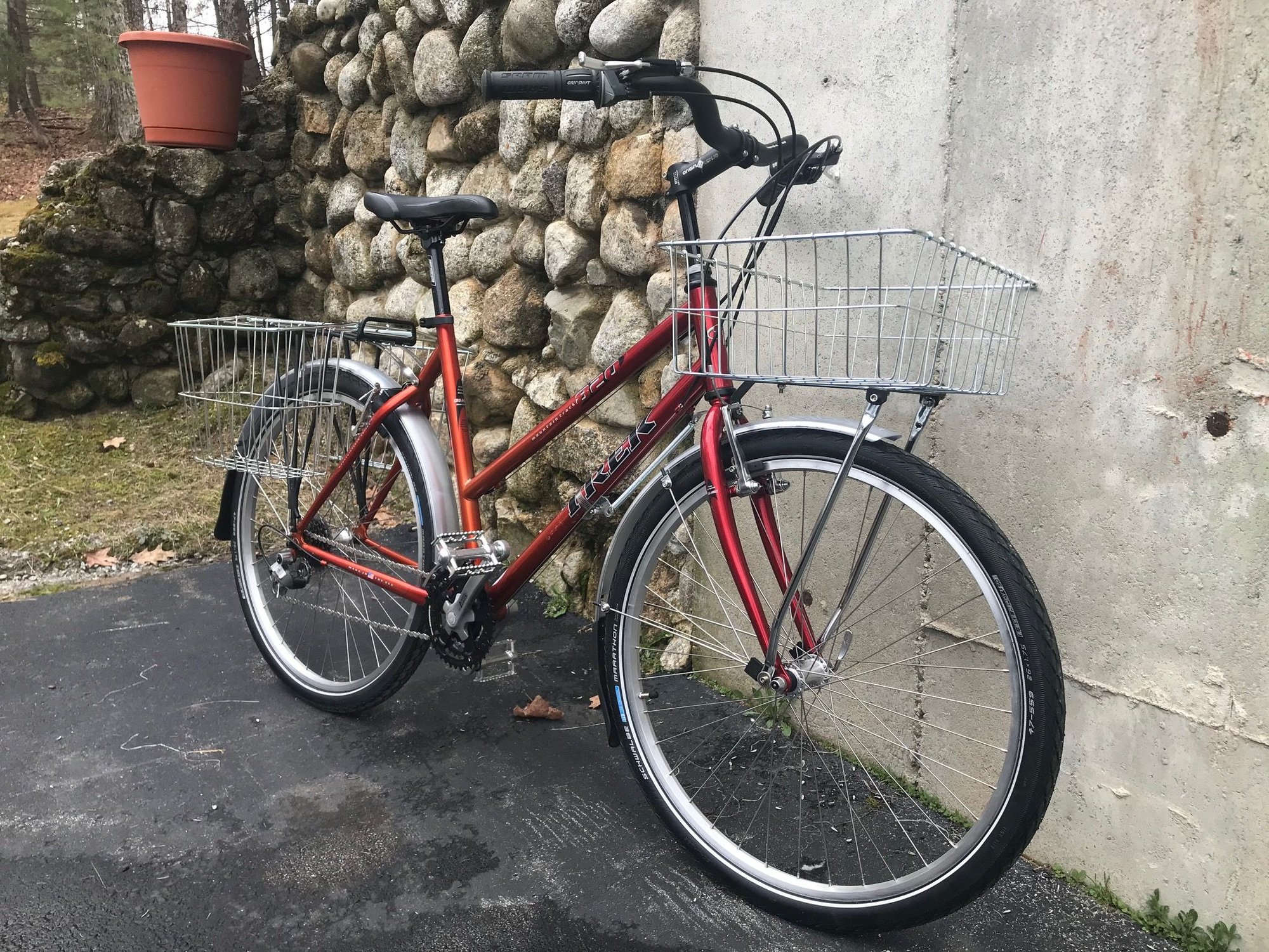

I am friendly with the guys at our town recycling center. They work for the town, and I also do some favors for the town road crew, who is also in charge of setting out the floats and rafts at the town beach every year. They know I'm a diver, and if anything gets dropped and they can't get it with a grappling hook, they'll ring me up and I go get it for them. Its a symbiotic relationship, because I also look after their kids' bikes and so forth and so on. When a decent bike shows up at the recycling center, they'll set it aside for me. Such was the case for this 820, which I've decided to remake into a sweet little ride-into-town-bike. What I've done is to take two Wald baskets, dremel off the extra bits, and make some of my own bits that make the racks ride lower and even save some weight. The front rack especially is cute.
Here it is mocked up. Don't mind my sloppy paint job with the huge drips. Its actually spray bedliner. The struts are actually from another front rack that was so wicked heavy! I kept the struts and tossed the rack. The black part, which I made from 1" x 1/8" steel bar stock, fits the front basket nicely and is perfectly level. I'm still waiting on a set of tires and tubes.
With this setup, the front basket sits so much lower than the stock Wald configuration, plus I will bet I carved at least a pound off it by doing this.
The rear is an old Blackburn rack with the Wald baskets fitted to it. I trimmed off all of the extra bits and bobs - again, saving some weight. I'll probably use some form of U-bolt to secure the Wald baskets to the Blackburn rack.
I have a nice set of fenders to add to this bike. I like the two bars at the rear end of the Wald rack. Might be a nice spot to attach a taillight or at least a big reflector? So stay tuned. I'll show more pics as I continue with this build!

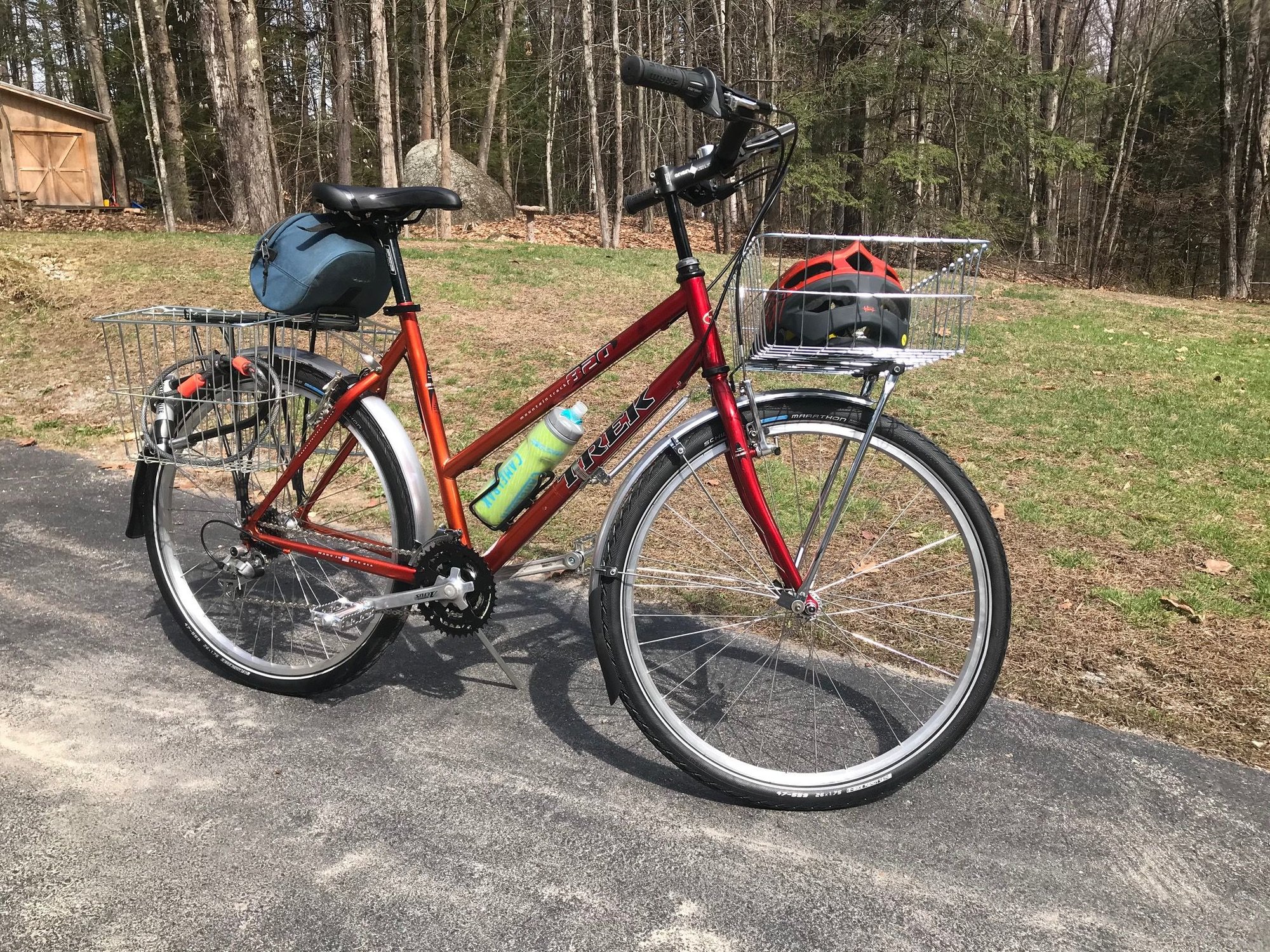

A few more pics. I wanted to get a couple more pics for the build process, but I didn't think anyone would be interesting to watch tires going on and all that. The key elements to this build are the adaptations to the basket mounting, and the DIY steering stabilizer.
Here it is in all its glory. Schwalbe tires, Continental tubes (I like 'em better), and new cables all around. New SRAM shifters too - exact replacements (3x7). I got lucky!
The bike handles very well, even with the baskets mounted. I especially like how the front basket sits way lower than the stock Wald configuration. The steering stabilizer is made up of a hardware store extension spring and pieces of the rack hardware that I cut off. After a bit of use, I can definitely tell that the spring needs to be a little more stout. Perhaps one with a bit more tension, and a lot less length.
This is the basic configuration of the spring. It provides some measure of steering stiffness, but its not enough to prevent the front wheel from flopping over when the bike is at rest. No biggie. I have a whole drawer full of springs with which to experiment.
The rear baskets, mounted to the Blackburn rack is very solid. This bike - so far - makes not a single rattle when riding. I've got the basket temporarily secured with 5 zip ties. I may have to make a couple proprietary clamps of my own design to hold these two racks together.
So far a decent ride. I pay ride it to the supermarket this week, and see how it handles the task. I still need to add a seat bag, a bottle cage, a kickstand, and a handlebar mount for my GPS. I hate these particular Planet Bike fenders, so they'll be on my list for an upgrade soon. I got them on okay, and they are as straight as I can get them, but ultimately they are cheap plastic. I've had a couple bikes with the planet Bike aluminium mudguards, and those are quite nice.
I'll report back when I do a grocery trip!
