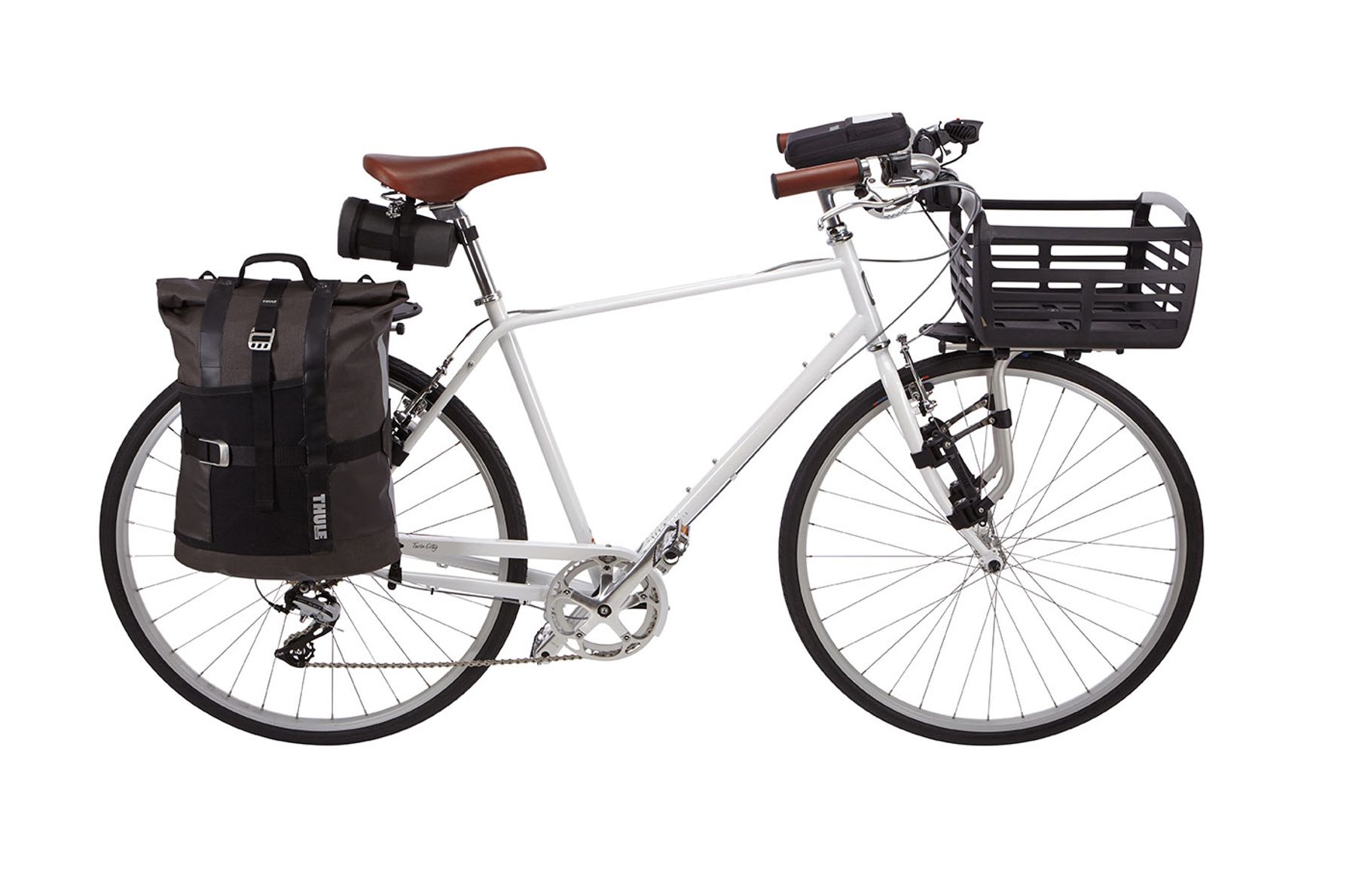

Thule's $$$ pannier rack mounts front and back entirely with straps only, no eyelet bosses. One of my bikes uses an axiom rack in the back fastened to bosses, the thule went on the front because of lack of bosses.
One really needs to forget about the $25, thinking you can do all this on the cheap.
Hauling on bikes is one of those things that makes cycling even more awesome, allowing you to do things not possible otherwise (like camping), making it worth it to pay whatever it costs to get it.
