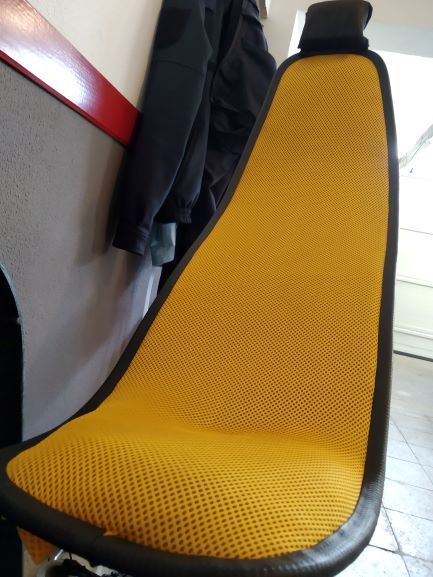

Hello recumbent users.
Greetings from Portugal.
Last year I purchased a used recumbent bike and entered the recumbent world.
I had to change the seat padding since it was not in the best condition.
I'm a DIY type of guy so I made the padding myself.
My seat is the recurved fiberglass type and I used a large piece of spaghetti vinyl loop mat, (since I have seen it before). I doubled it at the bottom for extra cushioning and covered it with a polyester mesh fabric (sandwich spacer cloth kind).
It ventilates, it drains, it protects my bottom... but in long distances (touring) I need something softer in my coccyx area. (I'm the thin type of guy and don't have much self-cushioning)
Did someone try the latex seat pads? (like the ones used in rowing machines)
Any other suggestions are appreciated

I don't know what "spaghetti vinyl loop" is, but is using two layers a possibility?
It is used as a door entrance matt. Here's a picture of it.
Yes it is a possibility, I'm using 2 layers in the problem area. I also cutted a V slot in one of the layers (like seen in other seats) to releife pressure on thah spot.

I'm glad I can post pictures now!!!
Here is it in the process of "fabrication"
Here it is possible to see the extra seat padding. double layer

If the tailbone area isn't structural, you could cut relief in the shell. Performer does this to their FRP seats, I believe.
That probably would be a good solution. A will see if possible.
Thanks for your input!
