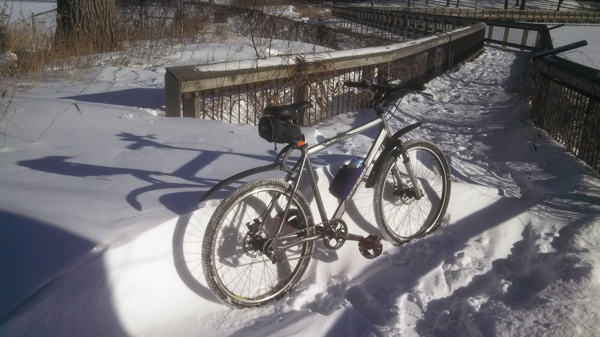

I've commuted via 26er and fat bike (ref pics below). IMHO, for your budget goals, an older 'beater' bike is your best bet and I suggest, focus MTB with on disc brakes and buy yourself high quality winter tires.
Fat bike tires without studs aren't any help with ice, but nice on fresh snow and old slush ... studded fat bike tires will easily kill your budget ($200+ per tire).
For durability, my Pugsley has been great. I've logged 8,000 miles since buying new during winter '14-'15. These miles include summer and winter. Most components are holding up well to challenging conditions I ride through.
Retired Marin Nail Trail 26er (frame cracked)
Pugsley (drop-bar conversion for gravel/endurance riding)
