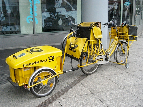

The stays on the Muse Cycles Mixte are reminiscent of those on the old Deutsche Post bikes, although that was one of the wackiest frame configurations you'll ever see (but wonderful!).
That Deutsche posit bike is pretty neat, a lot of stuff going on there. Probably would be electric nowadays.
